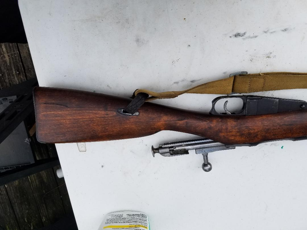

That Mosin is the Finnish M24 variant. Good rifle reworked by Finnish armorers, but not a M39.
