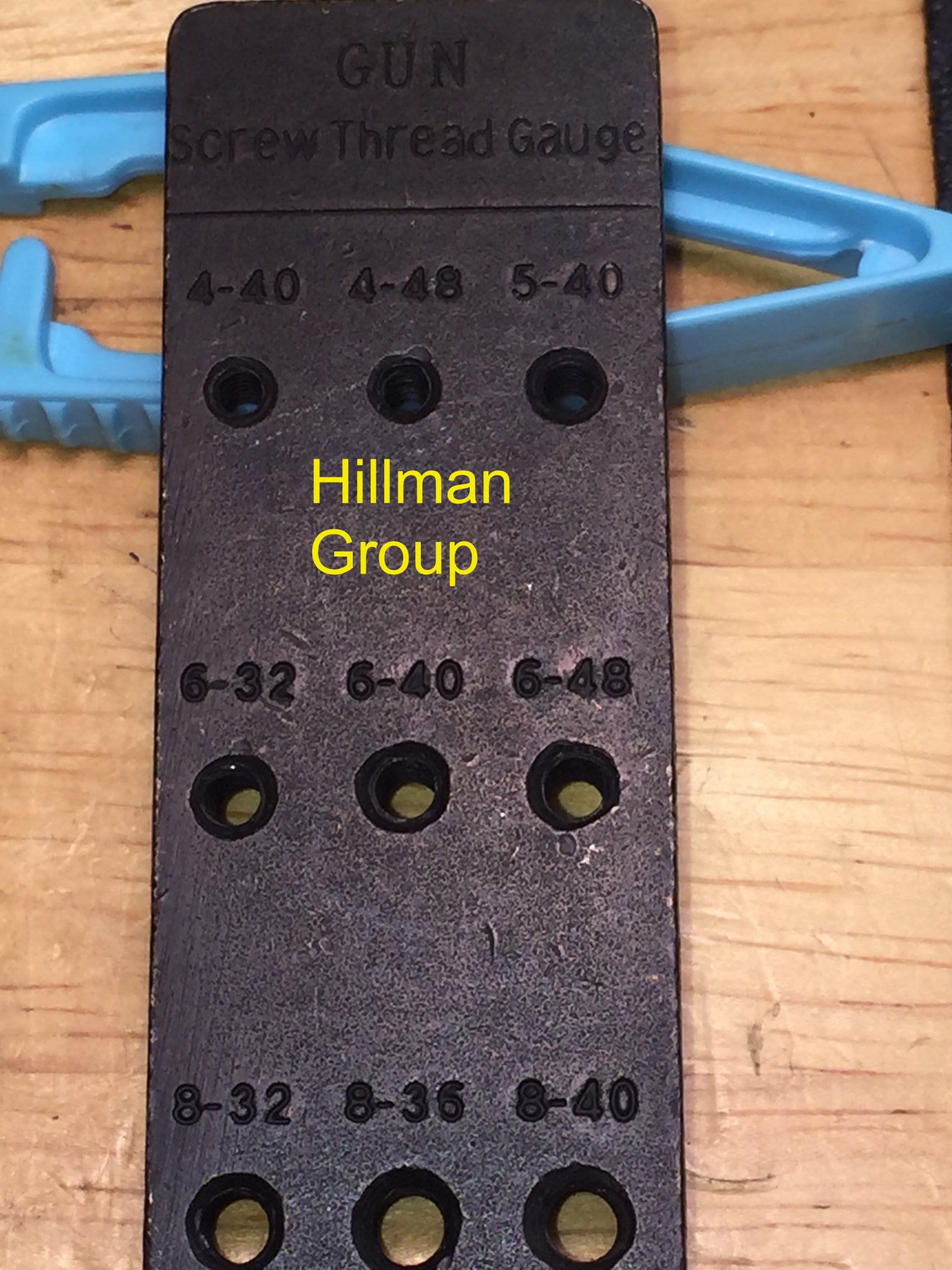

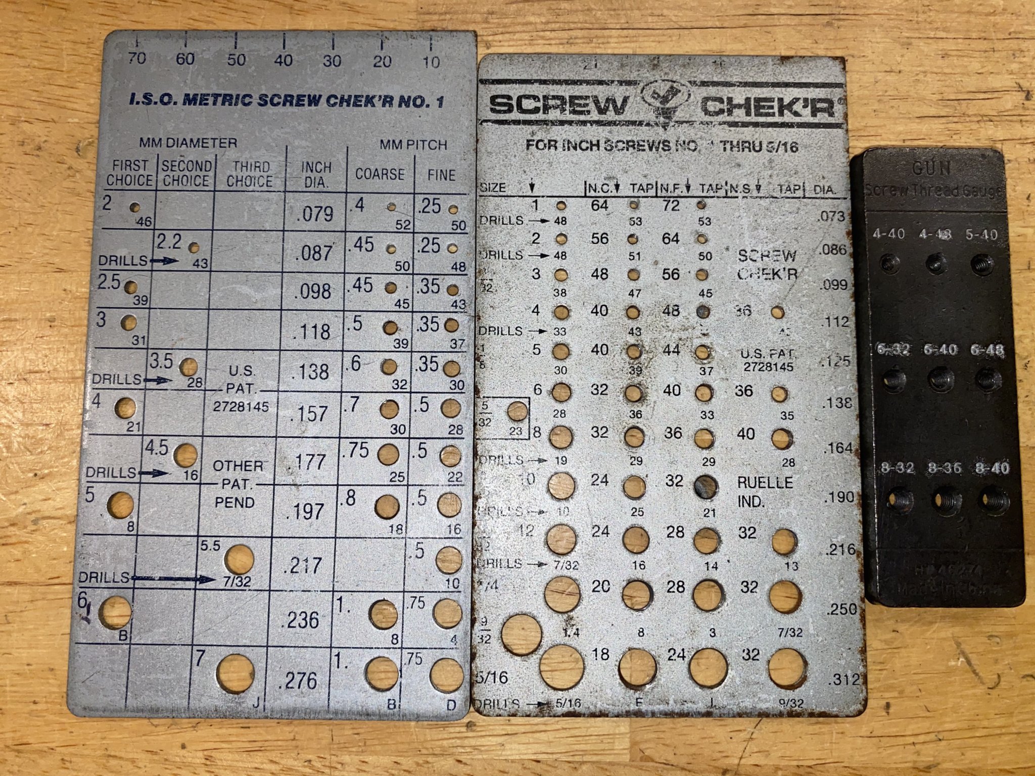

Speaking of Hillman, they have a nice gunsmith thread screw checker (for a few bucks ) that compliments the usual screw checkers that are pretty handy to have on the bench.

Speaking of Hillman, they have a nice gunsmith thread screw checker (for a few bucks ) that compliments the usual screw checkers that are pretty handy to have on the bench. View attachment 7623449View attachment 7623450
Perfect and thank u for the heads up and probably some headache. I always wondered what screw heads I should buy
