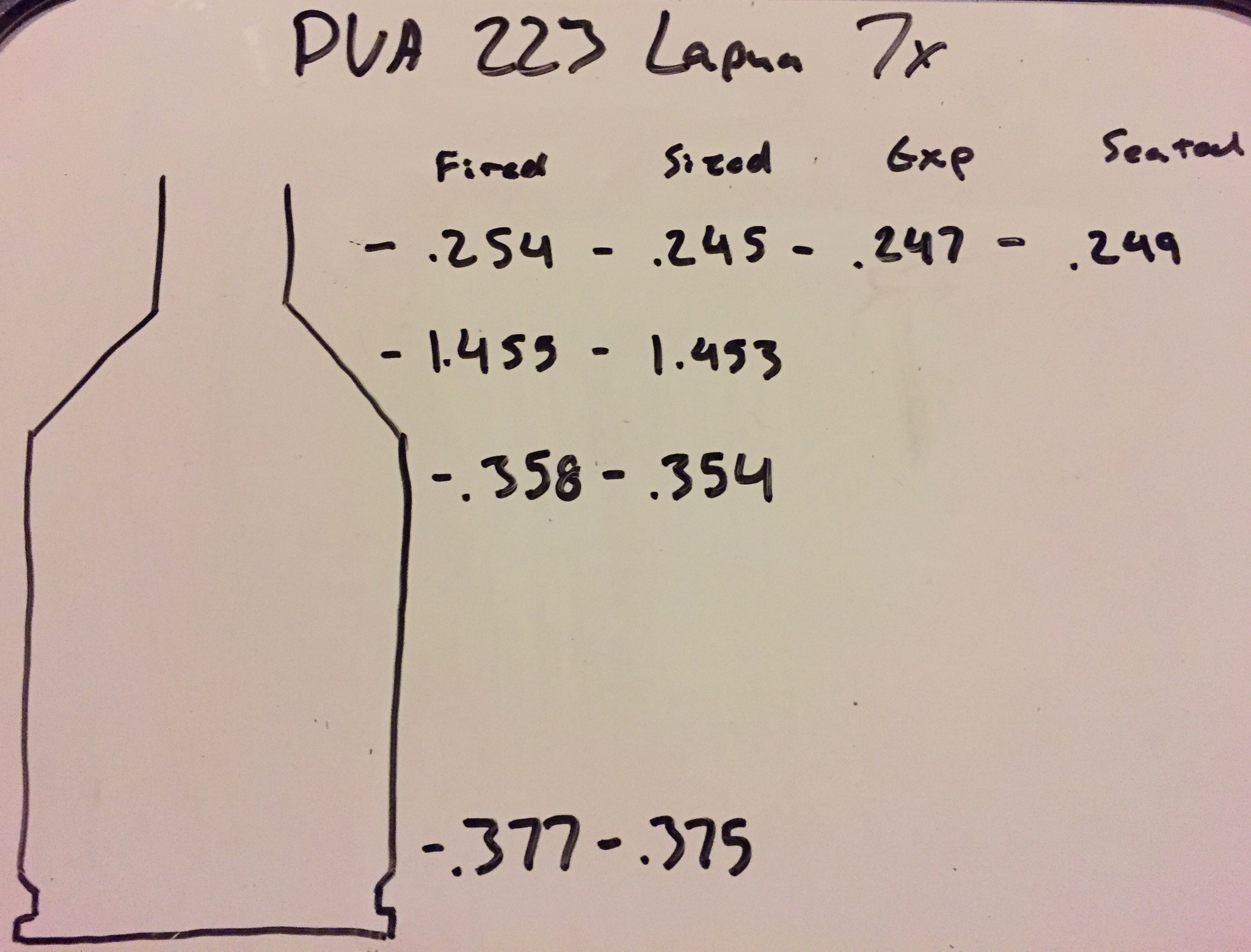

Take some spot measurements of the brass prior to fireforming and compare to after, and then sized. Especially take note of that area on the lower body

I was getting different length of brass depending on load I used to test. So I took 10 rounds and fired all at the same charge weight and took the average measurement of those and used that measurement to bump my shoulder back 2 thou. It seems to have worked itself out. Not exactly sure of the answer.
