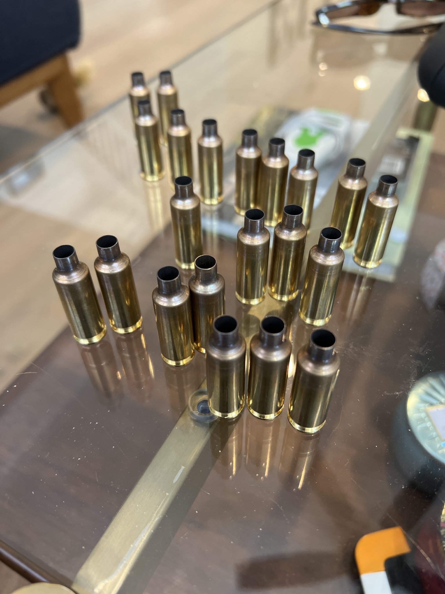

I’m also curious about this, I loaded up a batch of Lapua BR to fireform this weekend into Dasher using 30gr AA4064 vs. 28gr Varget as my Varget stash is running very thin.
Edit - AA4064 worked just fine, did 20 to measure blow length and came out all within ~1-1.5 thousandths. I’m using 108s since I don’t want to waste my Berger 105s but no false shoulder just jammed .030” into the lands.
"blow length"? Not familar with that term. Explain? Thanx.
When you form dasher from br brass the neck shoulder junction moves forward and the shoulder goes from 30 to 40 degrees so the shoulder “blows” forward on firing.
Length meaning a)where the shoulders measure and then b) the over all length meaning the shorter the neck length the less it stretched in the body.
