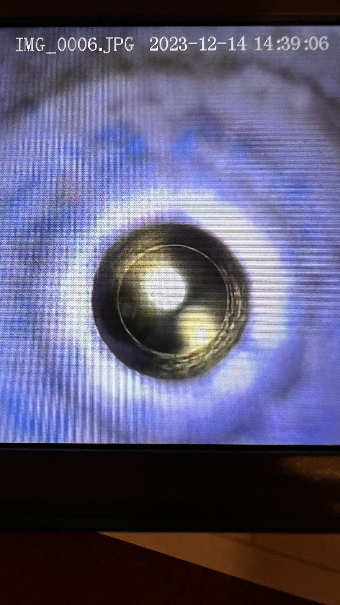

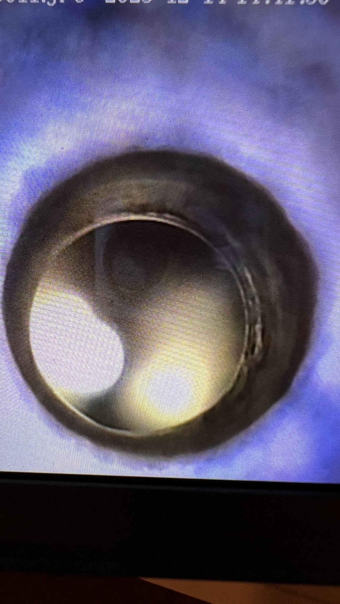

I unpacked the cheap borescope I just bought and snapped some pics. The burr in the firing pin hole was the correct diagnosis, I think. These are pics off of the borescope’s display, btw. Don’t feel like digging out my mini-sd card reader.
You might wonder how I took those pics. I was scratching my head too as to how to accomplish it. Maybe this will help someone later.
I laid the bolt on a table and took the mirror off the scope, then placed the scope on a rubberized pen. The scope is right in front of the FP hole where the bullet would be.
Then I used a low-power penlight to illuminate the FP hole from behind, through the bolt body. The light is not close to the hole, but is at the far end.
Thx @FisherT&C for the idea to look in the FP hole!
