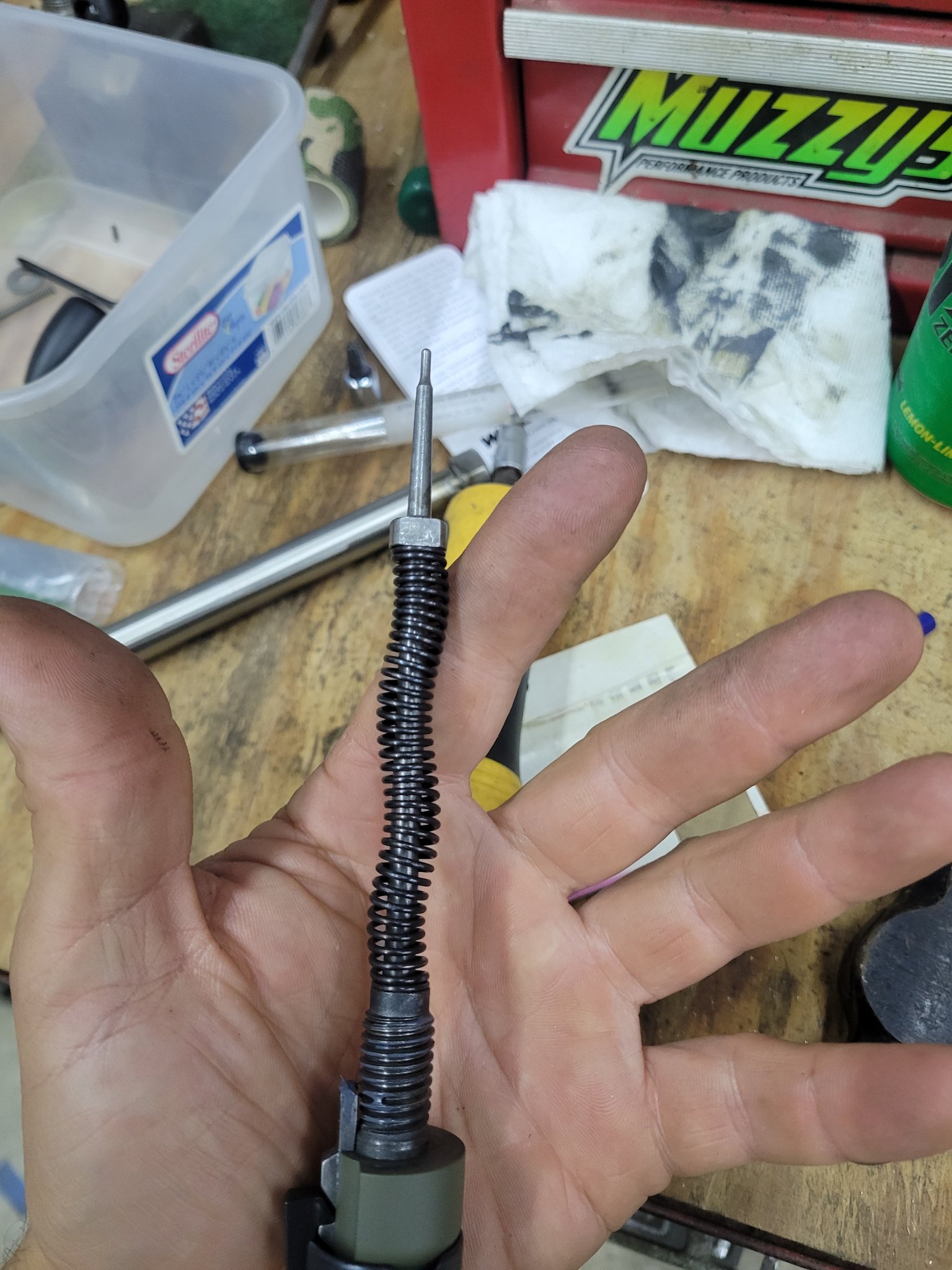

Need new springs for a few 700's. I ordered three new short action springs from gre-tan, advertised as 20-22lb springs. I'm trying to get rid of the coil bind that the stock spring has.
I've watched videos of guys replacing the springs and fixing this and most used gre-tan springs. So that's what I ordered. I think I've got more coil bind now than the stock spring.
Here's some pics. I didn't get a pic of the stock assembly.
Relaxed

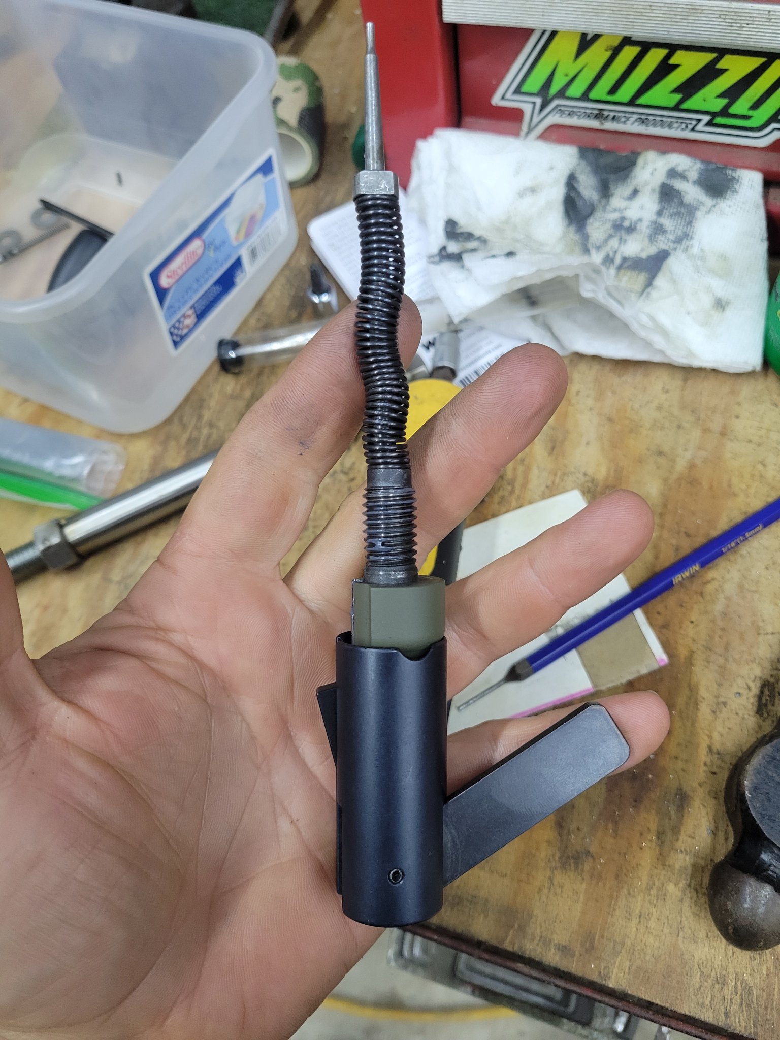

Compressed in the tool to be installed. You have to stuff it in the bolt. Doesn't seem right to me.
The wire gauge of the spring combined with the diameter of the firing pin allows the crooked coil stacking.
That lack of control on the spring allows it to drag really bad on the inside of the bolt body. That retards the spring energy and increases your lock time.

So I emailed gre-tan. Sent him the same pics I posted here. He said I have a j lock firing pin assembly and none of his parts are compatible.
There is no j lock on this rifle but when I disassembled the bolt it did have a large notch in the firing pin where the j lock would be.
10-4 thanks. How does it stack up when assembled, does it look like the pic I posted or is it pretty straight ?

My springs are not nearly as cocked up and don’t seem to rub bolt body.

I bought one of the first j lock guns and the spring was like yours. I cut a few coils out and it smoothed up. I did that 2 barrels ago and forgot till I saw this.
Well, I bought three short action springs for three bolts, and two I now know have j lock components in them. Still unsure about the third. So I guess I've got a couple to experiment with.
