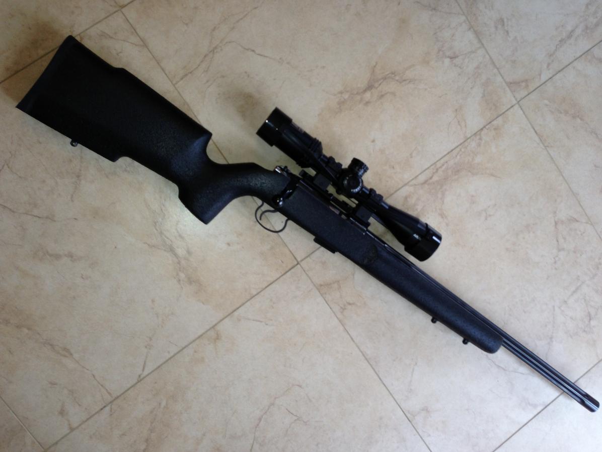

First off, Thank you SnakeEyes. Bought a CZ 455 swapped the Barrel to a CZ Bull and refinished a Boyds Tactical Stock(Otherwise known as the "TACTICOOL") and f**k do I hate that term. Stupid if you ask me why they would do that but for a $100 stock didn't bother me as much. I refinished it with a rough finish Mat Black. Put a very sweet Bushnell AR 4.5-18(very surprised at this scope) especially at $195. Yodave spring with a pull at around 1pound+/-. First time out last week the groups got tighter on their own with every round. Didn't have the Yodave or the Bushnell. Tweeked the inch/pounds on the screws holding the stock when I read the barrel should be free floating so I did the paper between the barrel/stock test. Should be much better this weekend. Again, Thanks for your input.

Your setup looks good! I have that same stock on a heavy barrel Ruger 10/22.
