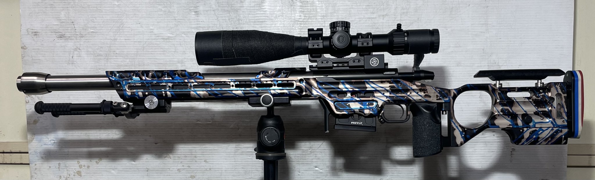

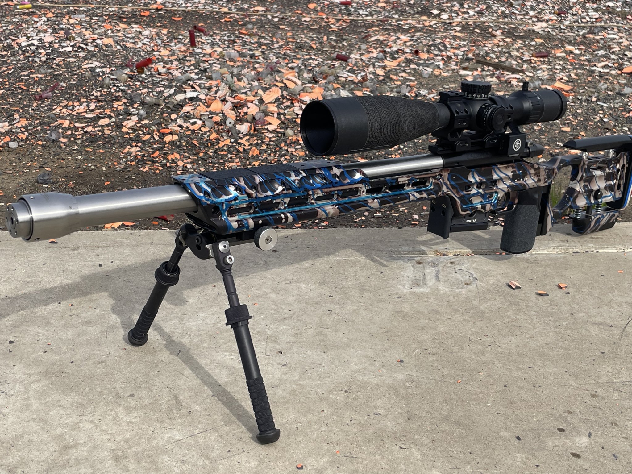

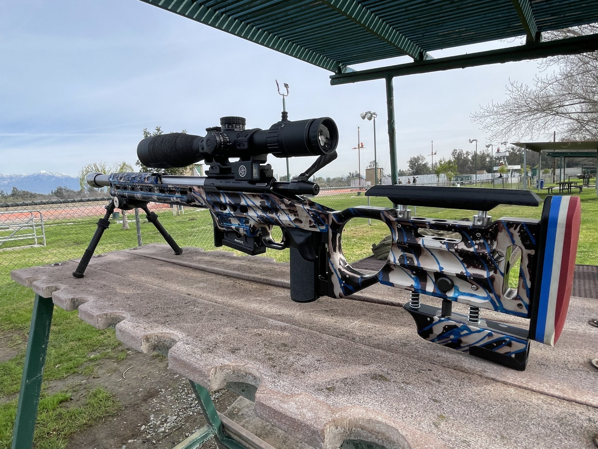

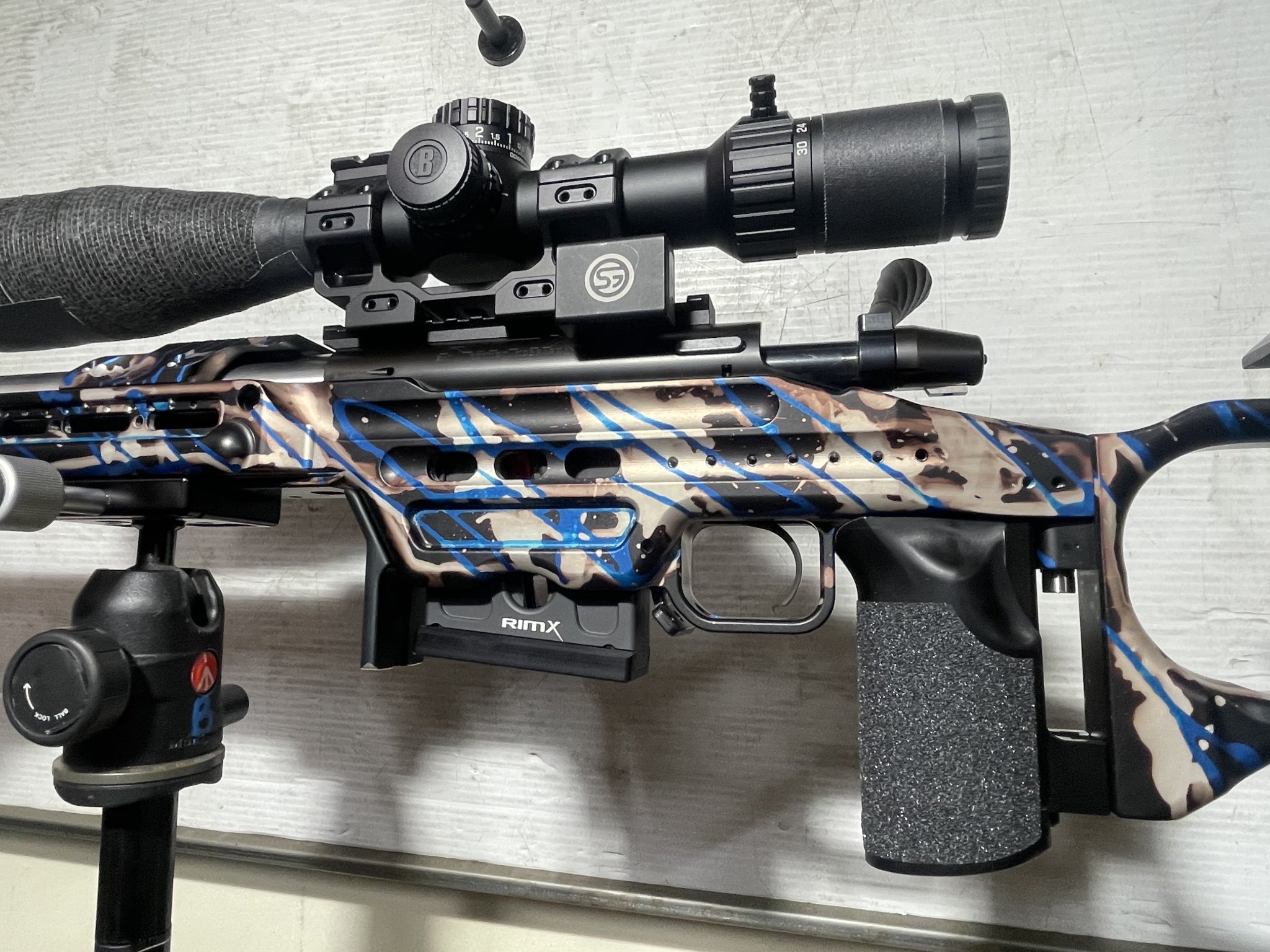

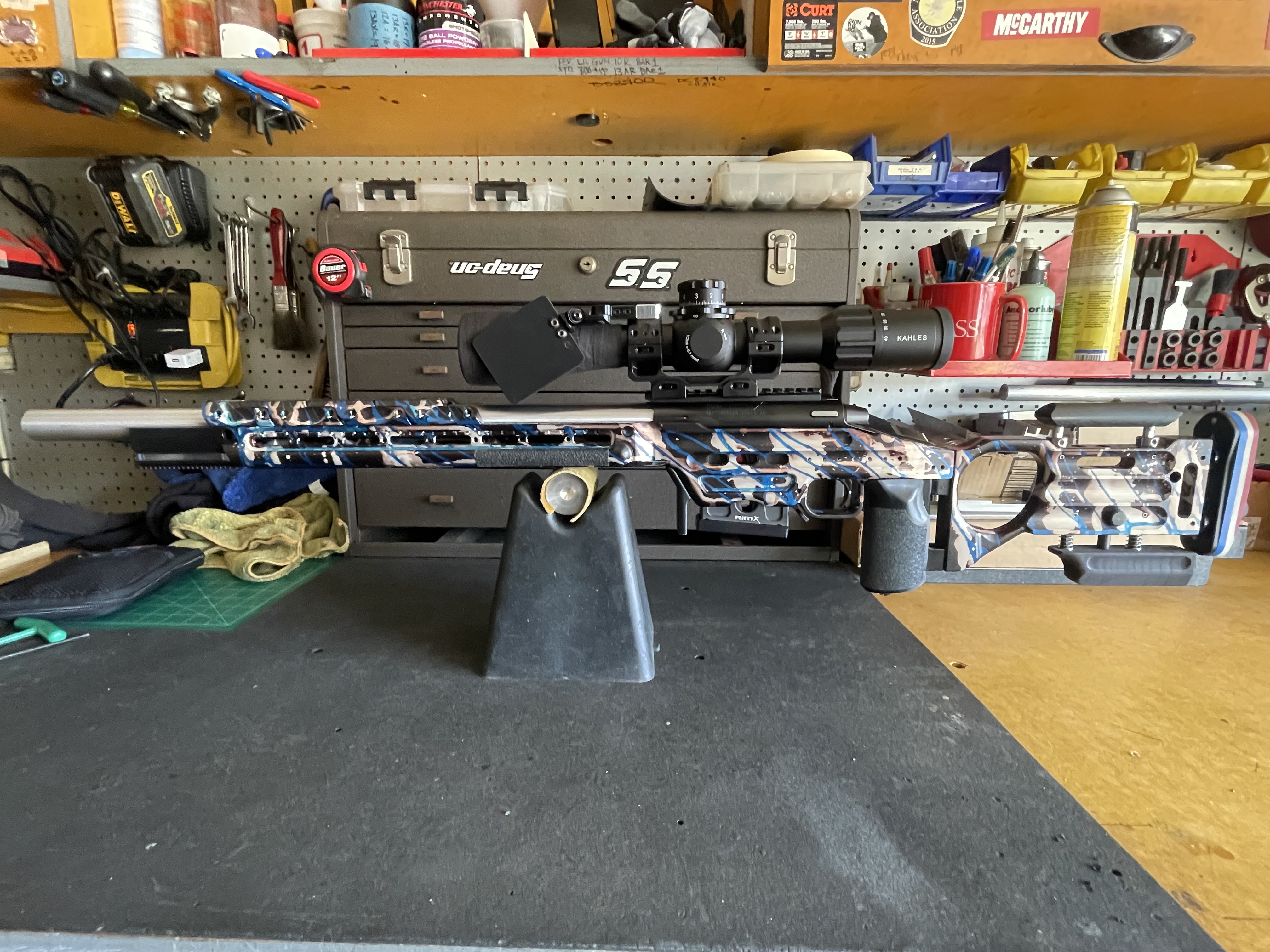

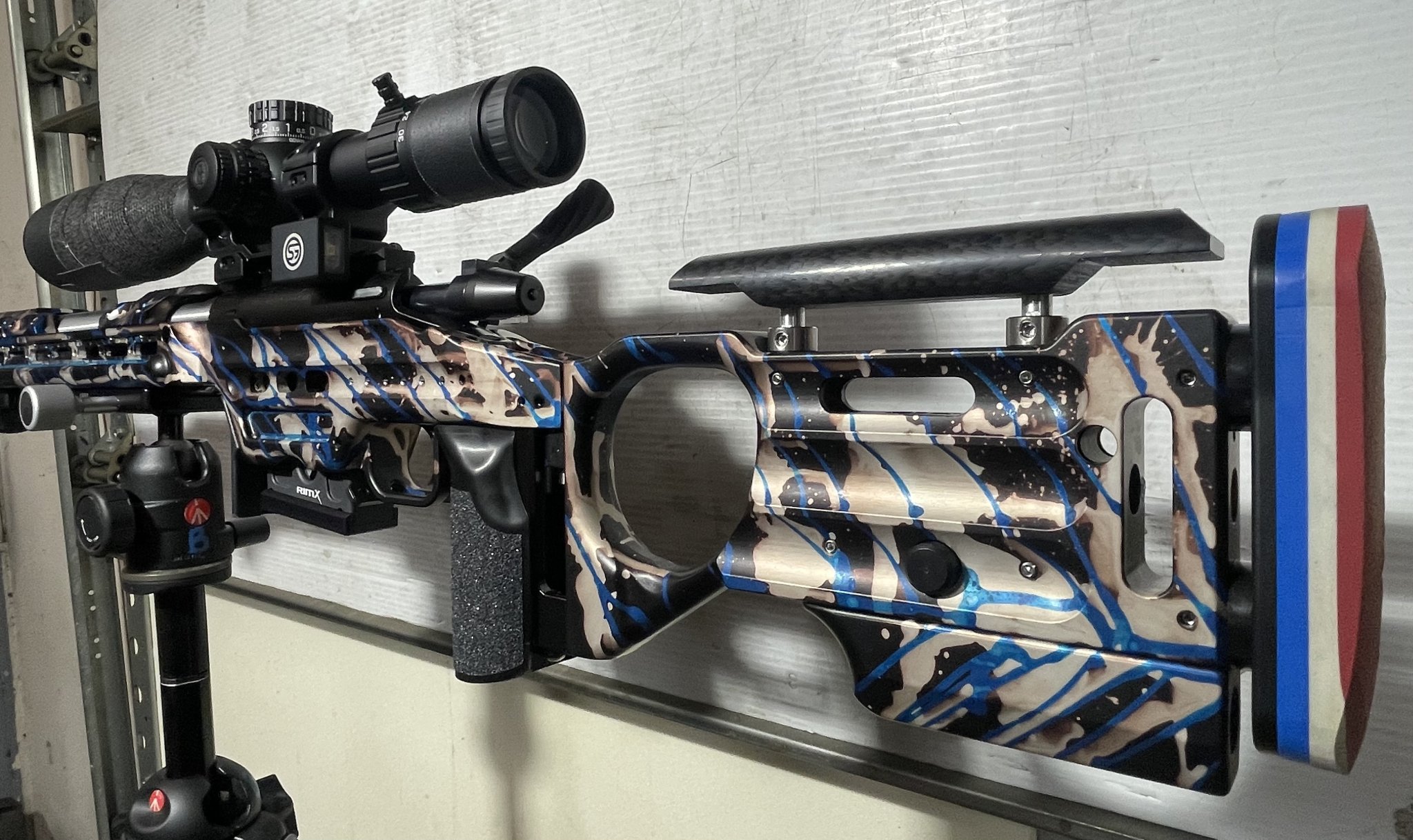

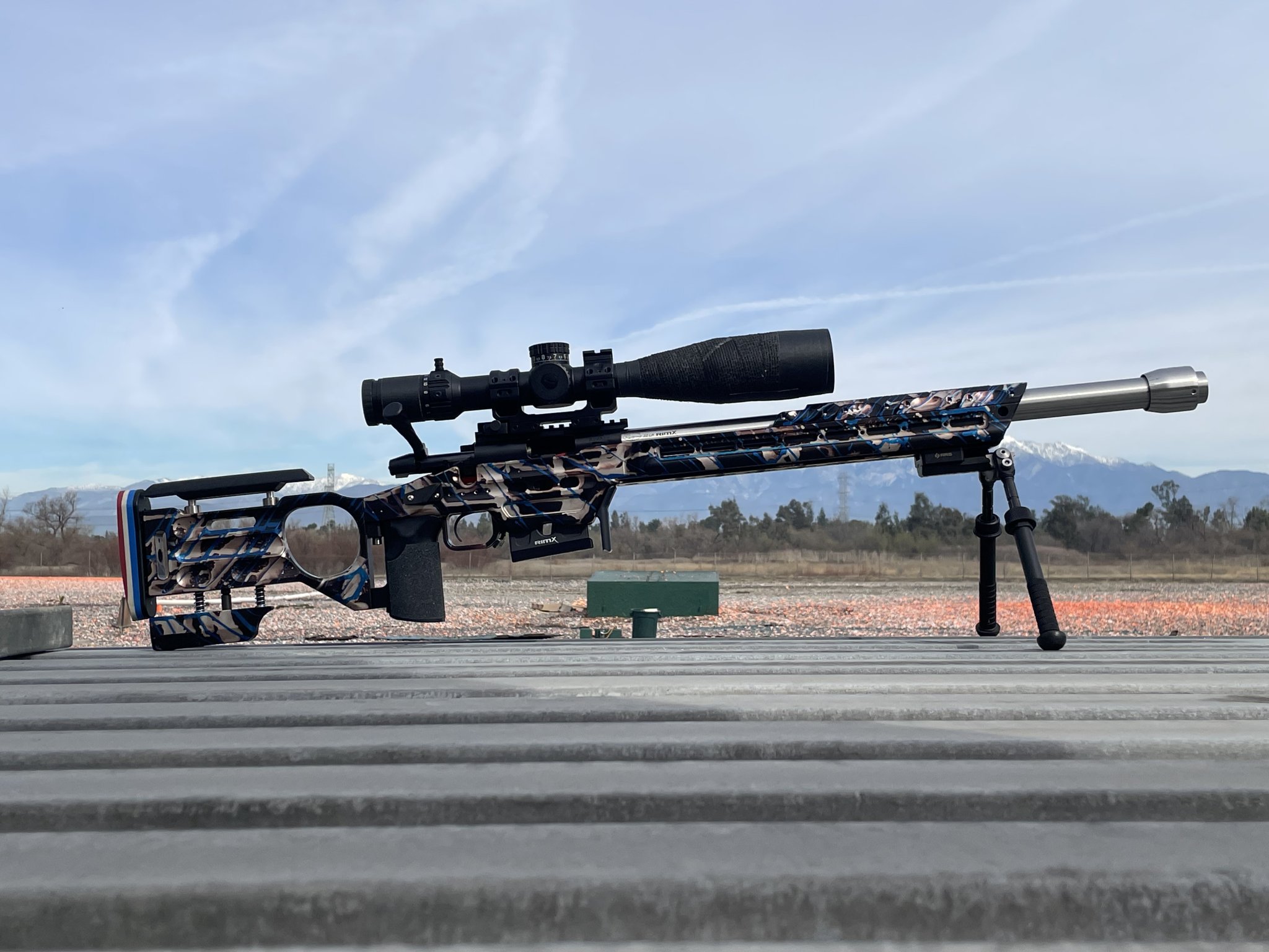

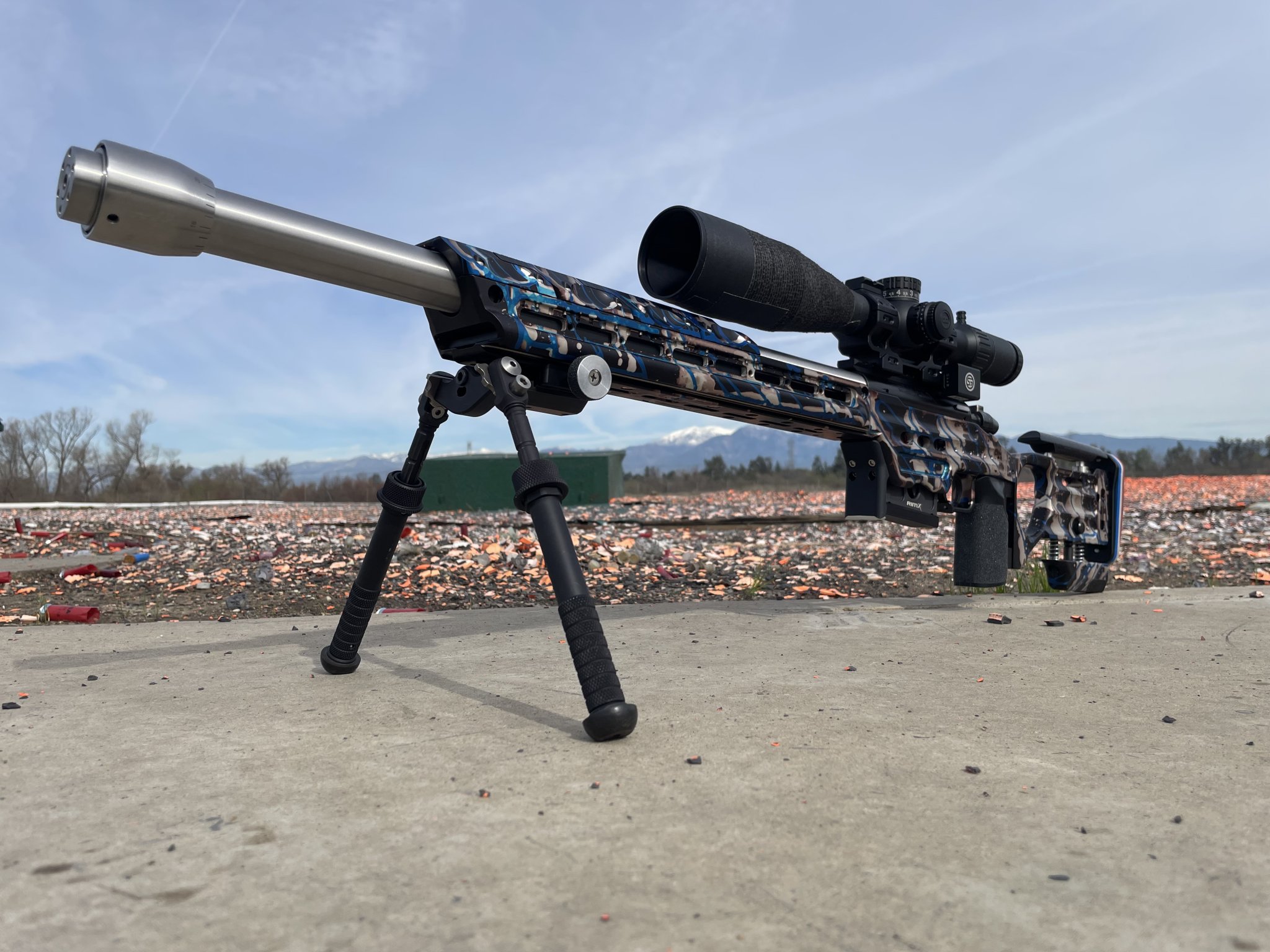

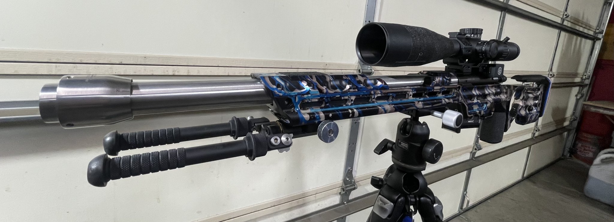

Just finished up.
Specs: 24lbs without ammo
Rimx

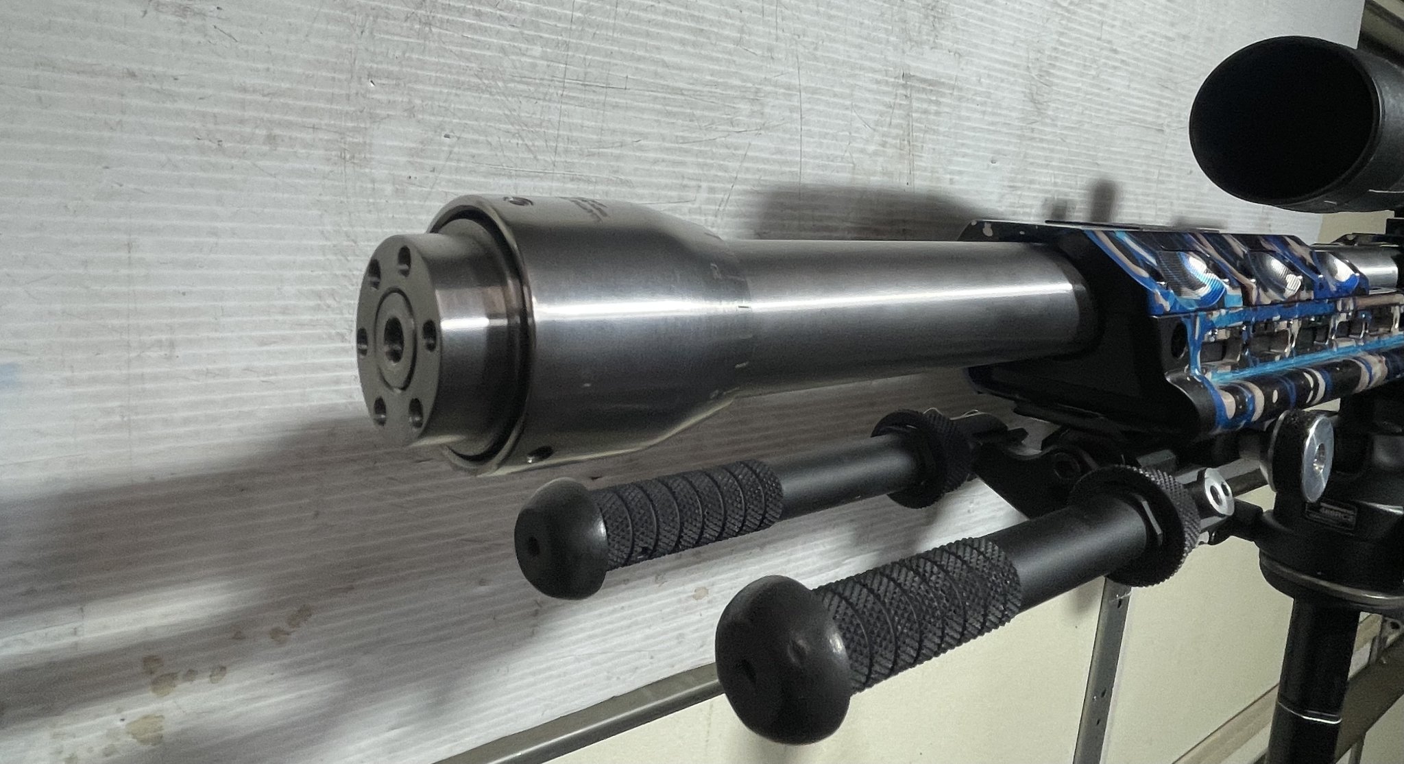

PVA 1.20 straight 24”
ATS tuner with 1.20 jam nut drilled for pin spanner wrench
TT Diamond
Area 419 scope mount
MPED for now (Mark 4hd is in for QC issues)
SG Pulse
Atlas CAL gen 1 with custom steel mount to RRS clamp. Oversized extended clamp wheel

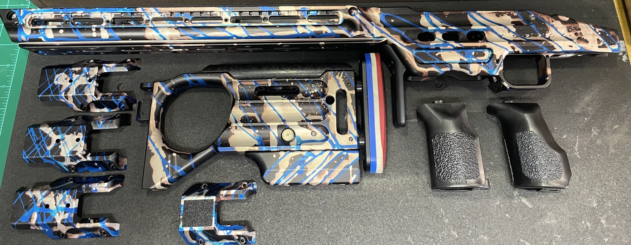

MPA Matrix Pro 2 ordered from DI raw and had a local ano shop finish in splash

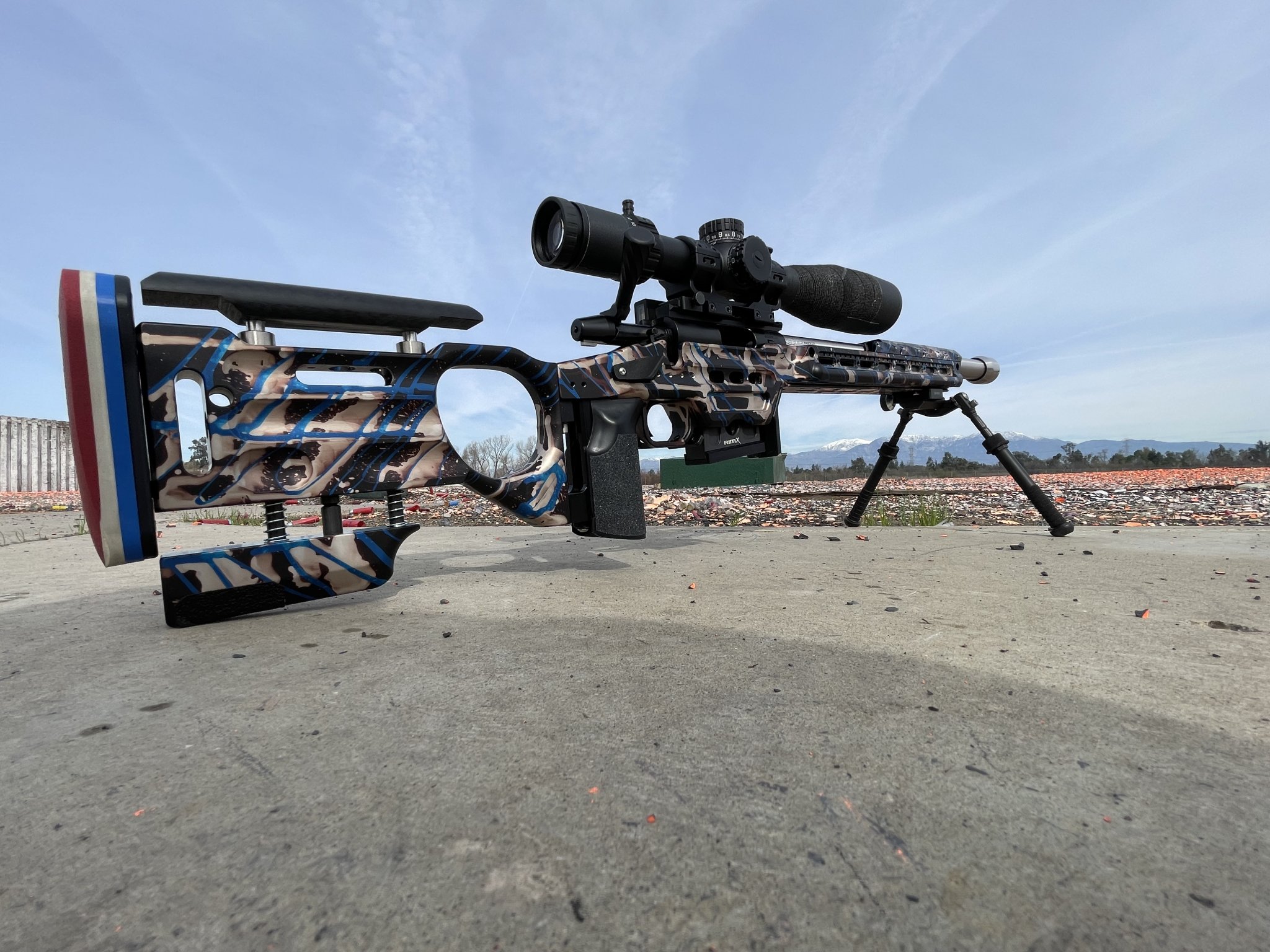

Delrin cheek riser with aluminum pins
Kick Eez Rocker recoil pad (12.5” +/- LOP)
Chopped mag blocker

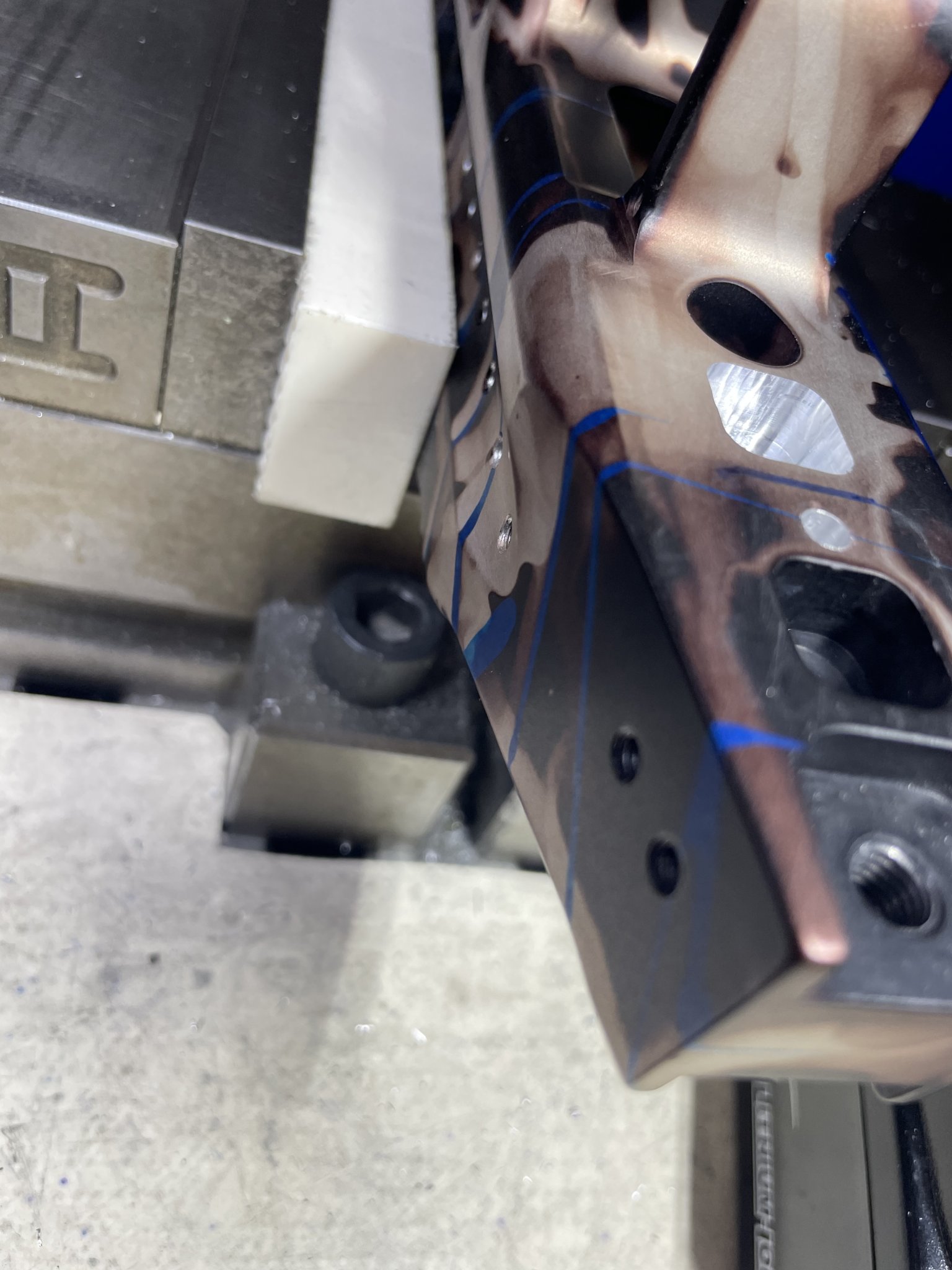

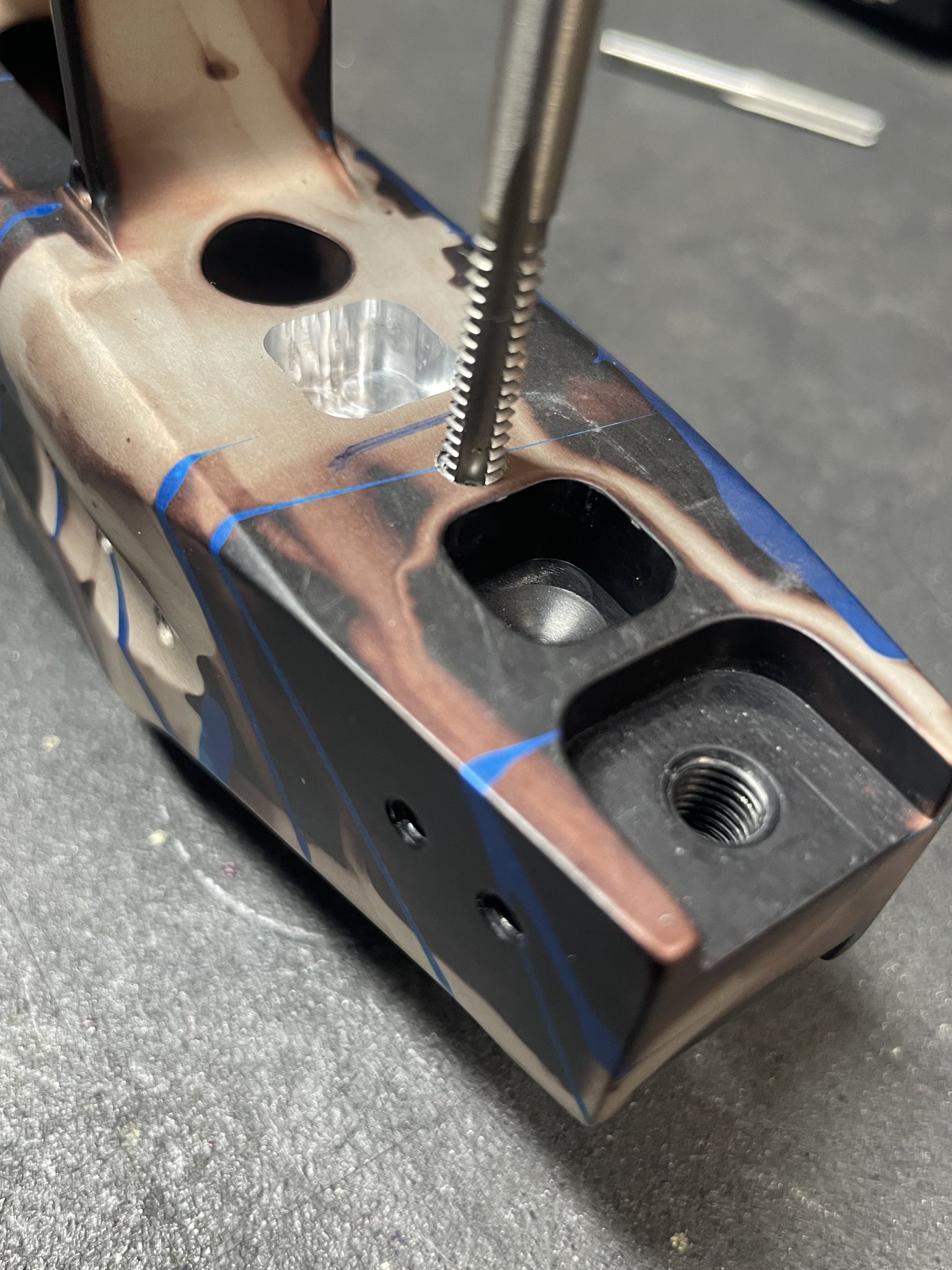

Chassis drilled for Vanquish add ons

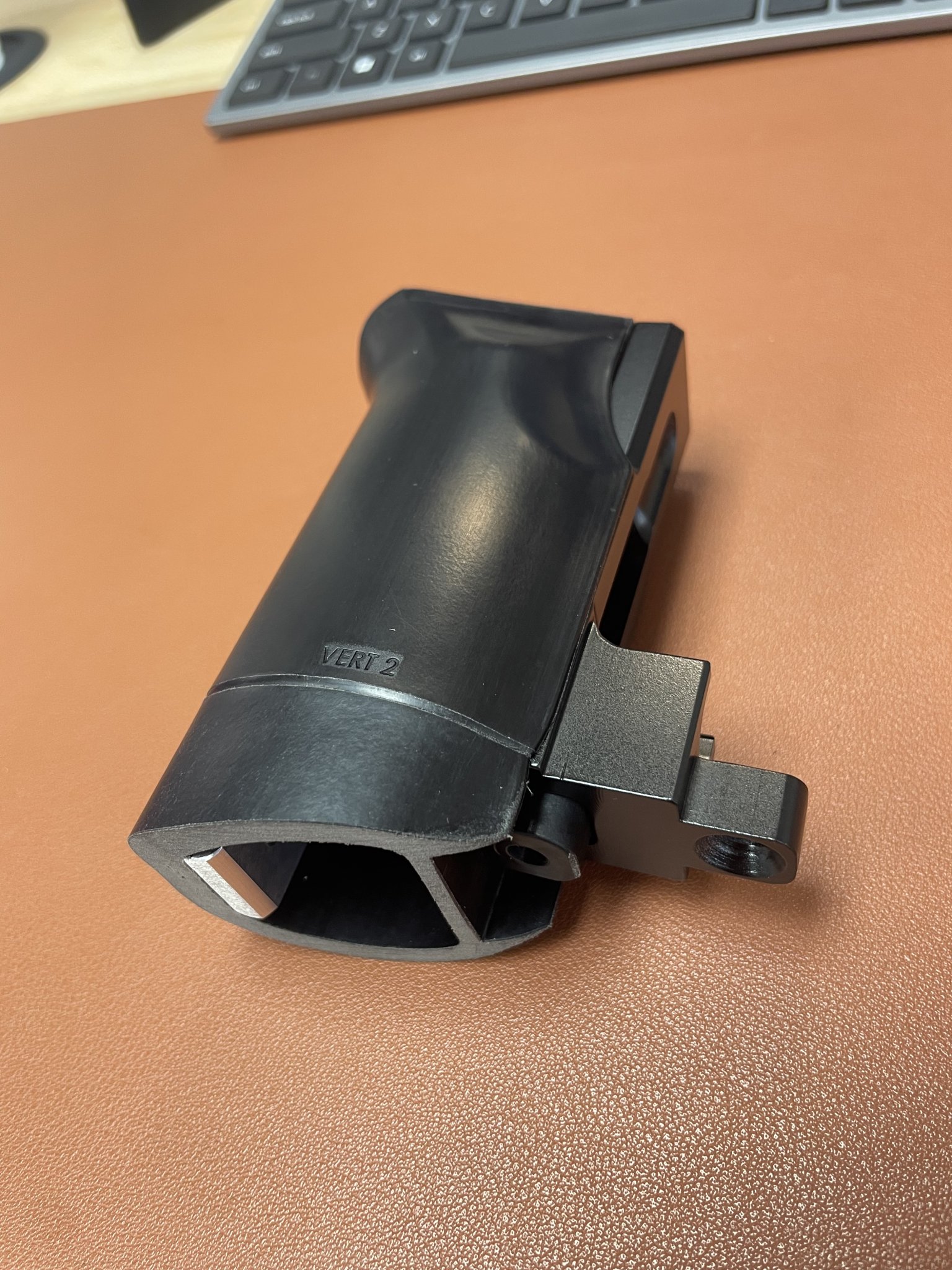

Extended Vert 2 grip
Grip relocated 1” forward. 100% backwards compatible.
Modified MPA thumbrest moved forward 1”

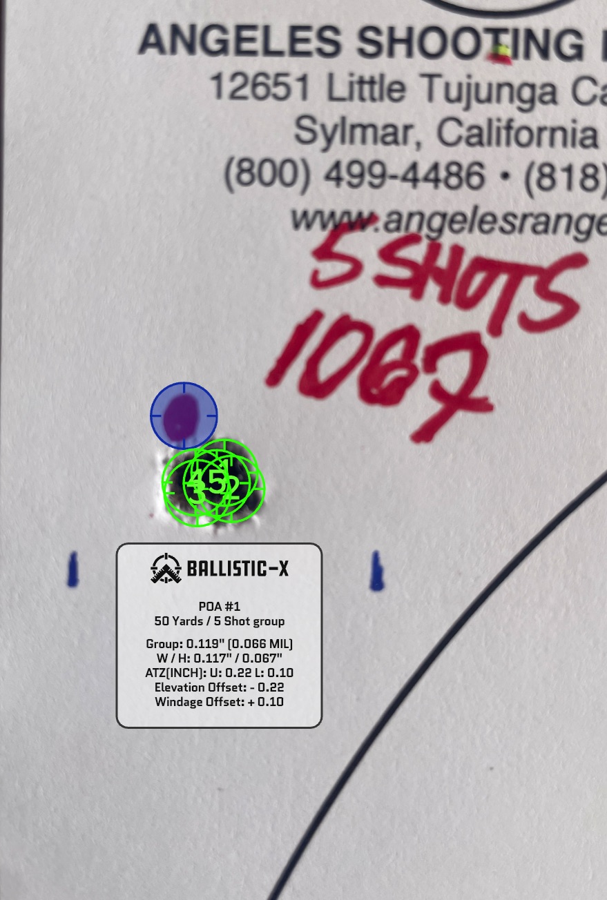

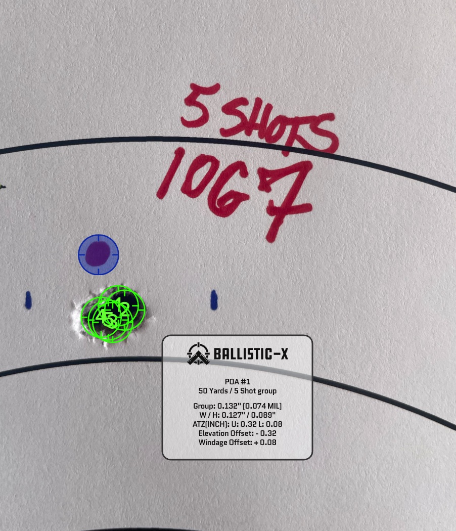

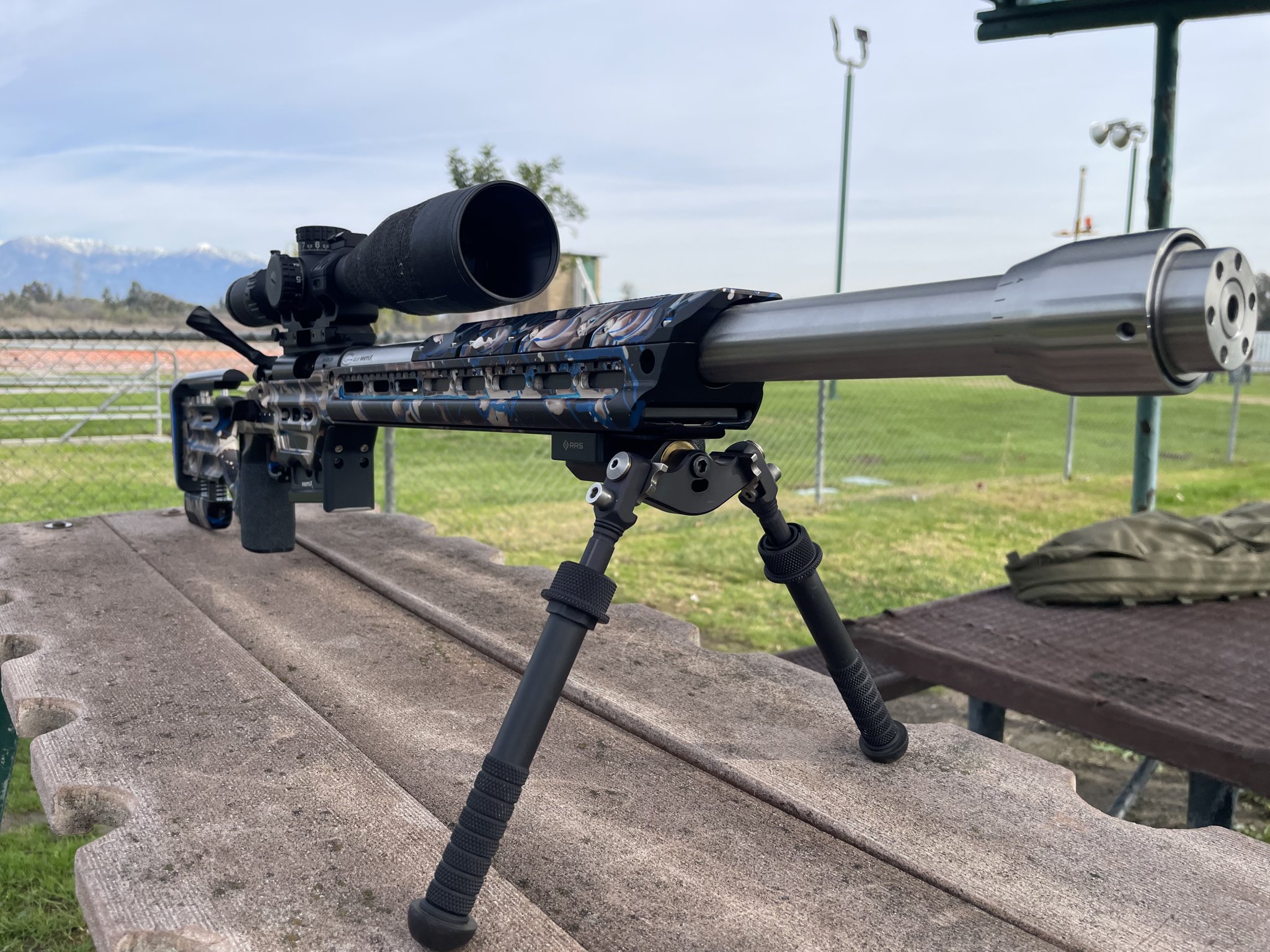

To bad it doesn’t shoot to your expectations 😜
For real yes it looks like it likes that lot of ammo very much . Top notch build !
4 lots of Tenex and all shot extremely well. Settled on the lot pictured above which also printed the best results at 100. I’m in CA so I don’t have the luxury of shipping ammo to my doorstep. It’s a PITA!

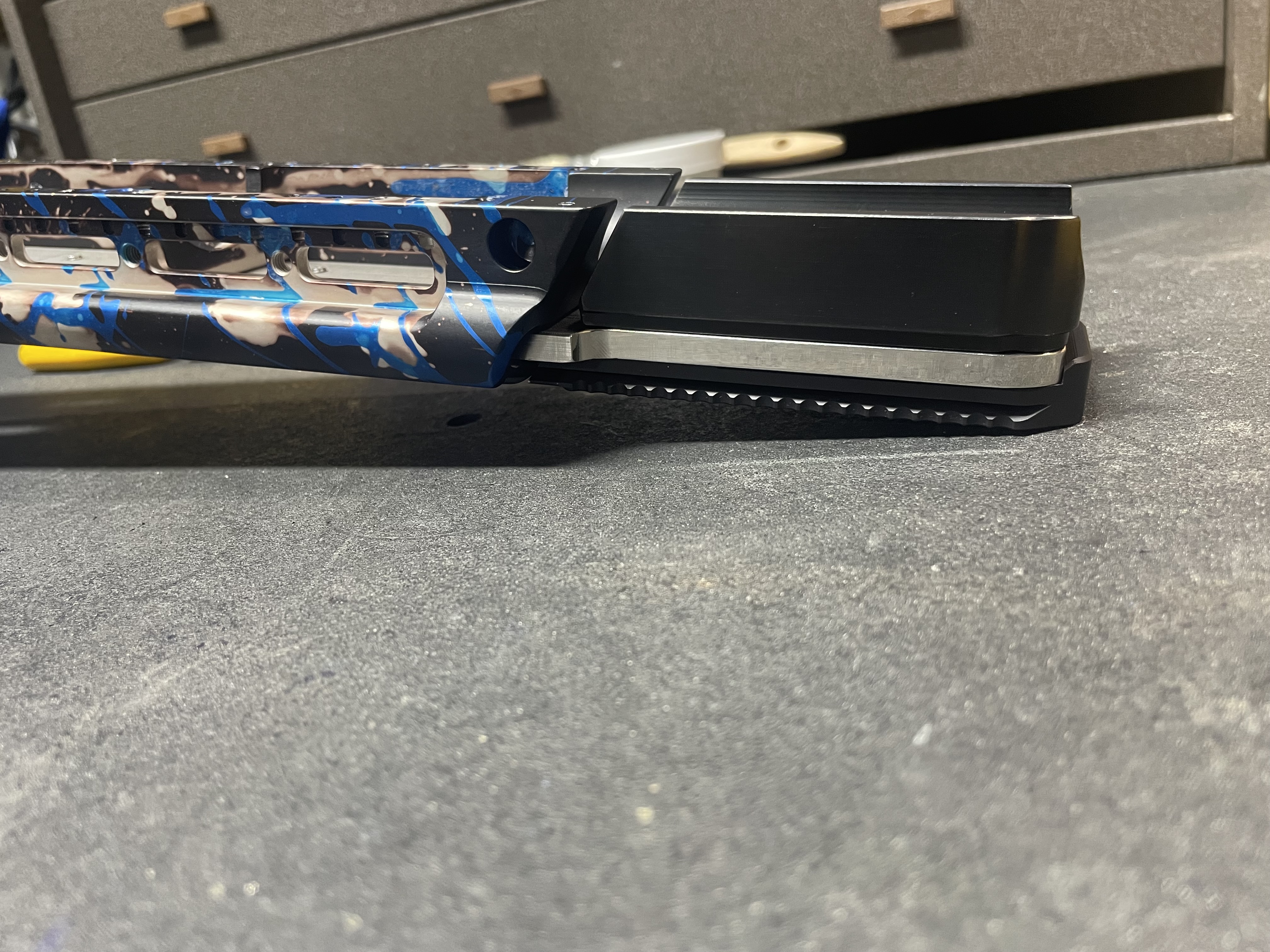

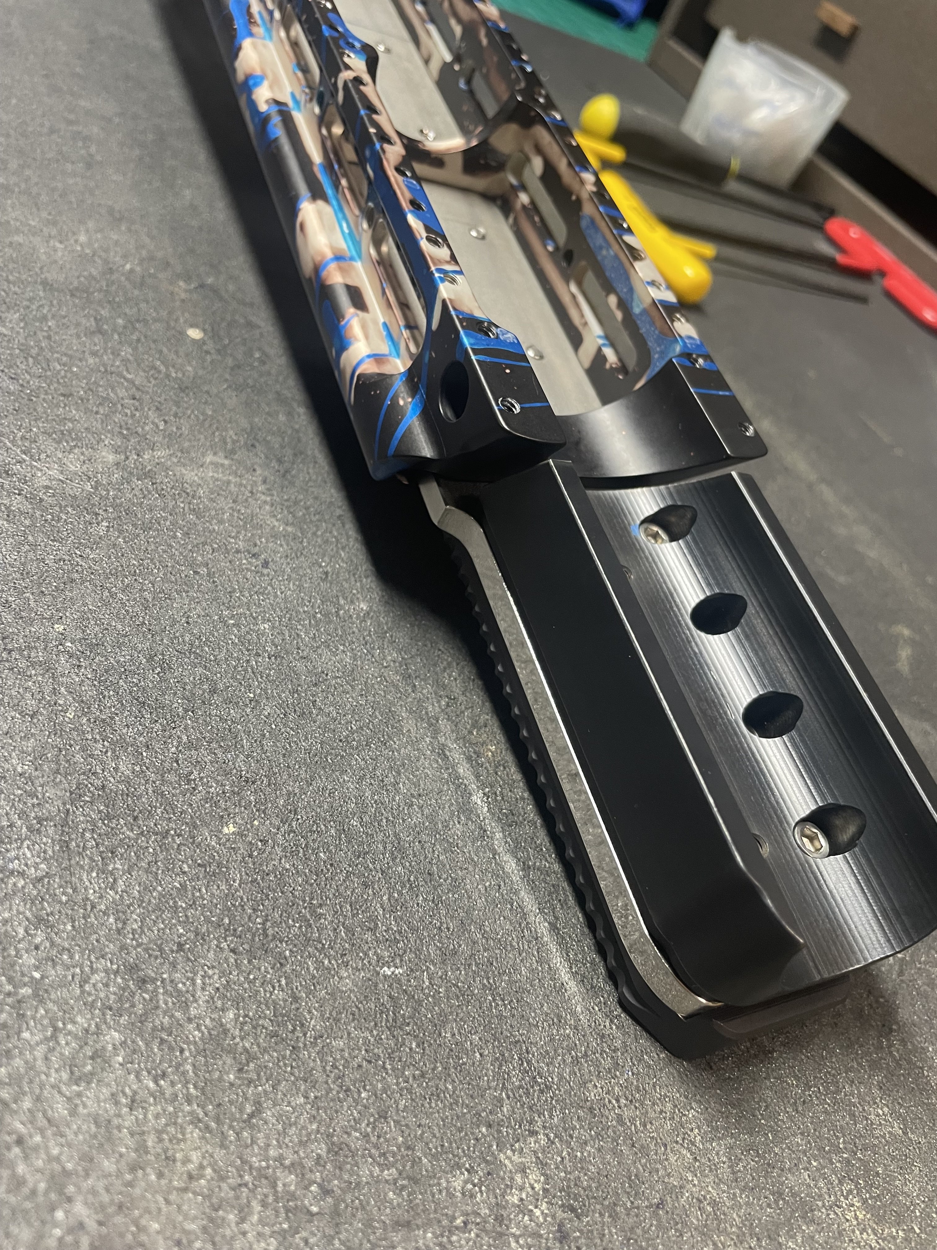

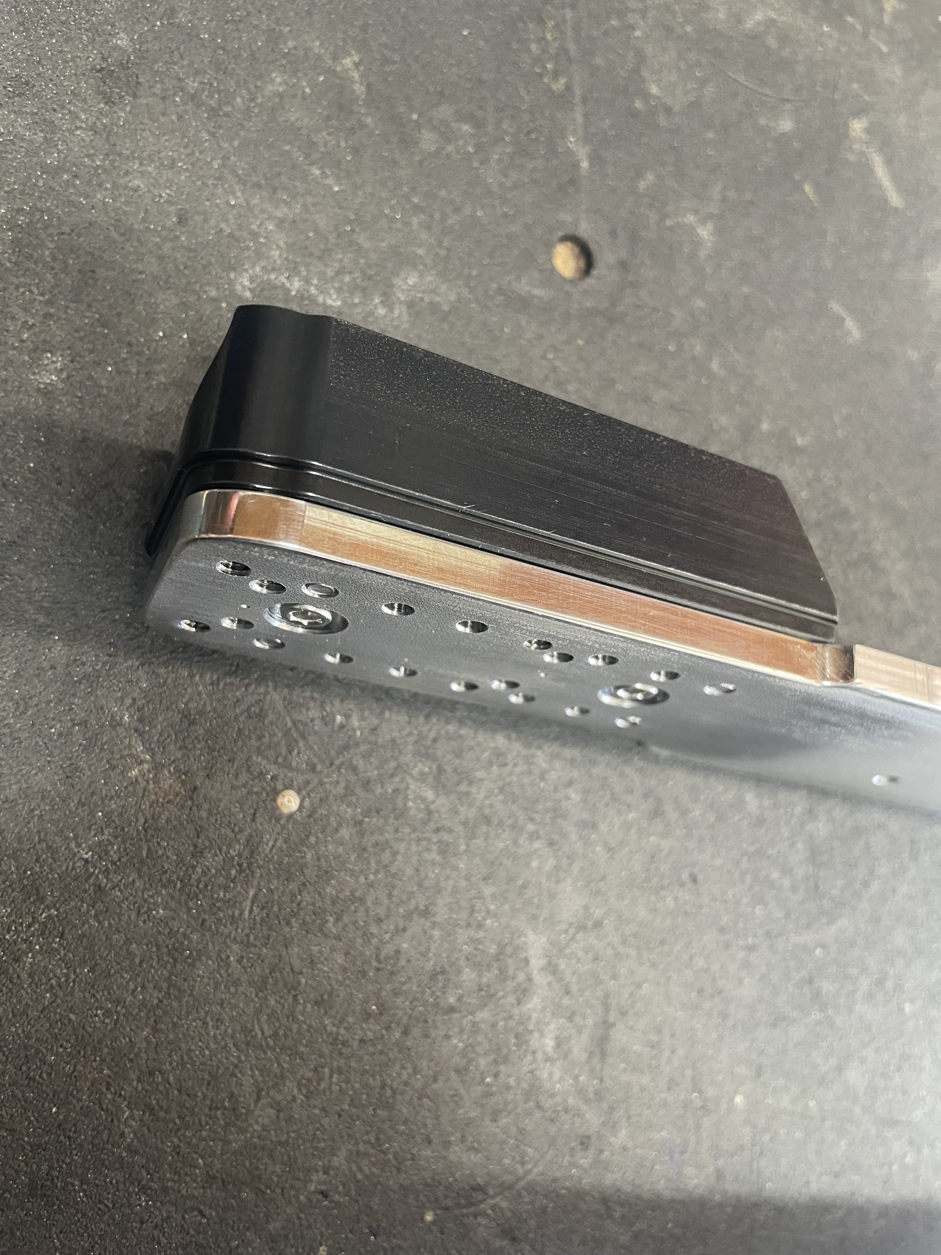

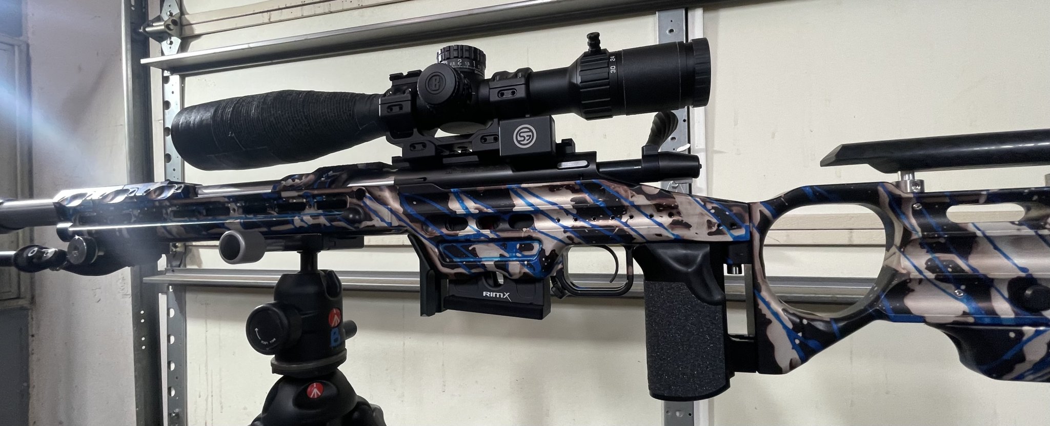

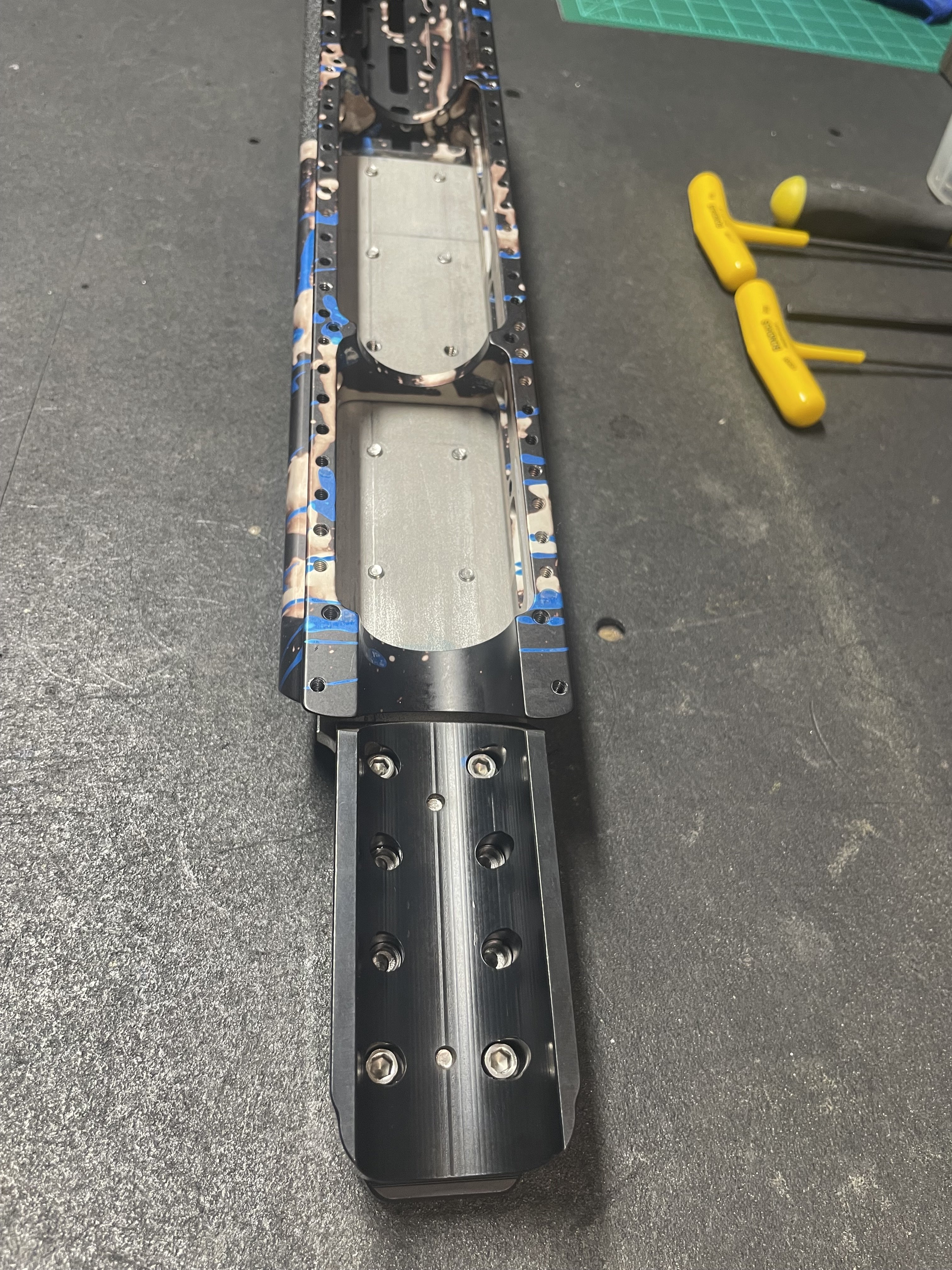

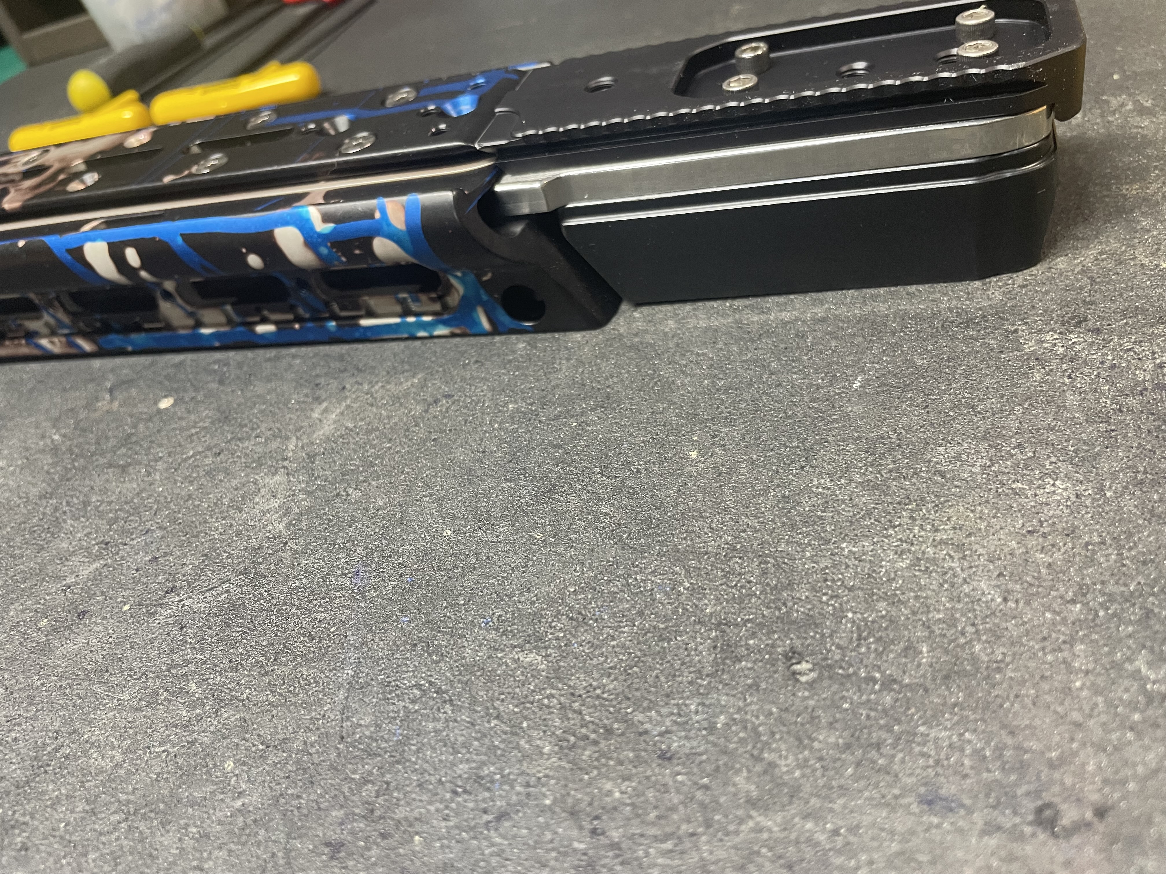

Quick update.
Ordered a new optic (540i) which is heavier than my current. Wanted to keep the weight and balance point, so I outboard the secondary weight and extended the arca rail. Also have the weight reduction kit for the stock if required. Will post pics after the optic is mounted and balanced.
