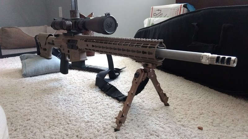

So I have been wanting to build an AR10 in Creedmoor for some time and I finally bit the bullet and bought an Aero Upper/Lower kit minus the BCG and Barrel. I bought a Ballistic advantage 20" barrel from cheaper than dirt for $206 and an AERO BCG on a sale from somewhere else. The irony of it is that all my components combined are the exact package AERO sells as a complete rifle but I got it for about $500 cheaper. I pulled my PRS stock off of another rifle and I was set to go. I broke in the first 20 rounds with boxed 140 ELD which ran very hot in the gun and my 2 10 shot groups were both right at 1MOA.I then switched to hand loads that I worked up from 40.5 grains to 42.4 grains of H4350 and the 140 ELD. I found a good node between 42.1 and 42.4. That was my first trip to the range.

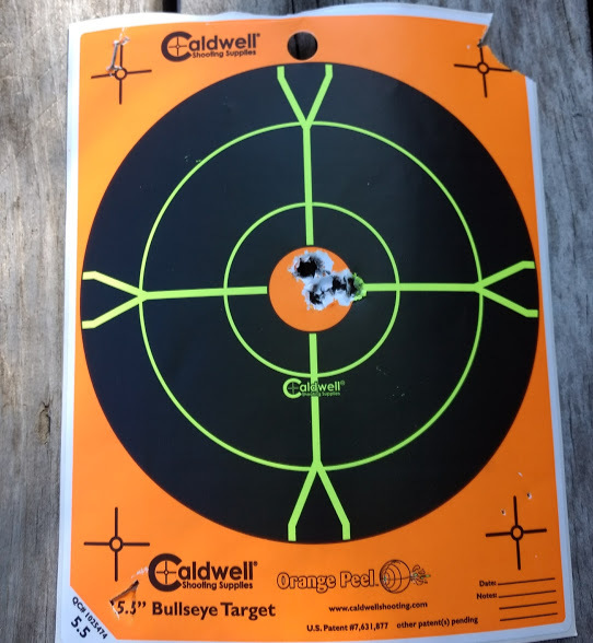

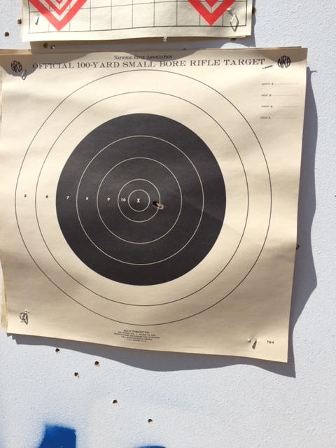

For my second trip to the range I loaded up 20 rounds of 42.1 and 20 rounds of 42.4 to test further and get some chronograph numbers. Initially the numbers had me a little baffled as my 42.1 grain load averaged 2580 fps which felt a little low and had a huge SD around like 20 fps. Then I chronographed 42.4 and it was lower than the 42.1 gain load at around 2540 fps but the SD was below 10 and the ES was 15. I decided my placement of the chronograph must have been giving it ackward sunshine angles so I moved it to a place I have had good results before and the numbers started to look like what I expected. 42.4 grains ended up being the more accurate load with my lowest group being .611" for 5 shots and highest being .780" for 5 shots. Here are the Chronograph numbers for that load.
