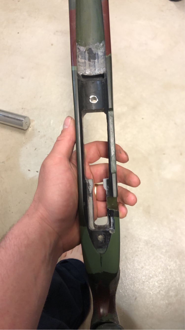

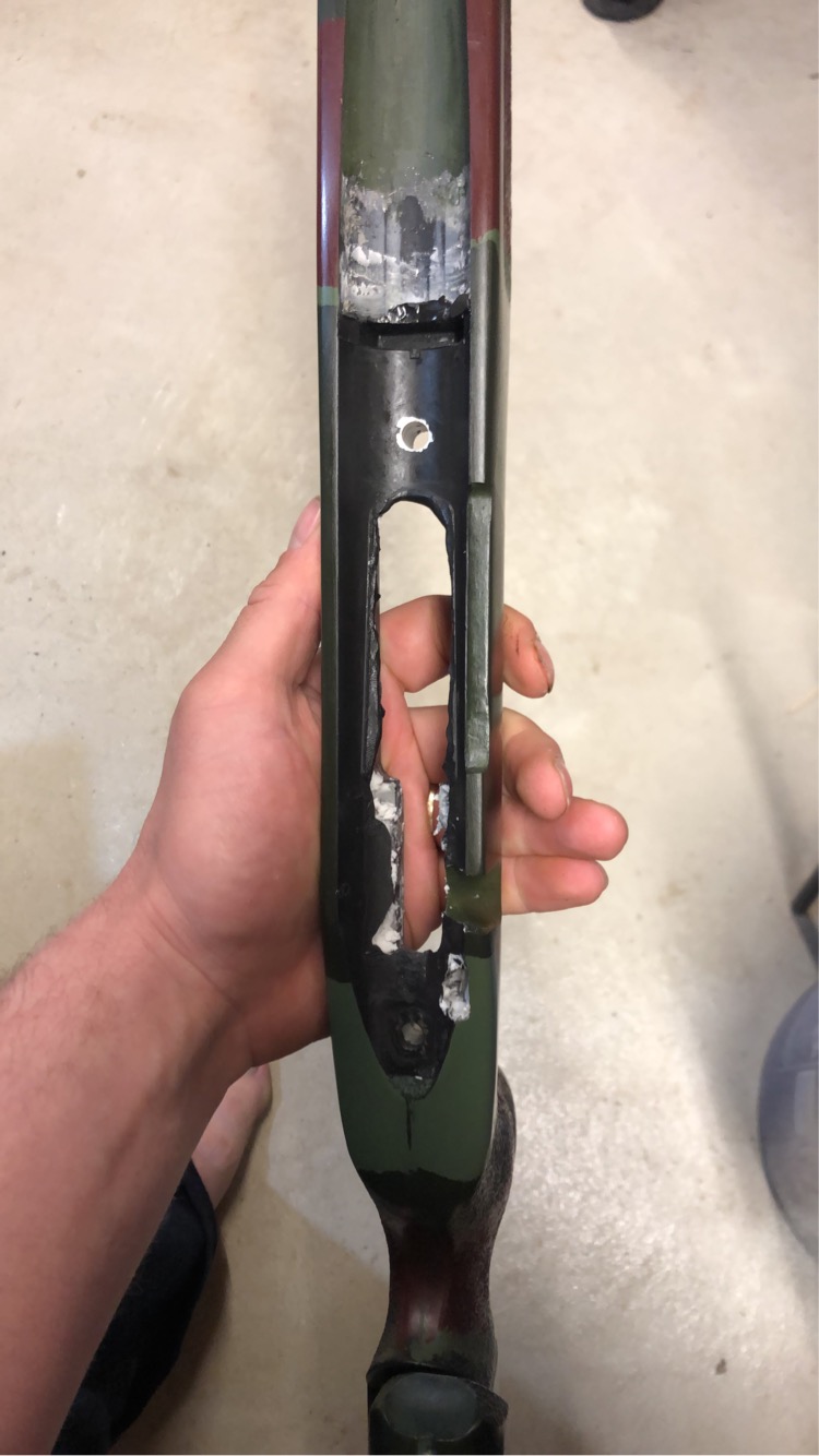

Hey guys, just pulled my action out of my stock after my first bedding job, I think it turned out pretty good. My question is should I grind down the little tit sitting right behind the recoils lug, or leave it?
Thanks

It’s elevated, there’s a little recess behind the recoil lug that it’s from.
Knock that little piece down to flush.
If you dont drop the action in absolutely perfect it could hang on that little piece and break it off causing you some headache you dont need and could prevent.
Your bedding job looks pretty good.
Reactions: 03machstock
Looks like an Origin lug pin spot to me. I wouldn’t knock it off but it won’t hurt if you do…looks better than my first time, congrats!
