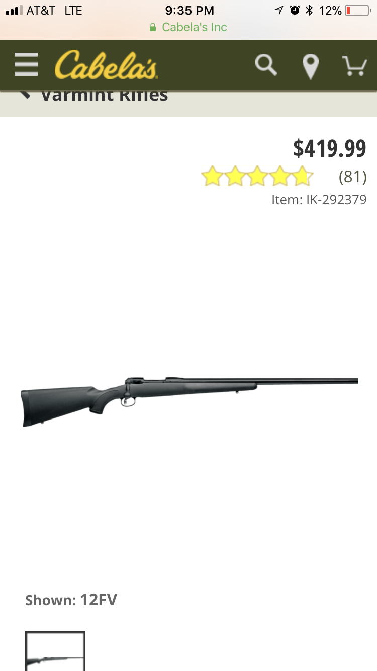

I would recommend a savage 12FV from cabelas at a really fair price. Y
ou would be surprised by the accuracy right out of the box and there is a fair selection of aftermarket parts for them. (You can get it in .308)You can spend some on a stock and the rest on a decent optic and you will have 800 yard gun that you can shoot out to 300 all day no problem. Truthfully you wouldn’t even need to upgrade the stock for 300 yard shooting but that would be the first thing that you should upgrade if you have the money to do so. The accutrigger is fairly nice for the price also. Here is an example of prices on a budget build with a 12FV.
Savage 12fv 419 plus a mail in rebate right now
Egw scope base. 50ish
Scope rings of your choice 100+\-
Stock of your choice. ?

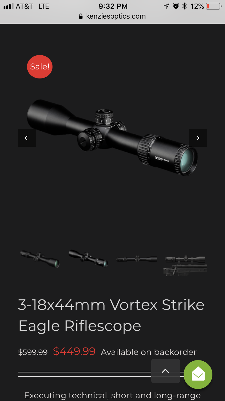

You could do a vortex strike eagle or something along that line at a fair price. 449on sale right now.
