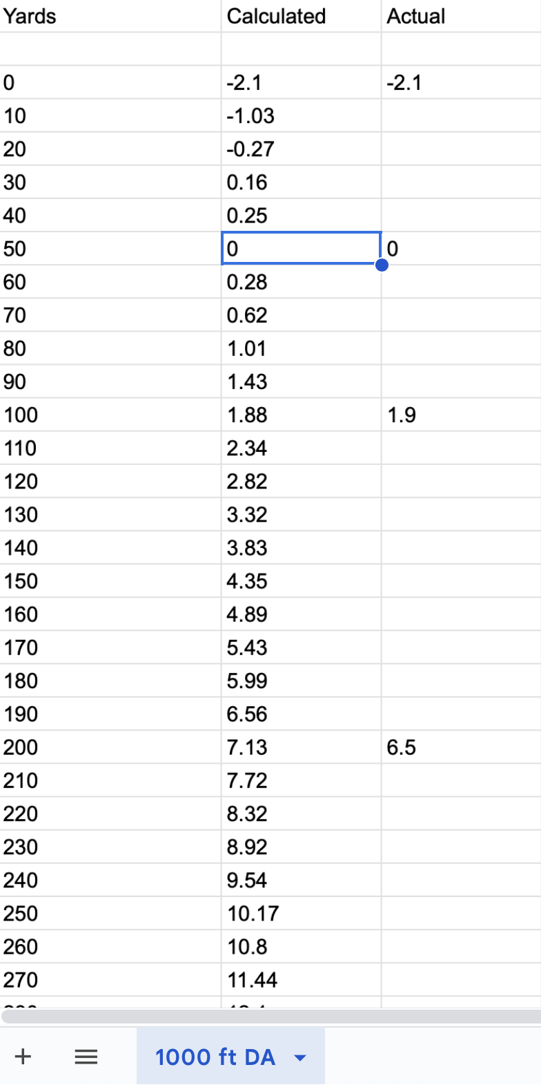

This is what I've got. It does a great job predicting my 100 yard zero then deviates from that point out.
I am confident in my MV, height above bore and DA.
I can interpolate the hold overs manually. But if there is any software that allows you to enter actuals to "true up" the predictions, that would be great.

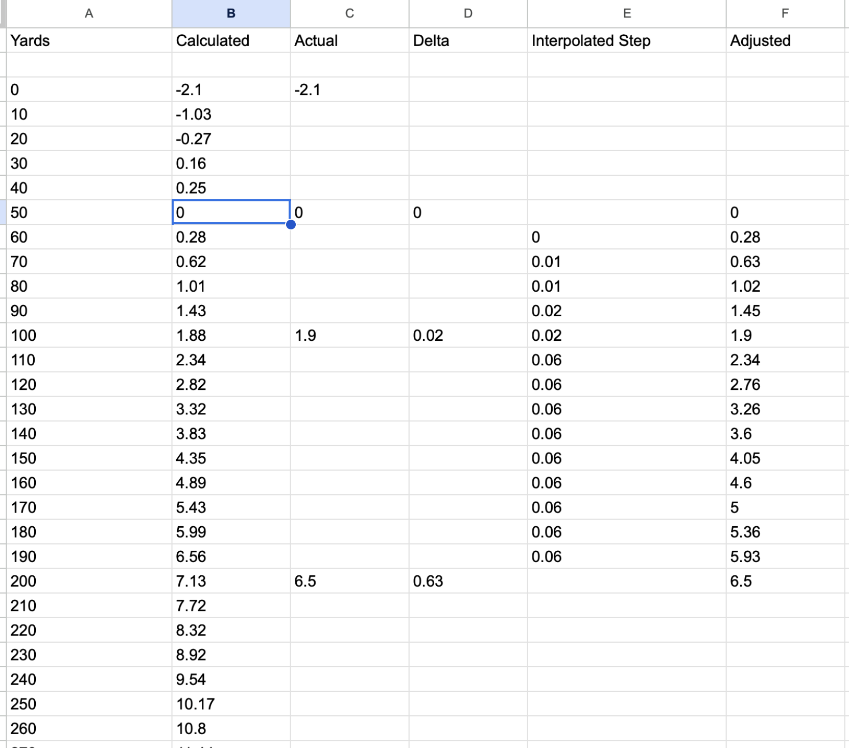

The full spreadsheet looks like this, with me manually averaging the delta between predicted and actual at the 3 data points and applying it to arrive at a calculated hold over.

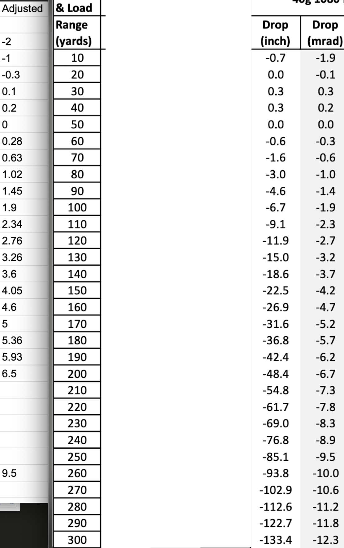

22 Dope Charts
Check this thread out and see how things align to what you’re calculating. It’s a great resource. If you can find a chart for the ammo you’re using I’d just print that and go have fun. Take good notes and adjust for the next match.

@dcmdon , your method is not flawed, just your inputs. What the differences are telling you is that there needs to be an adjustment in your inputs. Typically for .22, it’s either speed or scope height to bore. Sometimes the bc being used is of if manually entered, but often it’s one of the above.
I still use manual numbers for my dope, but like to use 5 yd increments for .22 . Especially at 200-400 yards, every yard starts to count and estimating exact dial/hold is more critical.

Well, the competition went well. I made one chart with both my calculated DOPE and the chart in the link provide above.
My actuals matched the numbers for Aguila at 100 and 200 pretty close. So I used that data and trimmed it a bit.
This is the chart I used.
My data was at a density altitude of 1015 ft per my non-ballistic kestrel.
DA at the match started at about sea level and went up to about 400 ft by 1 pm. So nothing to really worry about.
