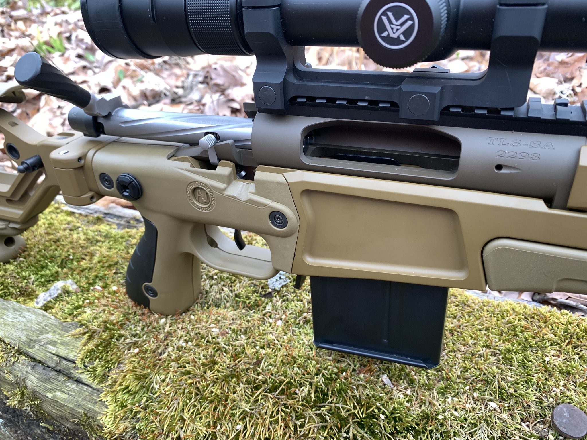

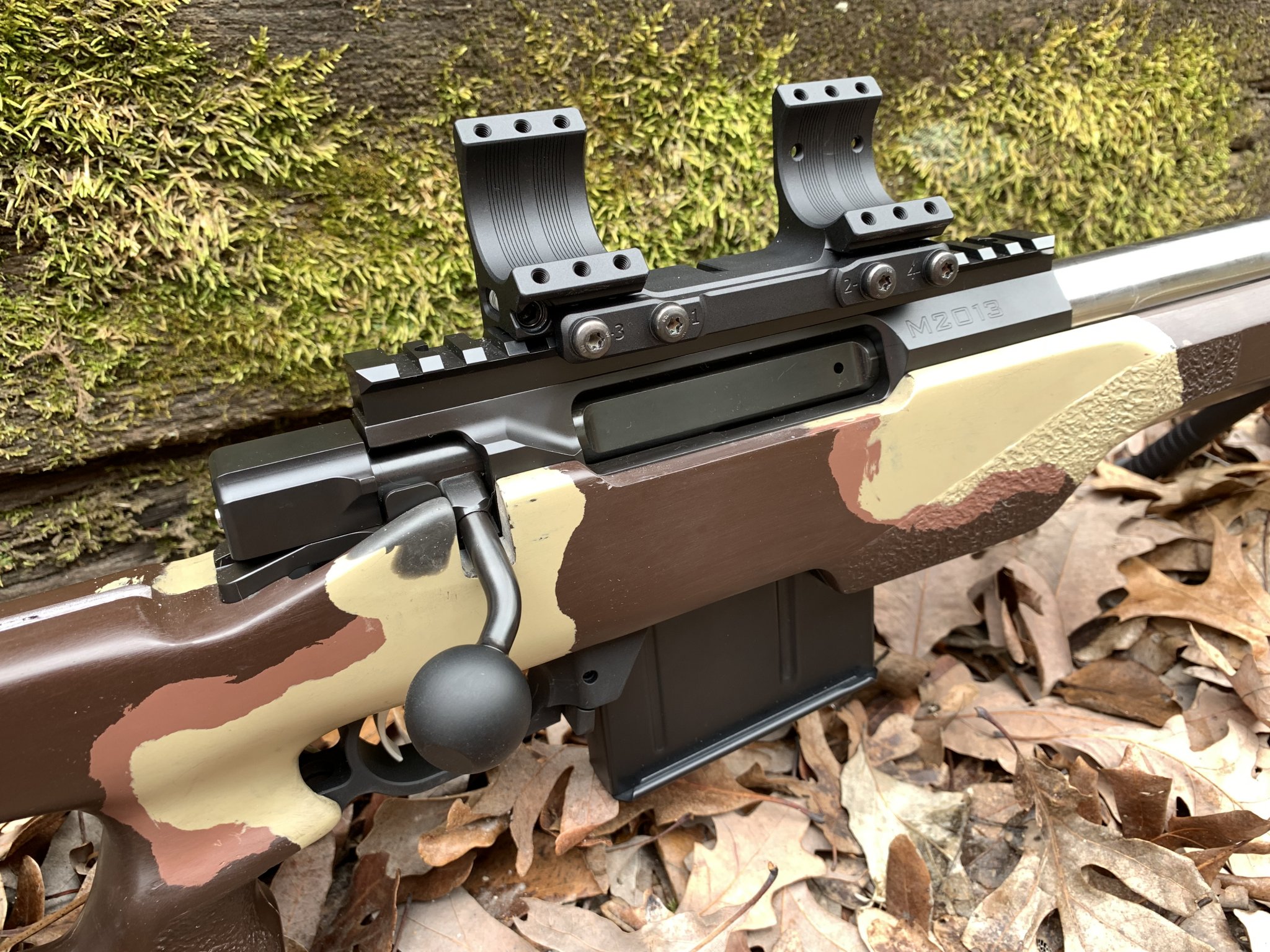

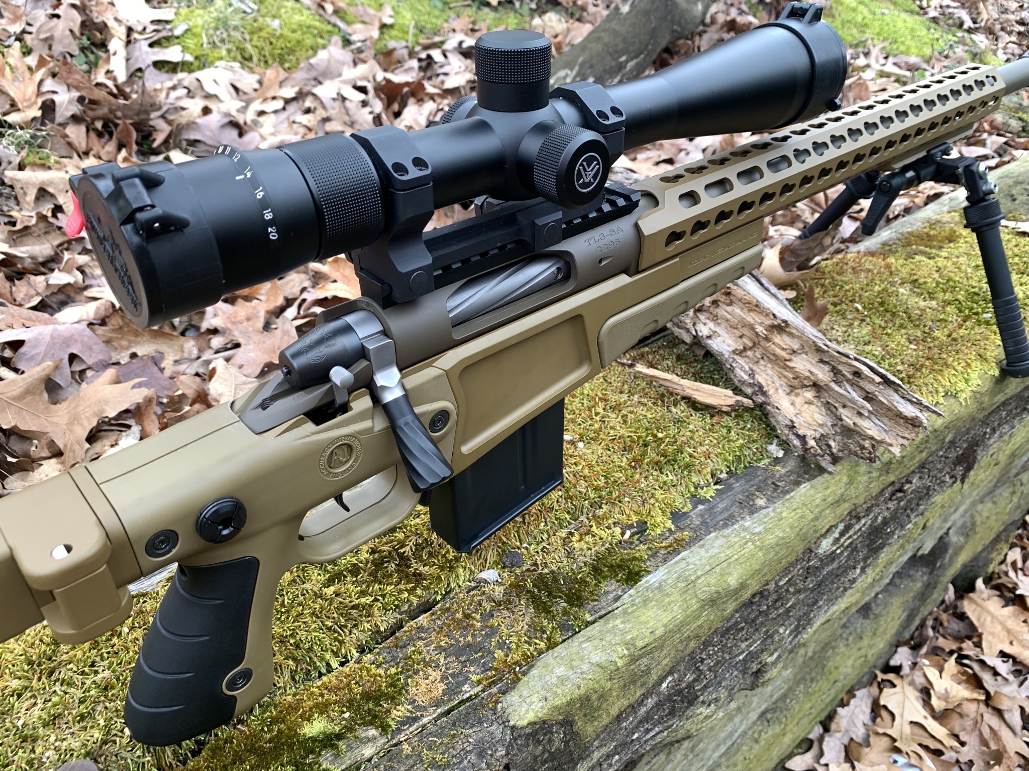

Ive been shooting precision rifles for over 20 years now. I started on Savage rifles, then an FN SPR A1, and now I’ve got a Badger M2013 and a Bighorn TL3.
The Badger is incredibly well engineered and machined. The cuts are all crisp and beautiful, the breeching ring is a brilliant way to do it. It’s 3 lug, and the bolt lift is not what I’d call easy if that’s a concern for you. Mine is QPQ’d. I still need to bed it and load ammo, nowhere to shoot it to warrant dropping the cash on ammo components at the moment so it’s back burnered for a bit.
Here’s the Badger:
7062272
7062273
The Bighorn has the lightest bolt lift I’ve ever felt. There are plenty of actions I haven’t used so take that for what you paid for it. It is also incredibly well machined and well designed.
Here’s the Bighorn:
7062270
7062274
Both will bind if you’re sloppy working the bolt, and both are slick as greased goose shit if you know how to run a bolt. Most actions won’t bind if you know how to run a bolt. I’ve had several people who have little to no experience using a precision bolt rifle shooting the Bighorn and the only responses I’ve gotten have been “fuck that’s nice”, and no binding or malfunctions. Mine is cerakoted on the receiver, inside and out by Mile High. I have nothing negative to say.
