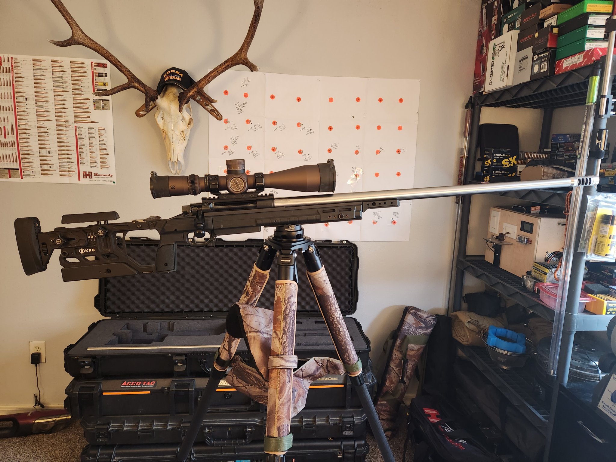

I'm in the process of doing just what your doing. Getting my feet wet in ELR. I've already started trying to find all the components for my build. I've decided to chamber in 300 Norma mag improved to get a little more case capacity and less trimming because of the 35 degree shoulder. Because of the larger bolt face, on down the road I can upgrade to the 33XC or another .338 variant by then.
1 Surgeon 1581 xl action
2. Barlein 30 inch 9 twist 5r barrel HVY
3. Triggertech Diamond trigger
4. Manner MCS-T4A Team stock
5. Nightforce Atacr 7x35x56
6. Eratac 0-70 moa base

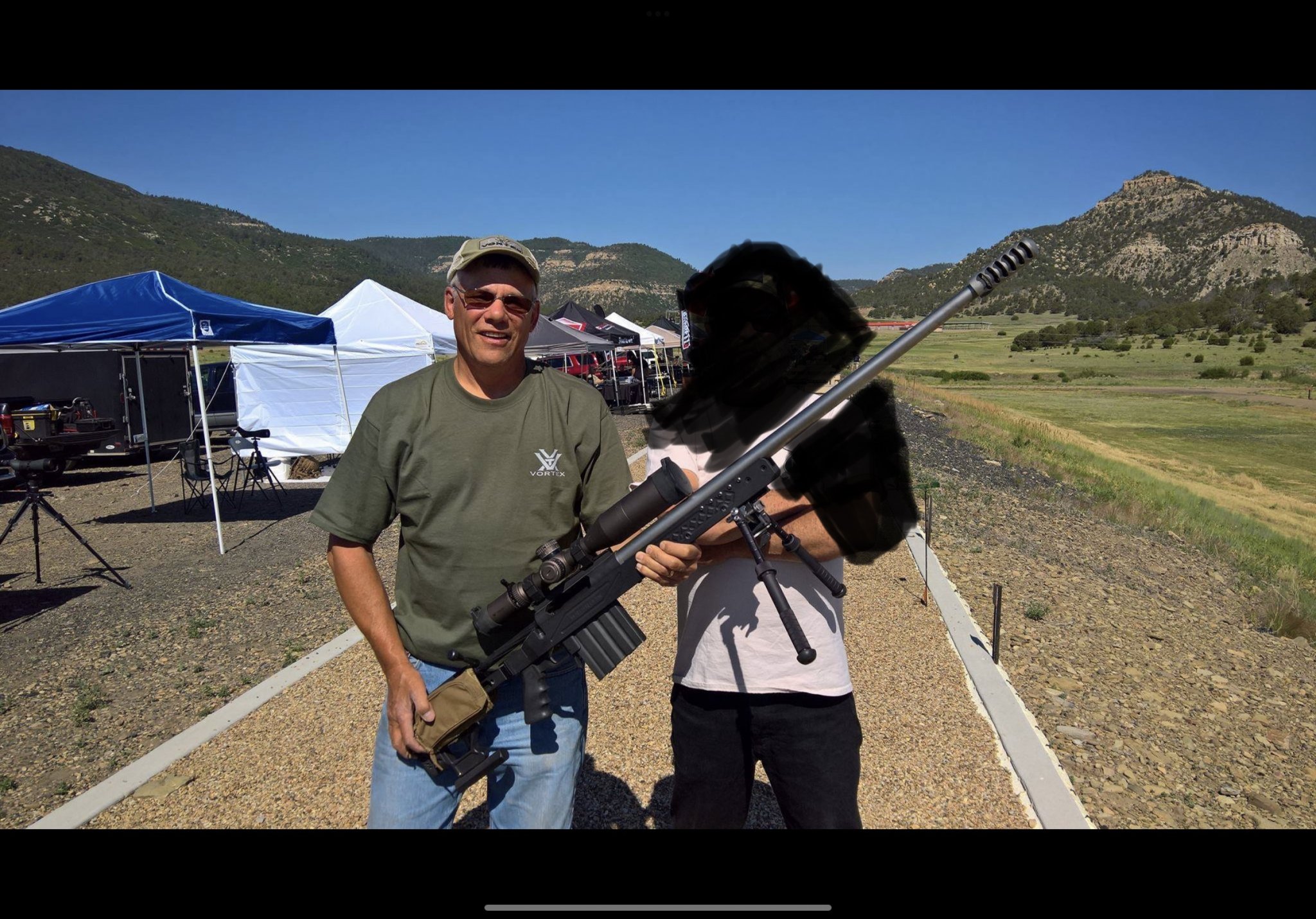

Probably a good example of what you could build off of, something in a 375 but the mag will be a limiting factor for your bullet selection.
Can’t believe this dumbass brought this rifle to what looks like a big event, its got a mag! Funny stuff.
Pictured - 2018 KO2M 375 Snipetac - the only rifle to hit the coldbore target and take some paint off all qualifying targets for the finale. Shooter - Jeff Heeg
JHView attachment 8024256
You get to save a few bucks not putting a mag on, consider you’ll never use it unless your gonna dual purpose the rig for long range hunting or matches like Night Force. That being said I don’t know why people literally won’t give any advice or guidance on mag feed systems. IMO if you want mag feed capability giver.
Won’t give advice is not the case here, I did mention that the mag would be the determining factor on what bullets could be used. SMKs would be fine but any of the Flat Lines or Cutting Edge and bullets of the same wouldn’t due to the length.
The 300 NM or 33XC would be a nice light gun build and serve very well, as Badassgunworks mention you could build a 375 Cheytac for a little more or the same as a good 300 NM and stretch things out. Nothing wrong with having some good choices today versus years back.
For what I know that rifle with the mag pictured has shot outstanding.
