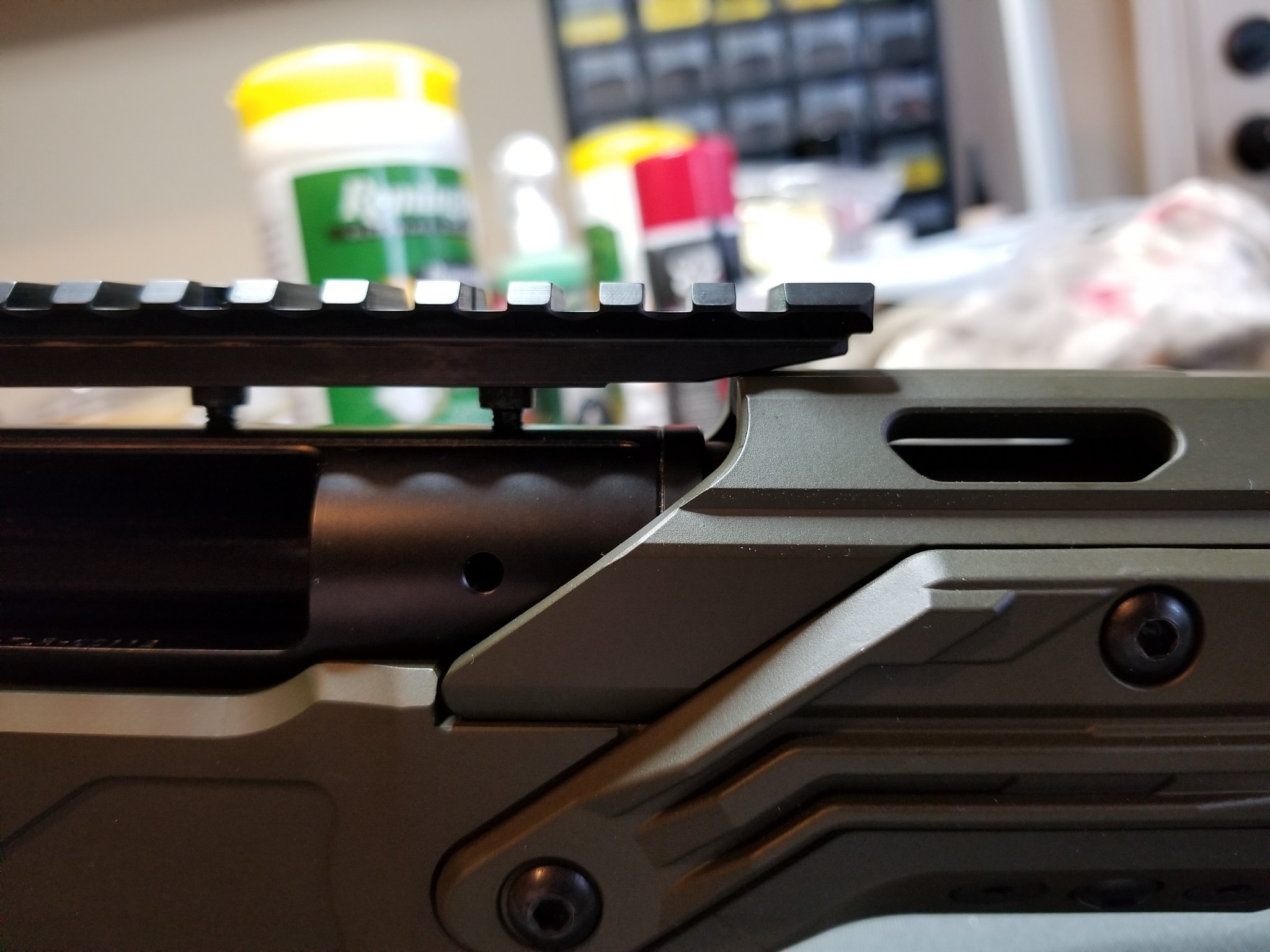

'nother brief update... I installed the TBAC 338 brake/mount yesterday, and as I was drifting off to sleep last night, it occurred to me that the outer diameter of the flange on it might be too large to fit through the fore end tube of the Cadex. We'll have to see... given that I installed the brake with high temp red Loc-Tite, I sure hope it'll fit...
The chassis landed in my hands yesterday, and I really dig it! The good news is that the fore end tube slid over the TBAC 338 BA mount without any problems... the problem (which I didn't even think about) is that the extended rail that comes with the Mausingfield wants to occupy some of the same space as the fore end tube. Hmm.
The good news is that I'm 99% sure that I really only need to lose the first slot off of the rail in order to get it together. Also, as the picture shows, for those who are interested in running a Barloc in a Cadex chassis, you won't be able to access the screw on the Barloc without either removing or notching the fore end tube.
In regard to other fitment questions, there's nothing to report... which means that it all fits/functions like you'd hope/expect. The stock in the folded position clears the Mausingfield bolt handle (with the standard knob) without any problems. I plan on contacting LRI (from whom I bought the barreled action) today, re: shortening the rail. I could do it myself, but have limited confidence in my ability to make it look good.
Reactions: KZP
IDk, seems like it would be pretty easy to grind that last slot off, and it really wouldnt be noticeable behind the guard with a bit of sharpie or paint on it. It would save shiping costs. Thats if you have a grinder...
Could you drill a hole in the tube to access the barloc bolt? Also, do you need to support the barloc or will it naturally orient itself? I dont remember it having any pins to the action etc. If it needs to be out to access it anyways then it wouldnt be worth it to drill the forend so its a moot point.
I definitely have the tools to make a hell of a mess of it, and that's a good point about it being behind the guard. Hmm.
In regard to the Barloc questions, a person could absolutely drill or notch the tube to access the bolt. In regard to supporting the Barloc (say, during barrel swaps), I think it'd just kind of fall to... I guess you'd call it the "chin" of the chassis... basically, where the fore end tube joins the chassis. I'd imagine that it wouldn't be all THAT difficult to stab a barrel through tube through the Barloc, then kind of guide the Barloc into position with the breach end of the barrel as you line it up with the action/tenon threads. It'd likely be even easier if you swapped barrels like a DTA- orient the whole shebang vertically, then remove/install the barrel in, as my grandfather would have said, an "upendicular" fashion.

Well, I just got my rail back from the fine folks at LRI, all shortened and cerakoted. It looks great, and should clear the barrel tube on the chassis without a problem now. Additionally, I received my TT Diamond, so I'll be breaking it all the way down to swap out the Timney that was used for initial assembly.
I expect the next problem that I'll run into will be my scope rings being too low to allow the objective of my optic to clear the barrel tube, but I wanted to get the rail in hand so I can confirm interference before ordering more rings. Baby steps.
