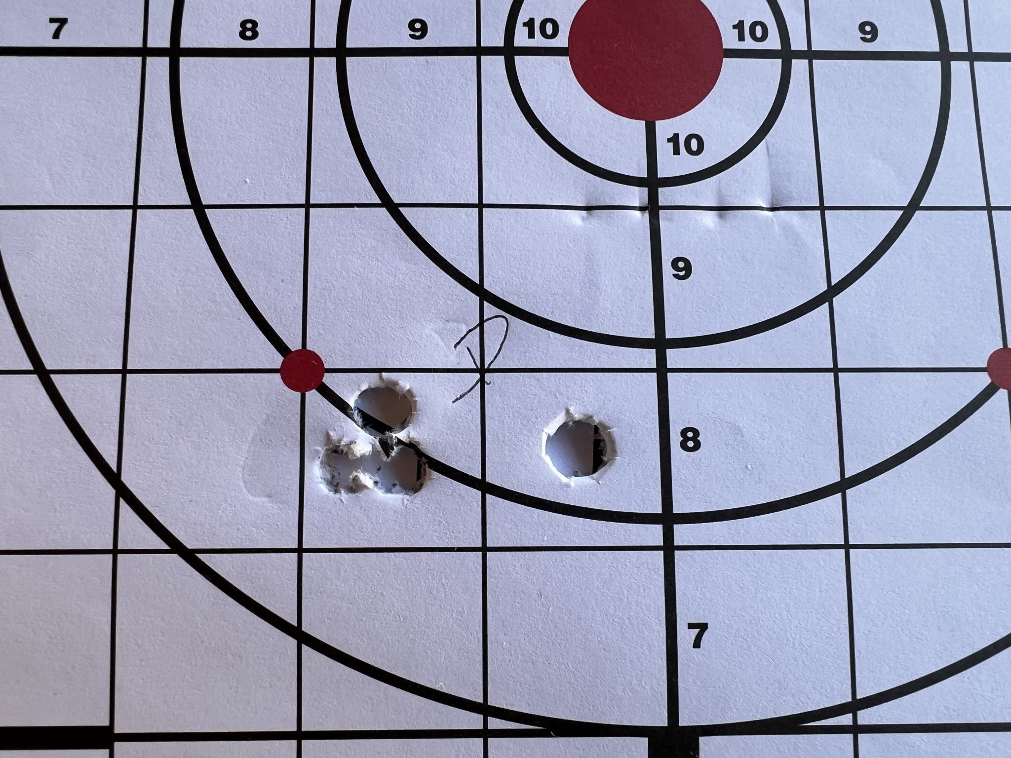

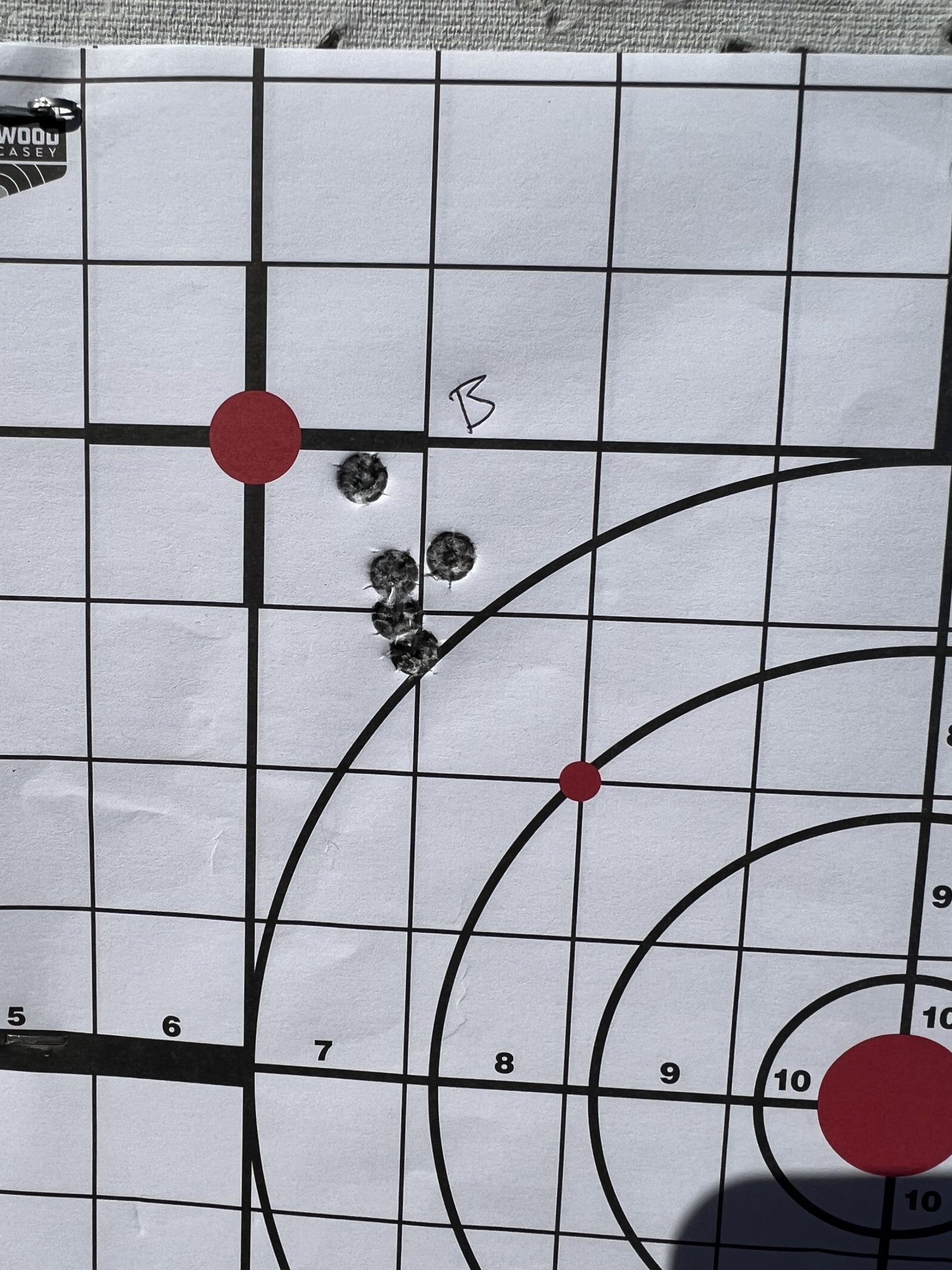

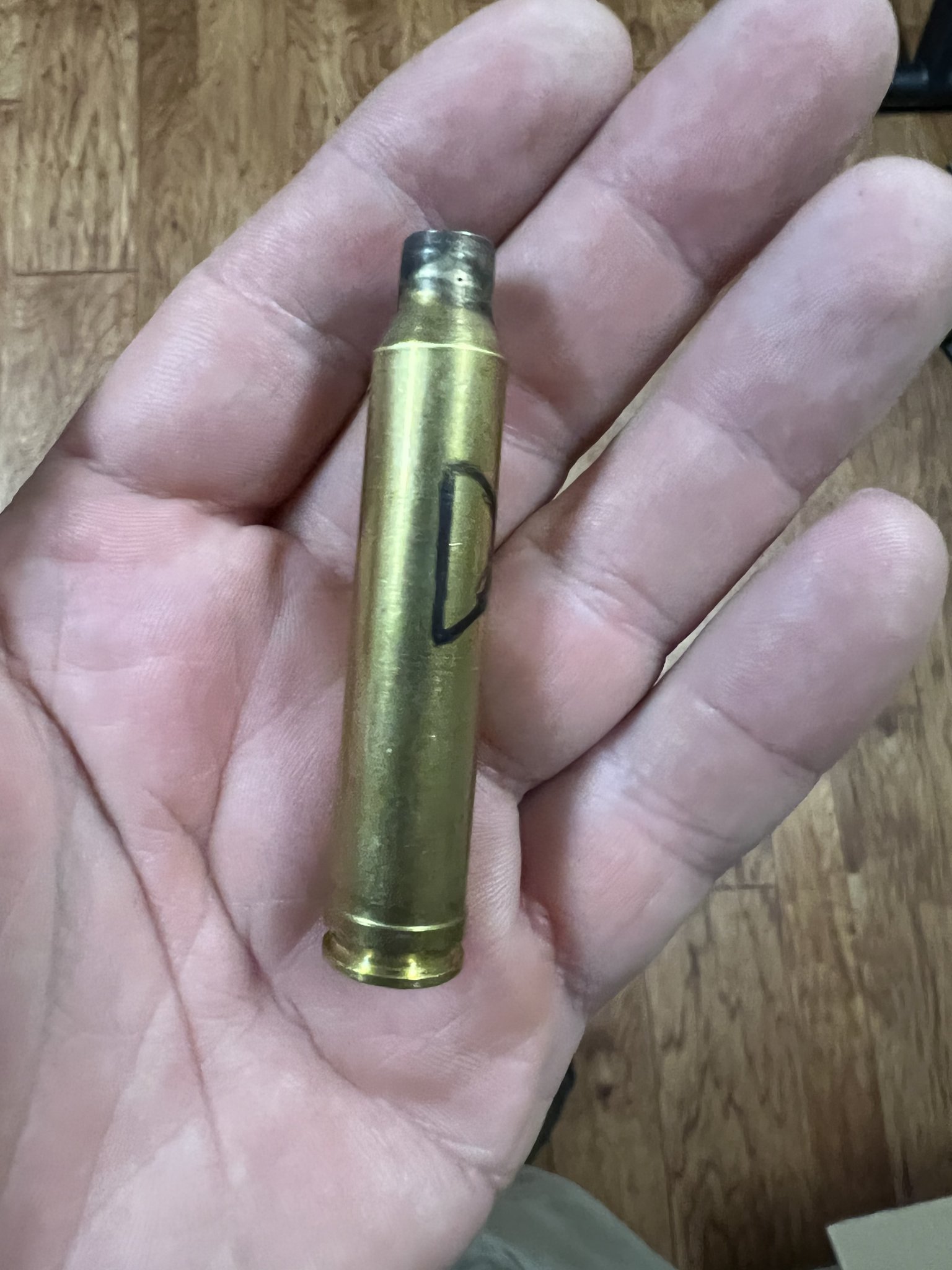

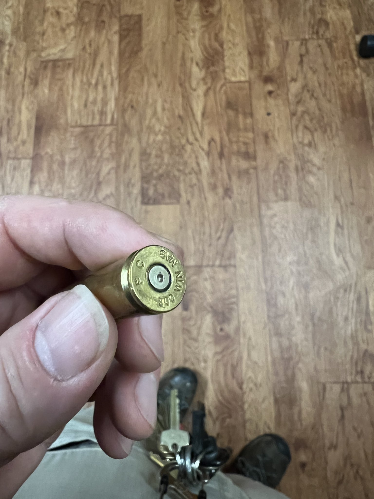

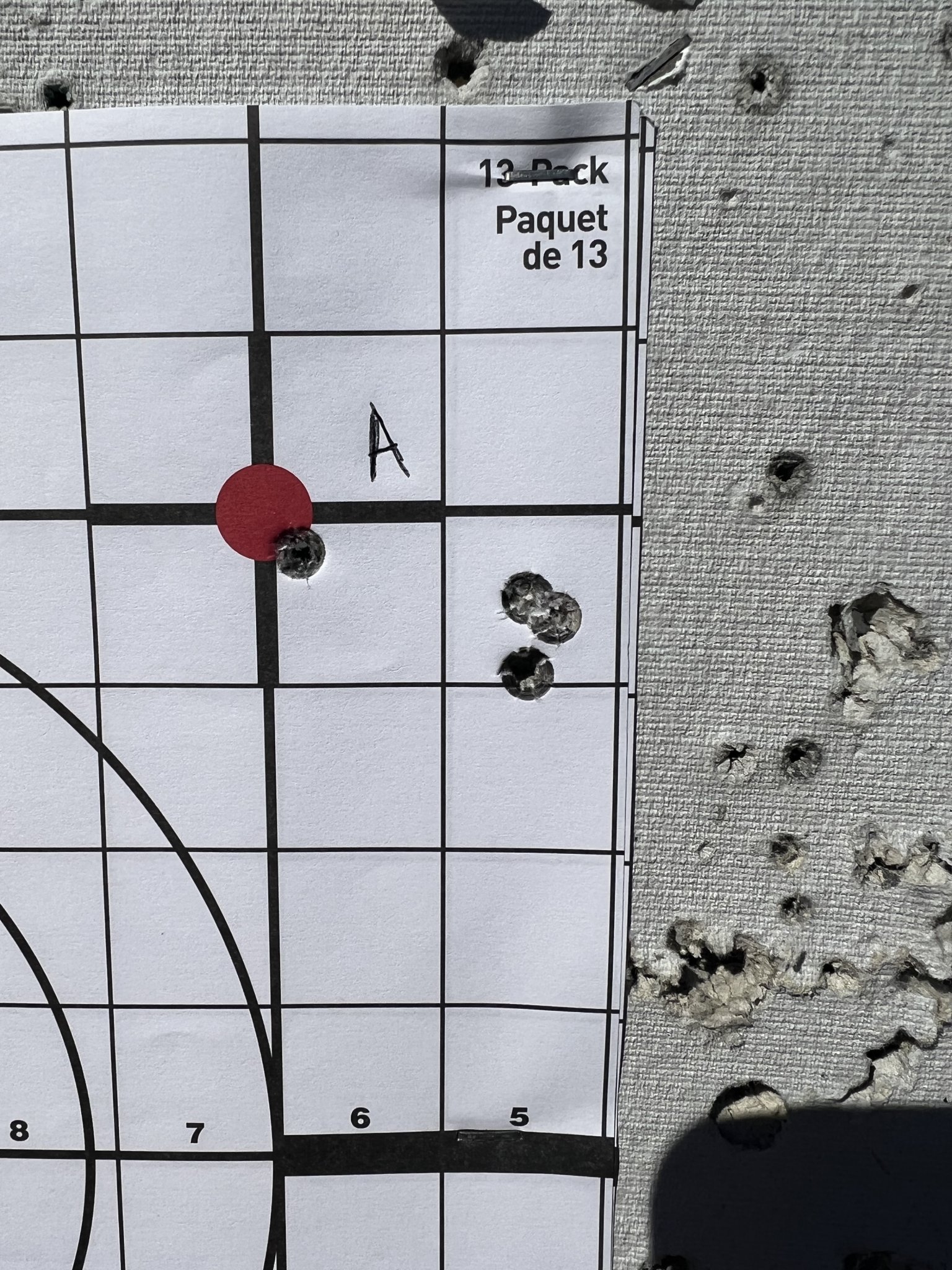

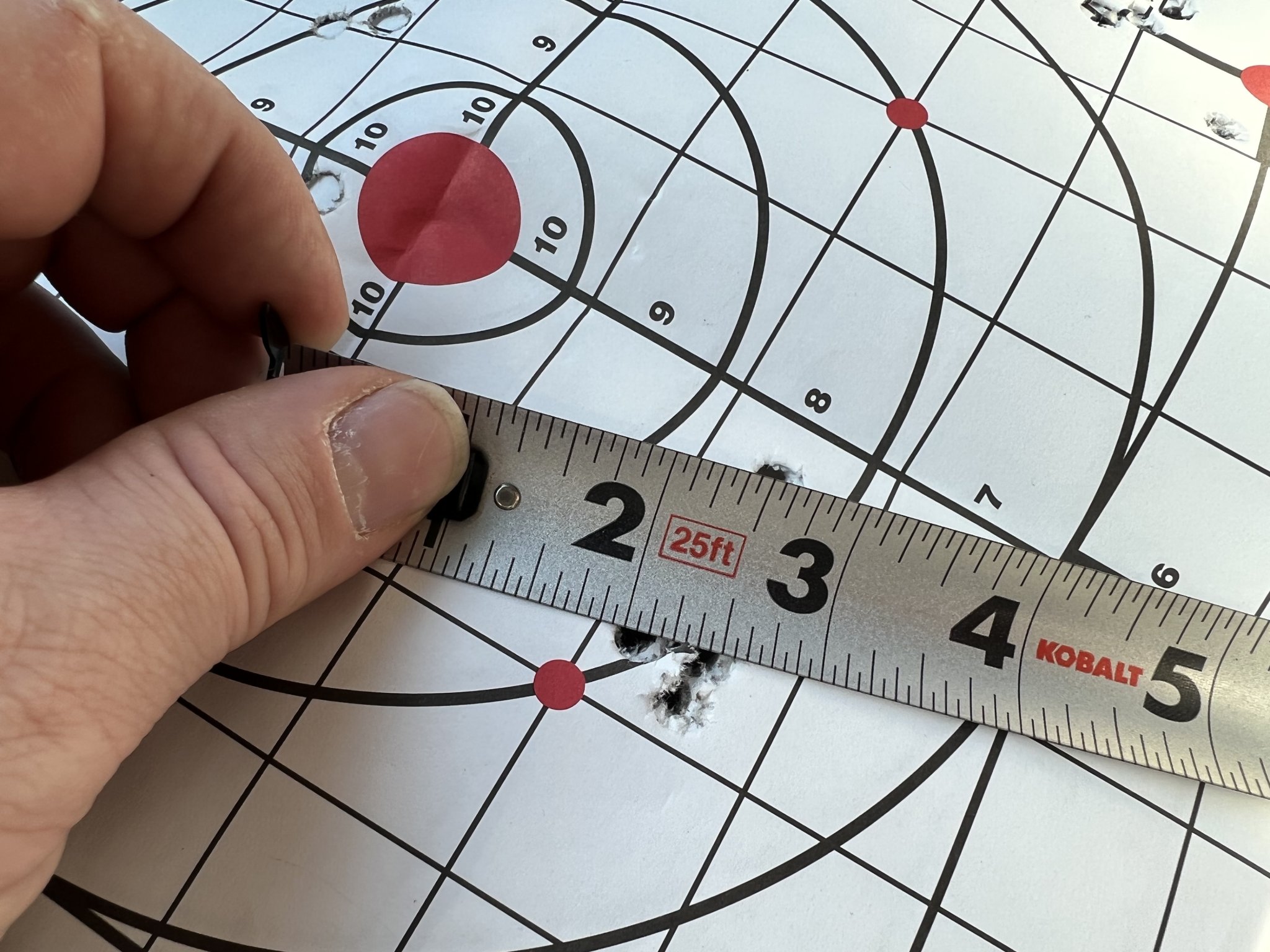

First hand loads through my 300 win mag. Group D was 76.2gr of H1000 under a 220gr ELDX with a federal GM215M primer. Each group was 5 rounds except group A which had a primer fall out of one round. The flyer on D may have been user error as well. Group C was not liked by my rifle and not worth a pic. I also posted this to the reloading subreddit group A was a starting load of 71.3gr of H1000. Ogive measured at 2.830” +/- .001”-.002” @ .030” of the lands. COAL measured at 3.475”.

Nice work. 76.2 must be a magic number for 220ish class bullets...
Mine also likes 76.2 pushing a 225 ELDM.
What brass are you using?
ETA: looked closer and saw the Federal brass.

Ya, once I get the load really dialed in I’m gonna chrono it. I’m figuring I should be somewhere in the ballpark of 2750-2800. Maybe a touch more.
Depending on your barrel length you may be pleasantly surprised...
76.2 gr of H1000 was pushing 225's at an average of 2846 out of my 26" barrel on a 64°F day... I know folks say H1000 is temp stable... And it is MORE temp stable than others. But you'll see a bit of variance with temperature.
You may be up in the 2850-2900 range with 220's... Again, depending on your barrel length.
I'll be interested to see how they chrono. Let us know please.

Ya, mine is a 24” fluted heavy barrel. The rifle is a Savage 110 Tactical. That’s very interesting on your velocity as well. If I hit 2800fps I’d definitely be happy. I had thought about doing the 225ELDM before as well, but withwith loading 220 subs in my 300blk it just makes sense.
