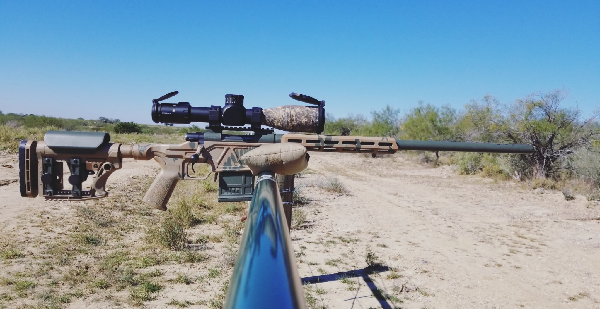

Good to know. Well then, you pretty much have most of it figured out. You are not settling on the Howa. They are amazing shooters. I'll post mine below. I've shot out to 1000 yards with it.
24" 6.5CM
