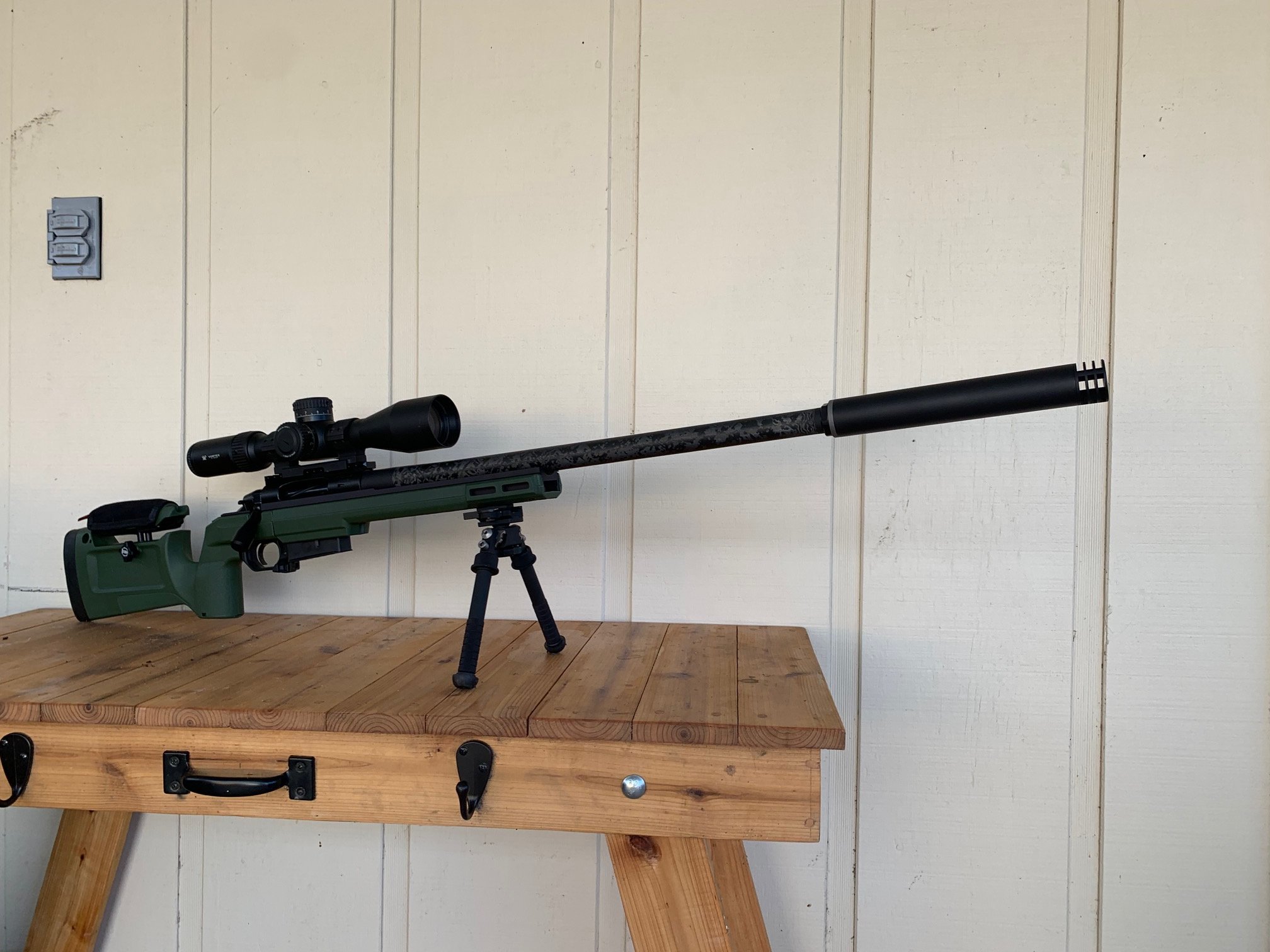

I keep jumping around on which model. I have the cash, and I'm excited to get something new.
I am set on Nightforce, but I need help with real world knowledge from experienced shooters. I don't shoot as much as so many people on here or as much as I used to. I know some people on here can tell the difference between so many scopes, and I can on extreme differences (a Nikon P22 vs Razor G2). The reason I'm set on NF is because of a comment Frank made on a podcast recently, he says, "when in doubt, just buy a Nightforce". And that's where I'm at. I can think of 8 different scopes I would consider buying, and I would probably be happy with any of them, honeslty.
I have a Razor Gen 2, and looking for similar glass, or better. My dad has an older NSX on his rifle, but I don't spend enough time behind the rifles to remember which one is better. No offense.
I do believe in "buy once, cry once", and I don't want to waste money. I do need some help trying to figure out which NF to get and reticle.
Currently leaning toward NX8 4-32x50 F1 in Mil-C
Will mostly be sitting on a Origin with 308 or 6CM barrel in a bravo for punching paper, and might see a hunting trip in the mountains on a TL3 with 65PRC barrel on it. Got a manners on order for next hunting season.
The Razor I have is a 3-18x50 with the Christmas tree reticle. Its heavy too. Its nice, no complaints, and will probably never sell it. Got a Bushnell LRTHi 4-18. Im considering getting the Mil-XT reticle, and considering going to an ATACR if it is "THAT MUCH BETTER". Heard on the Just-Fn Send it podcast the H59 and TRMR is too busy, and that's why I was leaning towards Mil-C. Also, the NX8 has less clicks per rev and lighter. Am I considering too high of magnification?
So, after all that rambling, hopefully I was put you in a vantage spot to shoot advice from (pun intended).
Considering NX8's and ATACR's in F1 Mil configurations. Currently looking at 4-32x50 F1 Mil-C or Mil-XT
Obligatory pix:

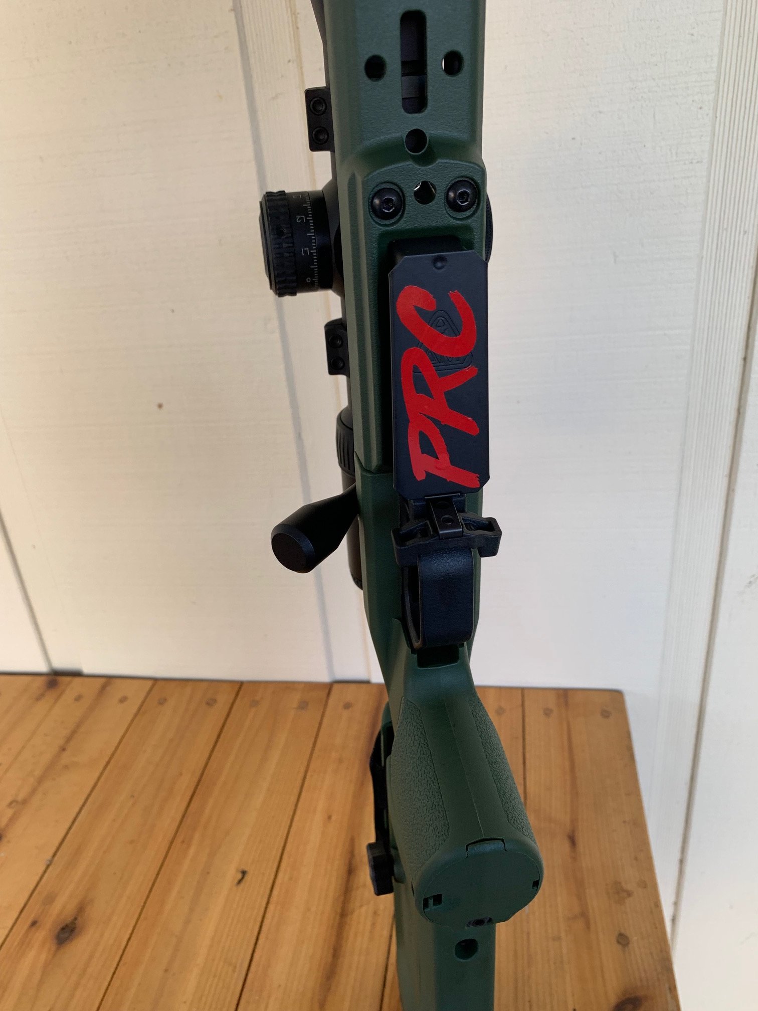

Obligatory pix:
View attachment 7798528View attachment 7798526View attachment 7798527
