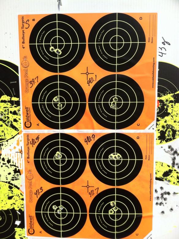

Hello all,
I started the first load test today with my new rifle, and i worked up the test loads using the OCW method. I have only ever used the ladder method, so this is new to me. As stated above, the rifle is a 6.5 Creedmor and here is my data:
(This load came from Hogdon's website)
142 SMK
New FLS and prepped Hornady brass
Hodgdon Hybrid 100V
CCI #200 primers
COAL 2.780"
39.0 - 41.5g
The results aren't quite as clear as when using the ladder method, and this is just the first of many loads I would like to test. I just want to see if these results are common with this OCW test. Any advice will be appreciated. Thanks in advance,
Kevin
I agree with Trail Rider on the smaller increments. Then I'd look for three groups where the center of the groups are very near the same spot. Then make loads in smaller increments until you find the one you're happy with and then fine tune with seating depths. Make sure you shoot your groups in the round robin method and also let the barrel cool between shots.
I was thinking the same thing. I'm messing around with these smk's and hybrid v because like everyone else, I'm having a hard time getting some H4350. This load may have some promise though.
Kevin
Personally Id use RE17, just bought yet another pound just north of here today while at Ciminos gunshop, plenty in stock and would shoot faster than pretty much any powder you could try. Course Ill be using it in my 6 Creedmoor.
Kevin,
Try starting with 40.3grs to 41.2grs. Maybe try it in .2 or .3grs increments, to really find that sweet spot. Then fine tune with seating depth; please post your results.

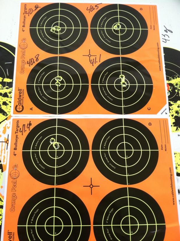

I worked up five more sets of three in .3gr increments from 40.2 - 41.4 and shot them today. Here is a pic of the results. I feel like it was a good test, but I did feel like I jerked slightly on the third shot of the 40.8 target. It's pretty funny that the shot ended up dead bullseye too. What do you make of this test? The first two shots of the 40.8 were almost in the same hole.
Kevin
Kevin,
Question is, what do you think? Wow, I have to say you did a great job on the ocw test. You have a great shooting setup. So I would say the test corroborated your ocw. Remember this is my pick as ocw charge (40.5grs) dead center of node. You can fine tune COL, but since its shooting so well I would test it at least at 300 yards if you can. Once you find what you like, load a bunch and go have man. Great job!;)
I would also go with 40.5 grs. Don't think I would even waste time playing with seating depth as you don't have much to gain from it. Load up a bunch of rounds and just start shooting already.
Thanks for the comments, and the replies. I think it's a good test, and the results seem easy to deal with. I'm going to have another go at the 40.8 and the 40.5 with the same COL, but I'm going to stretch it out this time out to 600 yards. I'll post my results with that test also. I'm thinking the 40.5 is going to be the load though with this powder and bullet combo.
