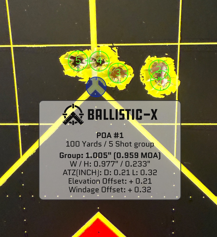

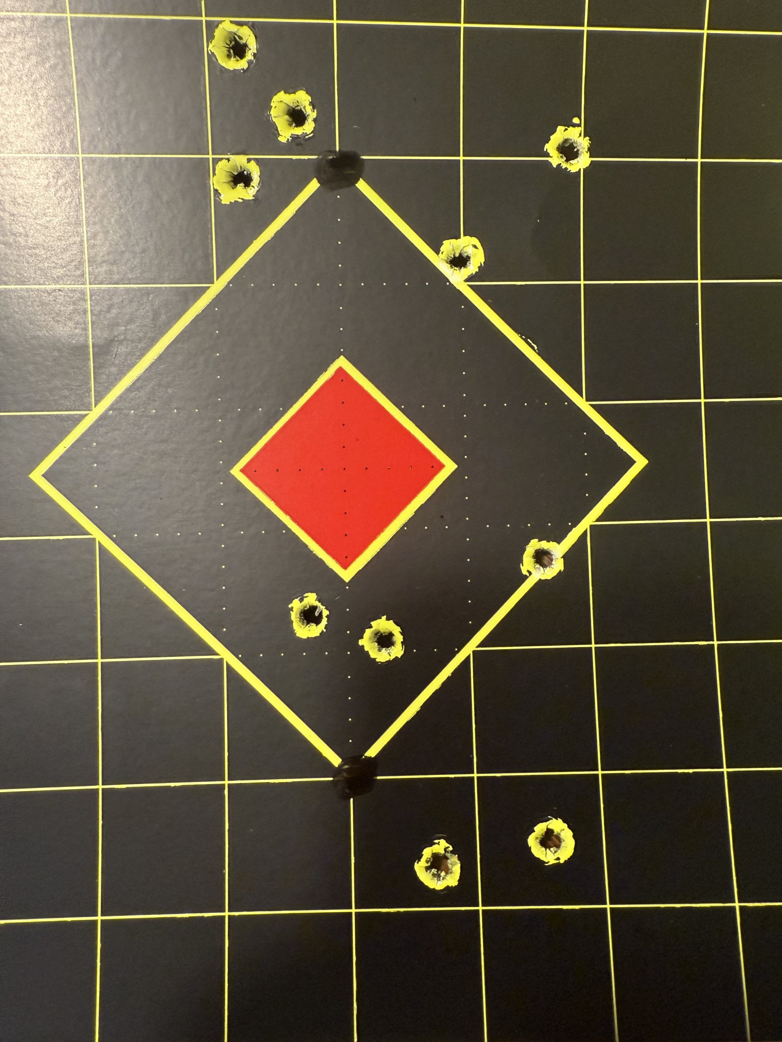

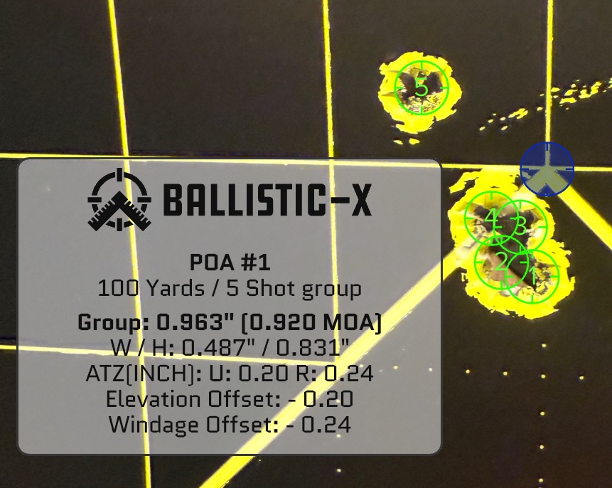

Got it out for a second trip today. I learned that I have never had a rifle hate an ammo as much as my 6arc hates Hornady 105gr Black...

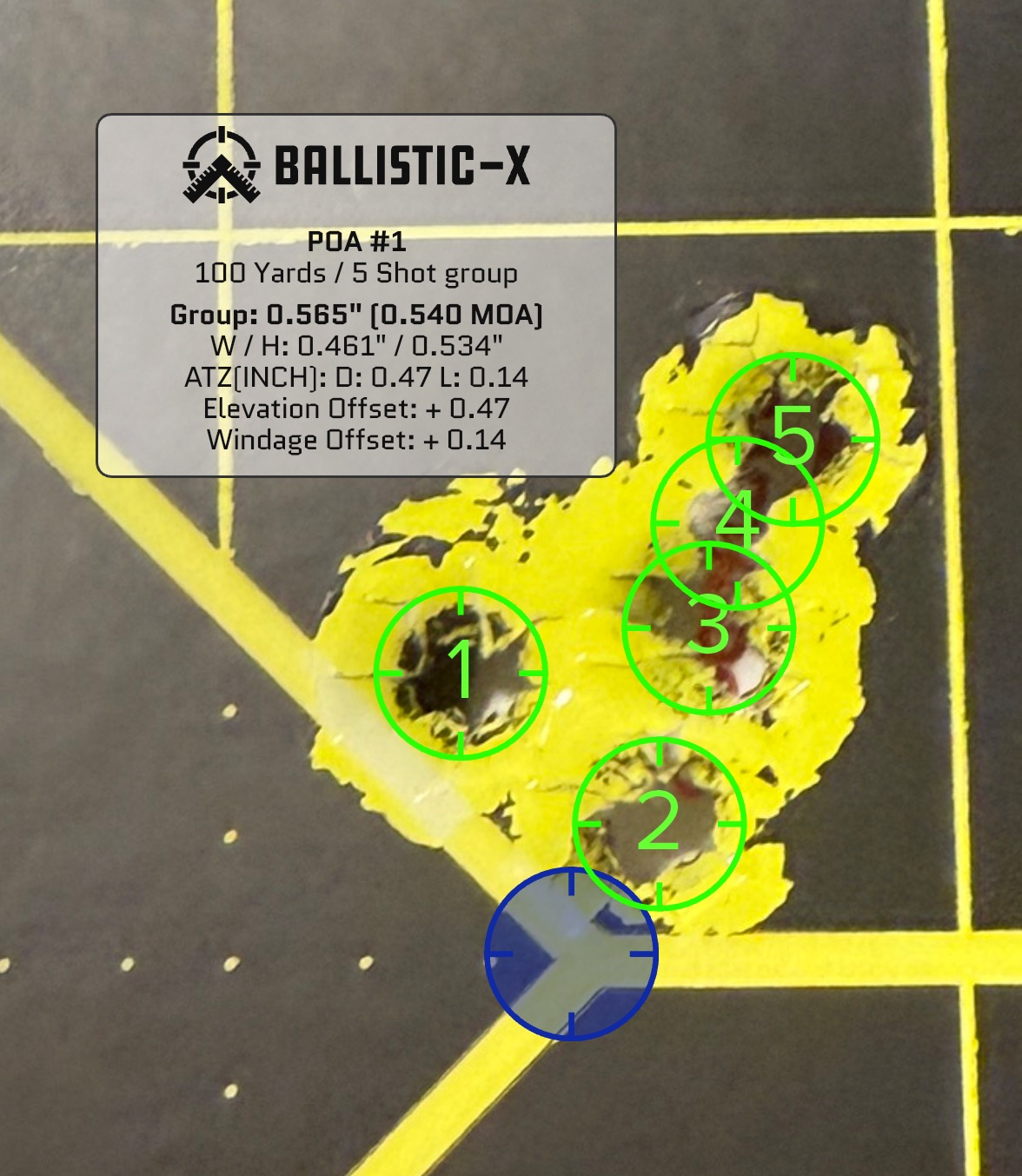

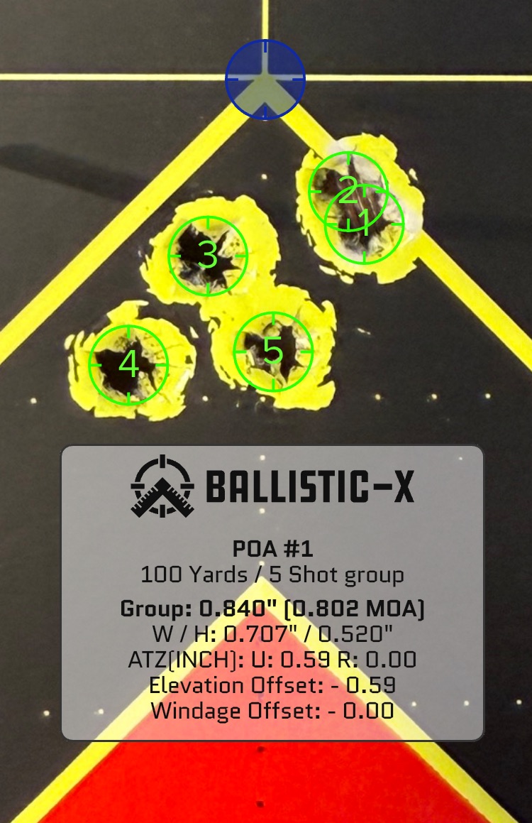

Going back to the 108gr ELDM it shot 3 out 5 groups sub MOA and one being a real nice sub .6MOA...
This one was going to be real nice until I choked the 5th.
I honestly could not believe how bad it shot. I was shooting ELDM, switched to the Black and thought something broke. Fed it ELDMs again and it was back to sub MOA.
That's crazy, I've had really good results In my Paul Ross Bartlein, 105 Black is averaging .5 MOA out of the Gate. I've only got 30rds down the tube but I'm going to try the 108's and 80 VT next.
I was really surprised, but shooting the 108gr before and after I don't know what else to think other than my barrel just hates them...lol

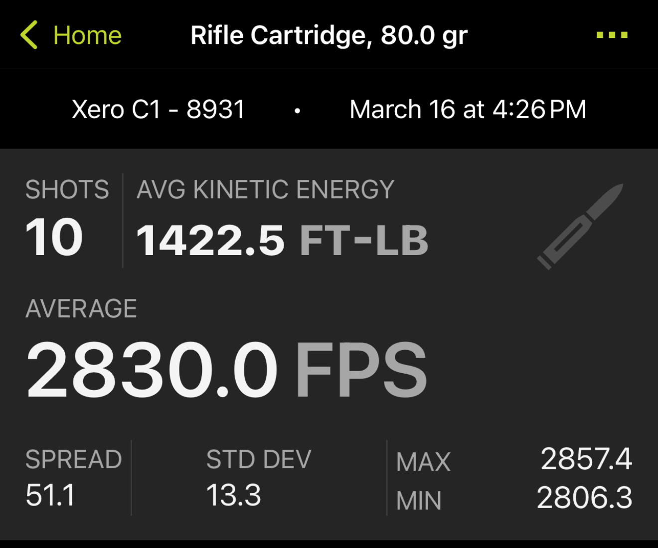

Got a chance to shoot some 80gr V-Match today. The rifle seemed to like them as much as it likes the 108gr ELDMs. It was really windy but still shot 4 out of 6 groups sub MOA. Next time I am out and winds are calm, I'll shoot the V-Match and ELDMs and see which one is tightest. This was the tightest today, but on a calm day I am pretty sure it could do better.
Reactions: Earnhardt
