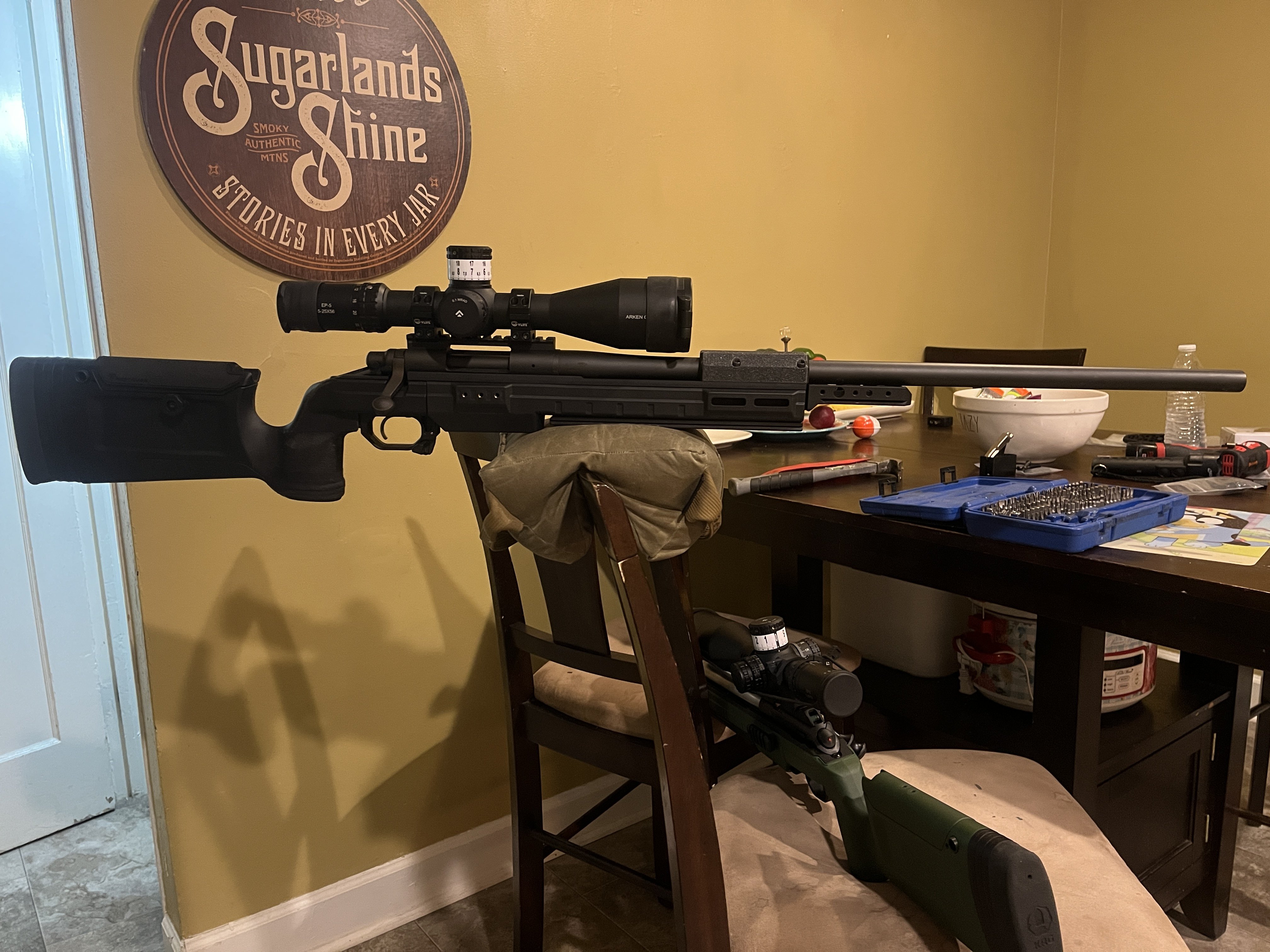

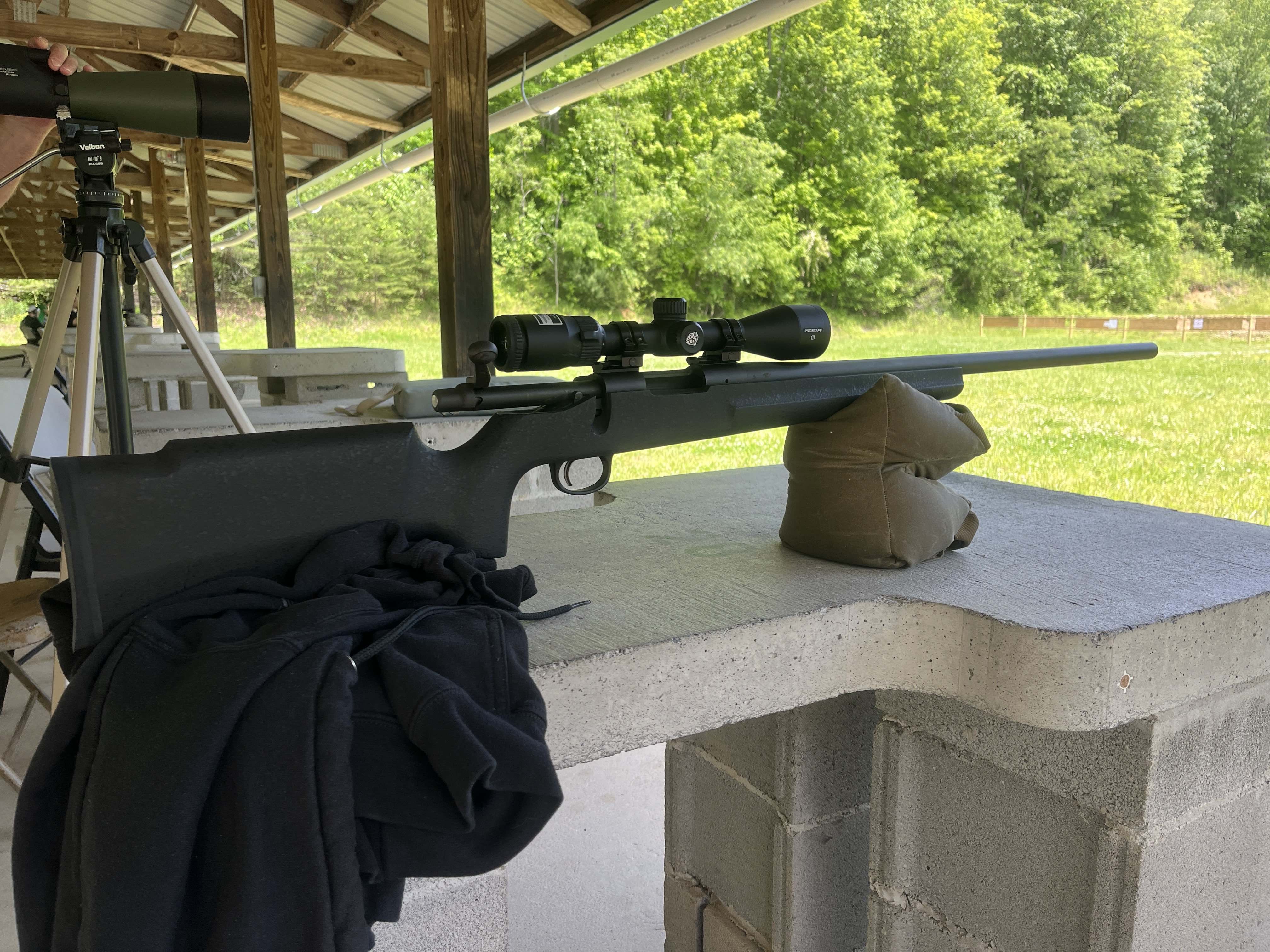

I might be answering my own question but here we go..
I mostly shoot rimfire for the fun of it and NRL/PRS match when I can. I’ve Been wanting to build a centerfire rifle for awhile now and ran across a barely used Remington 700 .308 25?inch barrel in a Boyd stock and a Nikon hunting scope for 500$ “RR” in the serial from what I’ve gathered it’s a pre 2020 700..
I have a range that goes to 1100yards and would like to eventually to shoot there.
That being said am I wasting time having the action blueprinted and rebarreled along with chassis etc? Or just buy a custom action and build a 6GT and keep the .308 put a middle of road scope and triggertech for playin around with?

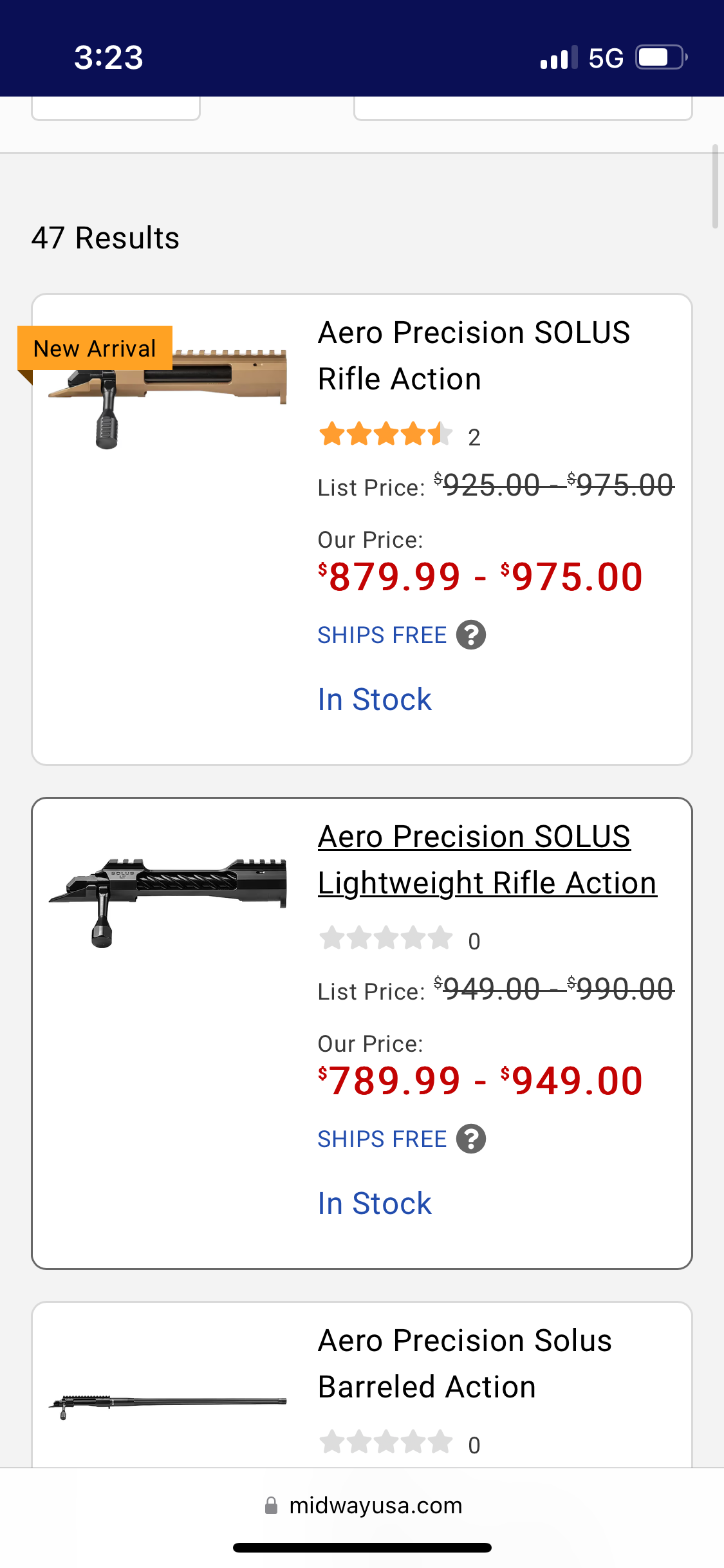

500 for essentially an action with your plans vs an aero solus for 700
I don’t like aero personally but that’s not even a decision, get the aero.

Oh for sure, I already sold the scope and givin the boyd to a buddy of mine.

I have no issue keeping it as a .308 throwin it in a bravo stock, triggertech special and middle of road scope and throwing it in the safe and focus more on a custom build also. I just don’t wanna waste my time and money having all this stuff done a factory 700 action if the end result isn’t worth it
Makes sense. I’d probably keep the whole gun since I sold scope I’ve got 360$ in it might as well keep it for that price.

Where finding a solus for 700? 👀👀
The better question is where are you finding a Solus, period.
I have nothing against Aero, and I have actually wanted to pick up a Solus, but it appears they are a sinking ship.
Unless there have been very recent changes, they have not been delivering products for months now.
