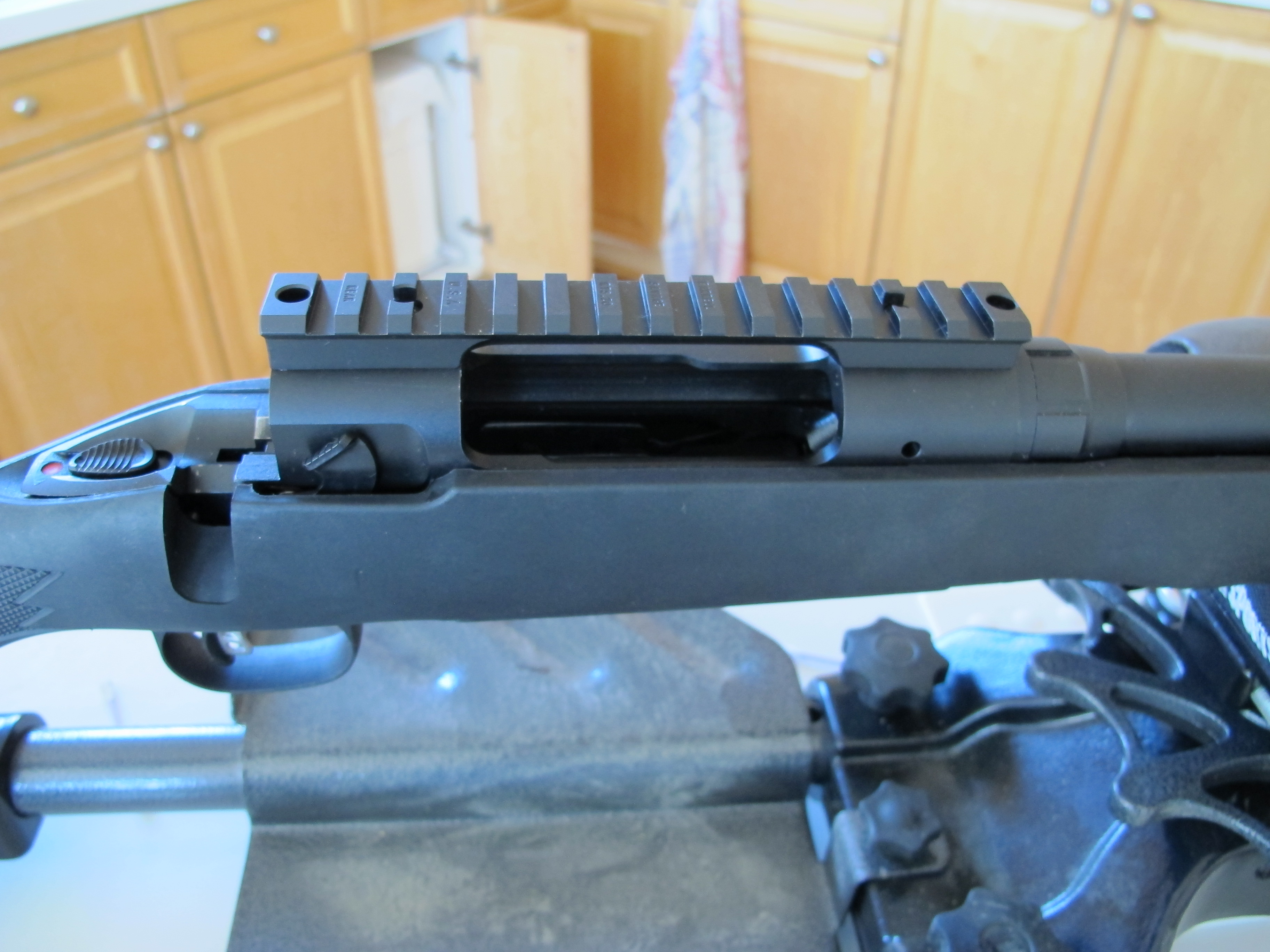

I just put a base on my 10 FCP myself. I went with a Ken Farrell steel 20 MOA for Savage SA. Fit really well, did not need bedding. It is a little heavy, but for my use the extra weight is negligible.
As for rings, I had good luck with TPS rings for my 1" scopes. Nice fit and finish with many options for height.

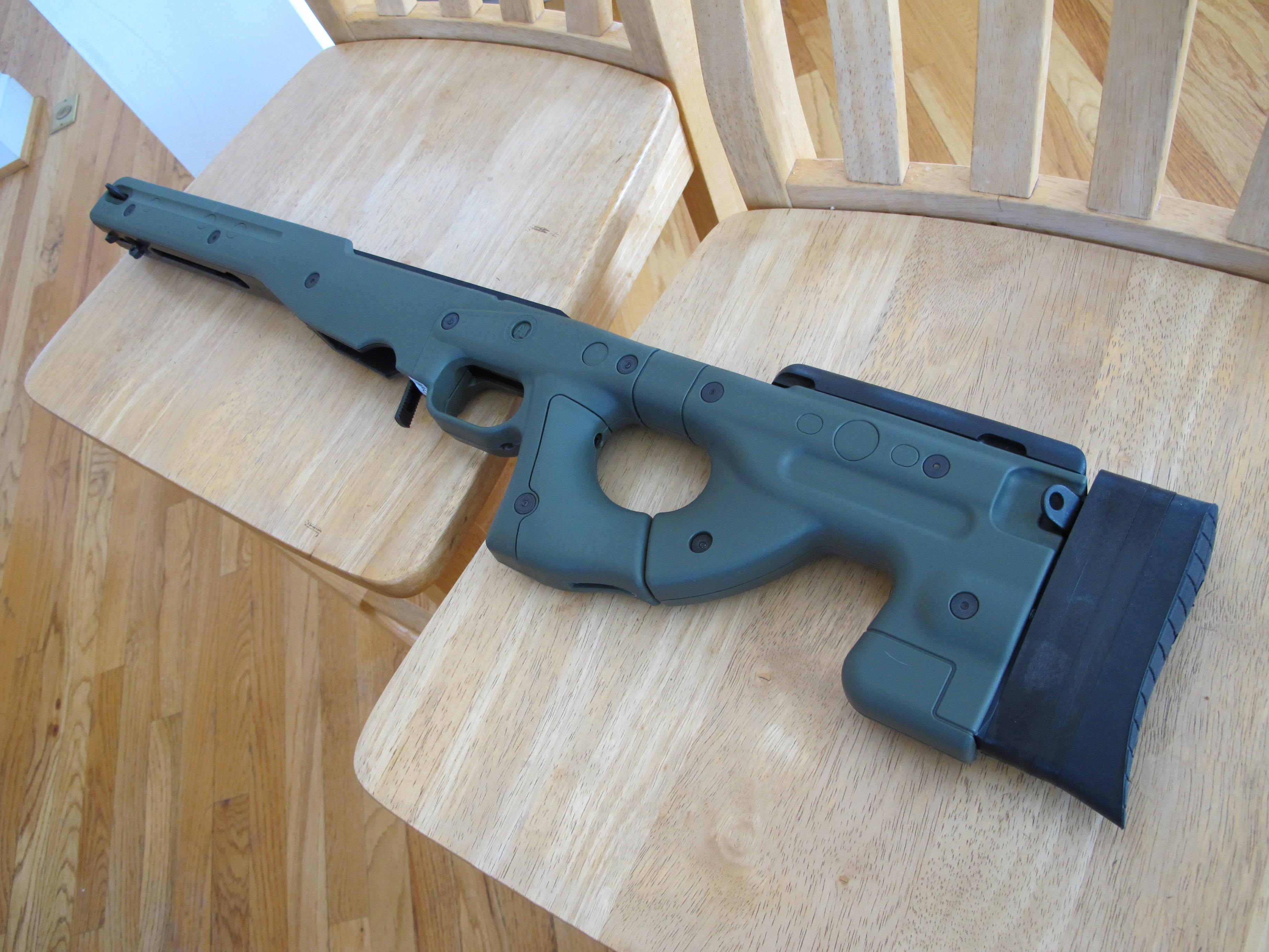

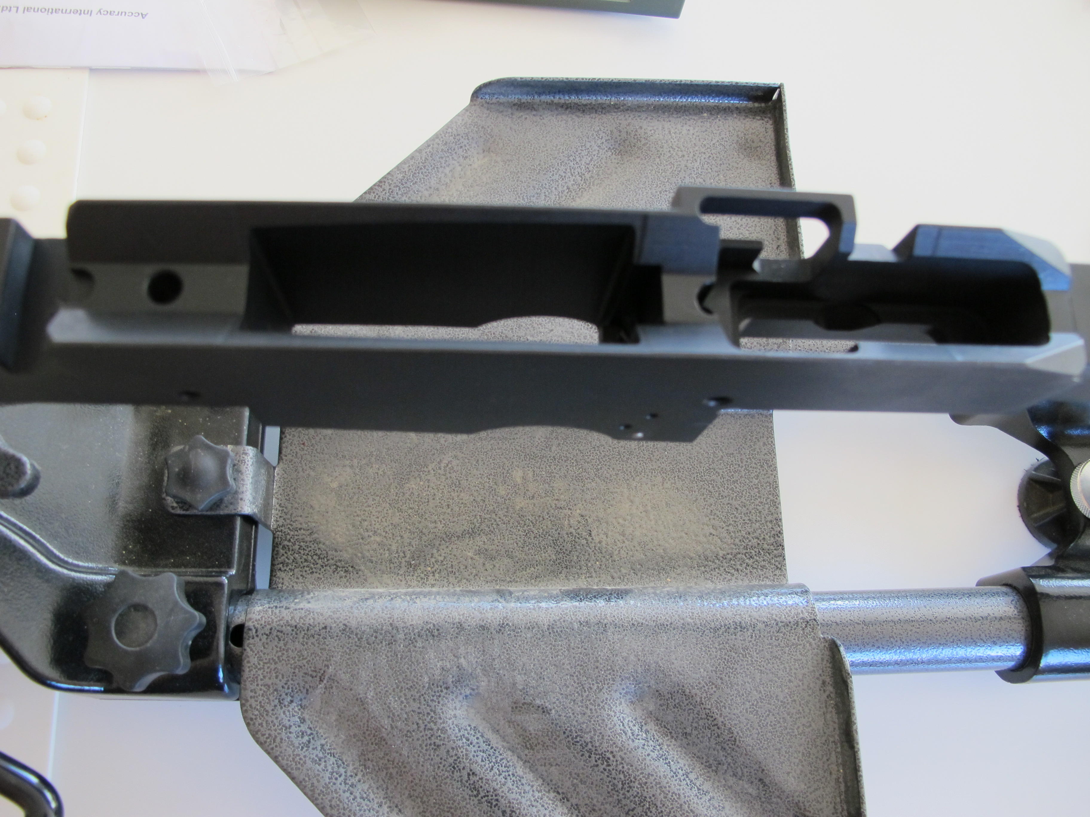

Good to hear that someone else address the height issue with a new stock. I went down that path as well. However, instead of a McMillan, I went with an AICS 1.5 for savage (the Aston Martin of replacement stocks I suppose.) The comb and LOP adjustments are nice, but what sold me was the aluminum v-block. I'm also a fan of the thumb-hole.
In retrospect, lower rings would have also fixed the height problem...
