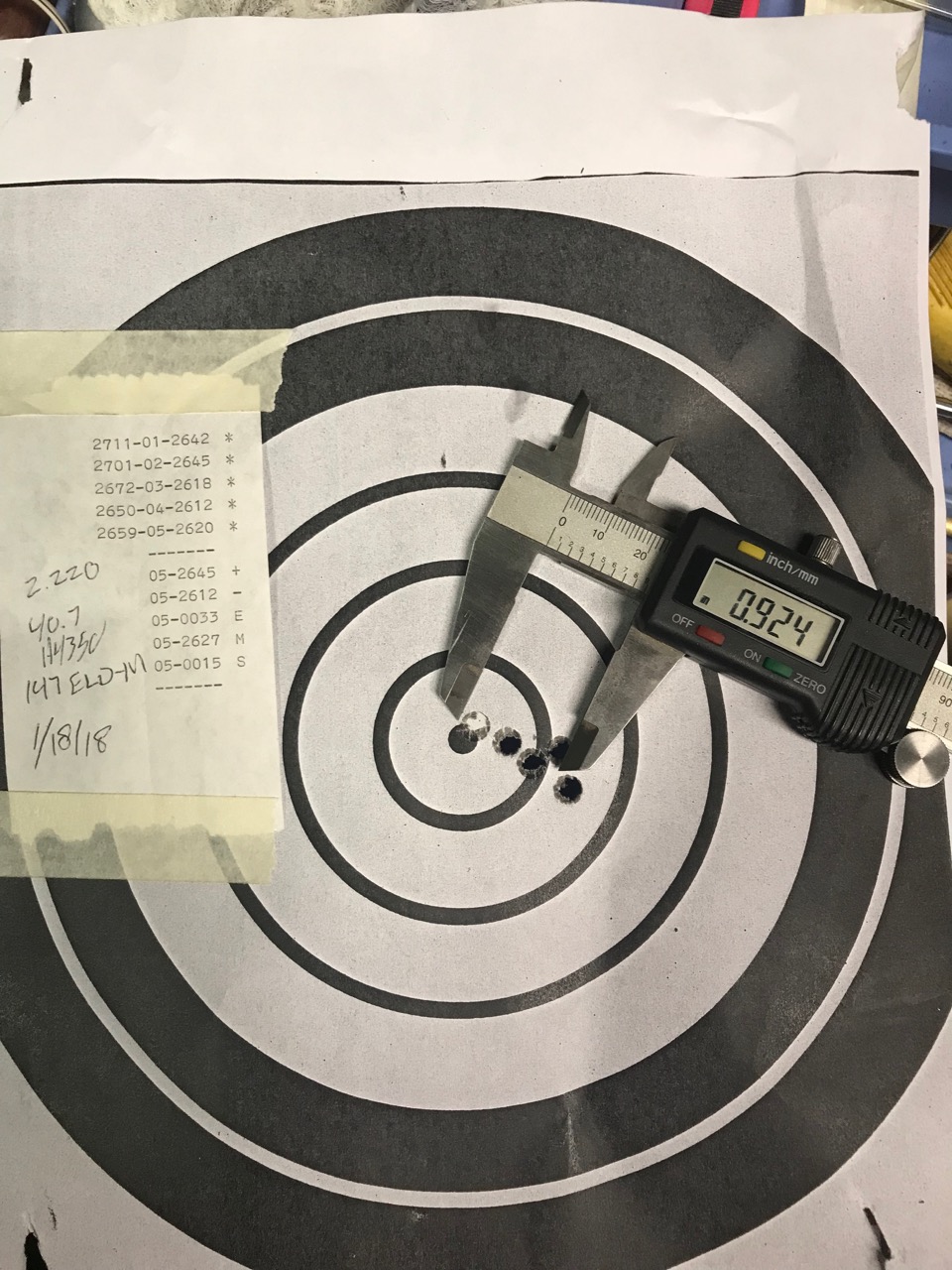

So I was out verifying group size and velocity today out of my 10ba stealth. I had previously done some load work up and found a load that shoots about 1” at 100 yds. Today when I was shooting groups, I would have the first round hit 1.5” high, and then the rest into 0.5”. The chrono data did not give any reason as to why the first round was so high. My SD was single digits. My first suspicion was the action screws working loose a touch, but they were not loose. Next thought was the scope/ rings, but the rings were tight. It is possible the scope took a dive, I don’t have another one currently that I can swap; working on getting an LRTSi to put on it. I have a Leupold 1-4 because that’s all I have. I don’t think it’s my body positioning/mechanics, I am doing the same things I did for the 1” group.
Any other suggestions other than the scope going TU? I would think I wouldn’t be able to put the other four shots into the same hole if it was the scope.
What was the interval between groups time wise.
Did you shoot the first round from a clean cold barrel? And have a flier
And after shooting did the rifle settle down, or did it throw a shot high randomly.
3 or 5 shoot groups.
5 shot groups. I would walk down to the targets between groups. So, 2 minutes max? Not really letting it cool down. It would do the same thing after each mag change. Didn’t clean between. I shot 5 groups and they all did this.

The part about this that puzzles me is that I did things the same as when I did my load development initially, and shot this group:
~0.5" vertical spread with an ES of 33. Same load I shot yesterday.
