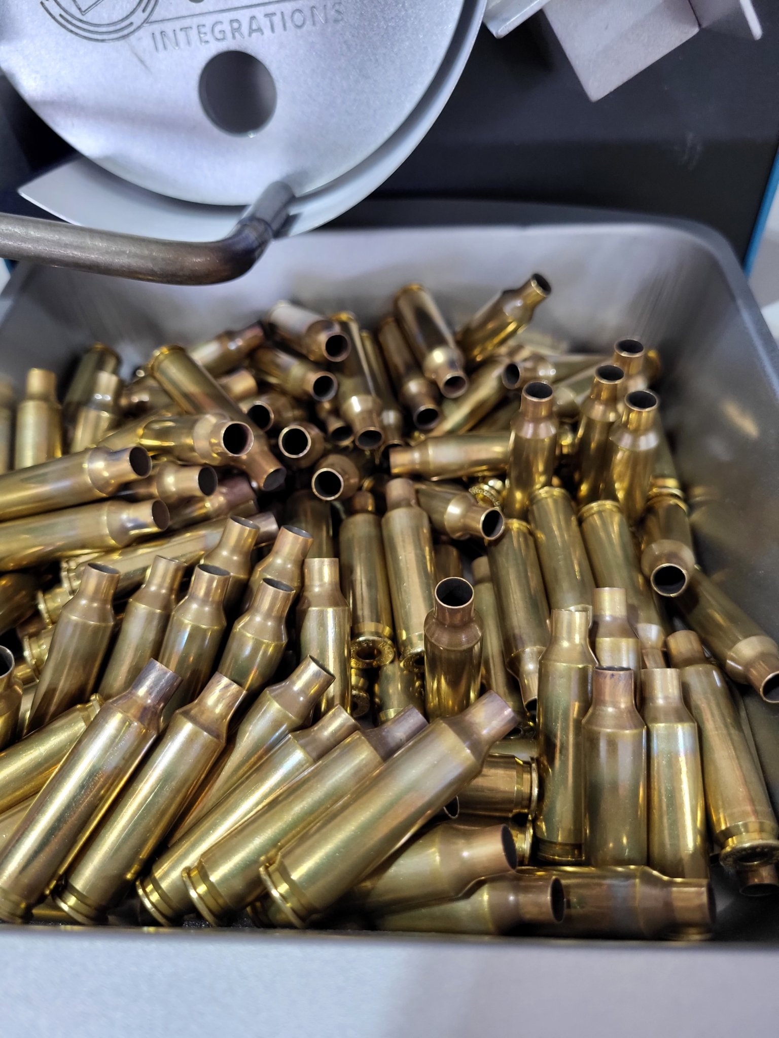

First time using an EP integrations annealer. This 6.5 CM brass has close to 10 firings on it (140gr burger, h4350, @~2700fps). In the past I would send batches to a memeber on here that would anneal for us. Probably every 2-3 firings.
Setup: propane torch tip was set back from brass so there was a gap, and the flame tip was not in contact with the brass. "Rotation time" was set at 22- 24, so the brass would drop as the neck just started to glow and an orange flame would start (impurities?)
Some of the cases have dark spots around the neck. Would this be considered over annealed and not safe to fire?

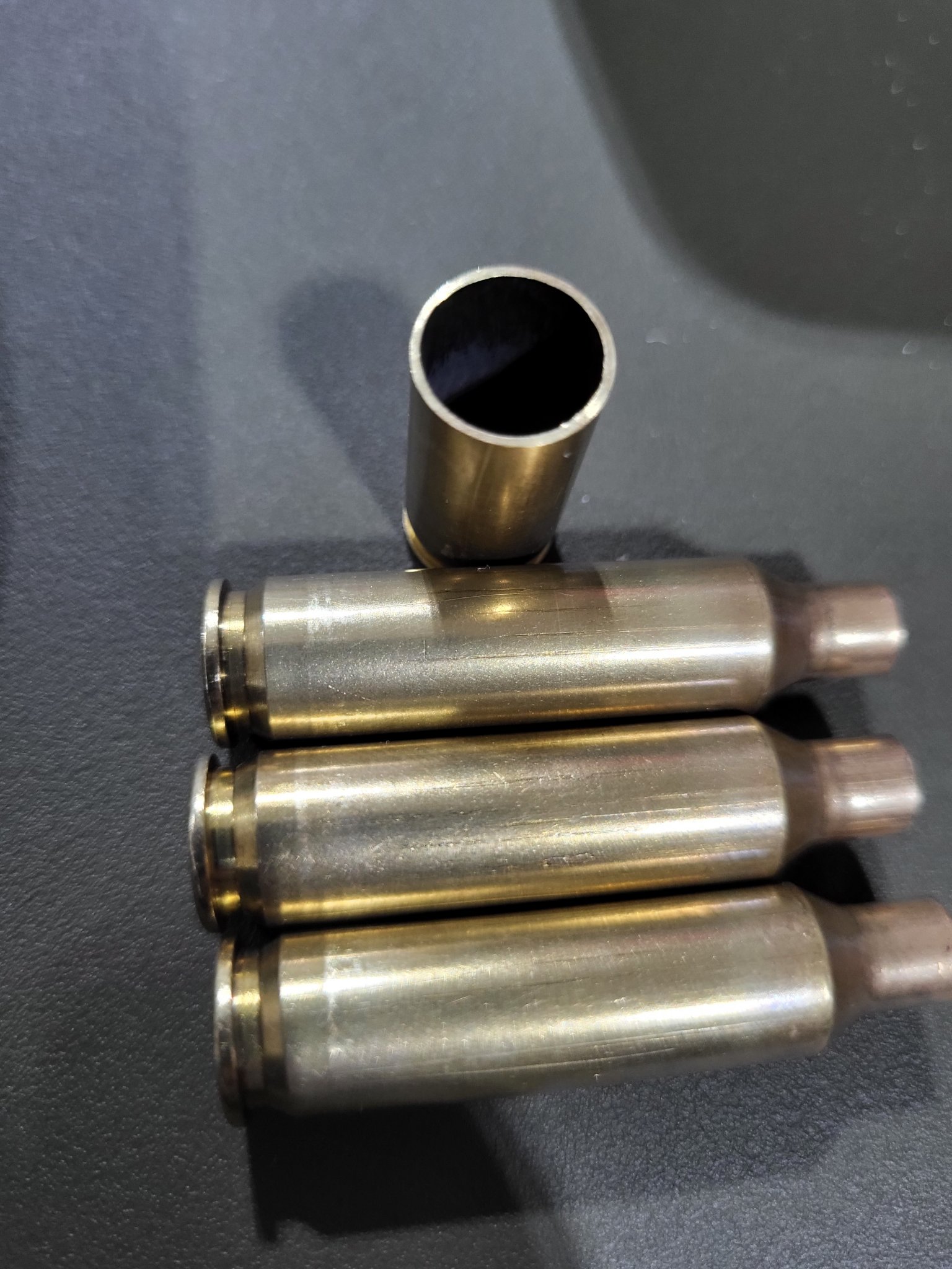

Since these have so many firings, i closely inspected the necks for cracks, and used the tip of a paper clip to check for internal seperation near the case head. You can see lots of scratches on the case body, so i parted one in the lathe to see wall thickness at the location of these cracks. Seems there is plenty of wall, and these are surface scratches from the dusty match I shot Saturday.
Scratches are likely from your mags feed lips.
I wouldnt worry about the color, a bit of 0000 steel wool and theyll shine right back up like new. They arent getting stuck in the wheel and stop rotating are they?

Not these 6.5, but the batch of308 from my AR 10 had some sticking. So i stopped until i can figure that out. Assumed its from the ejector marks. There is a little burr.

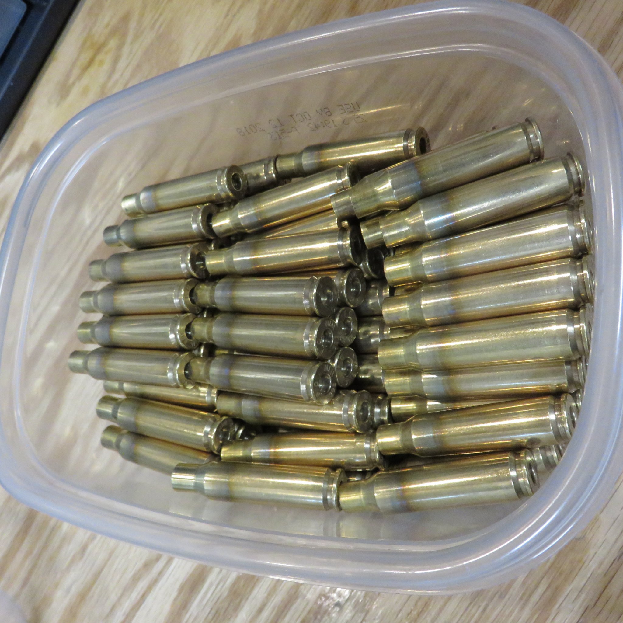

Sounds and looks like you're doing you're annealing just fine. That "starting to glow" method is what I've done for many years and it works well for determining how long to leave your brass in the flame. The actual time interval isn't really important, except you want to heat to that glowing point (as seen in a dark room) as quickly as possible to minimize the heat transference to the lower part of the case body. As far as those few with the "dark spots around the neck", that could be due to a lack of consistent rotation while in the flame (I think that's why spife7980 was asking about them getting stuck in the wheel).
I don't clean my cases until after annealing, as I want to remove that abrasive oxide layer that the annealing process leaves behind so that it doesn't wear on my sizing dies. Typically, I'll just use some steel wool on the necks and shoulders with just a few twists on each before sizing. I seldom do more than 100 at a time, so cleaning this way is not big deal. Otherwise, I'd tumble them before sizing.

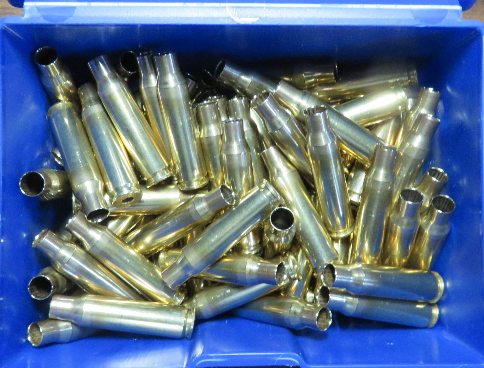

After sizing and dry tumbling with rice to remove the lube, I use an expander mandrel to set my neck tension and lastly, 3-way trim to a uniform case length. They end up looking like this:

Nothing in the pics indicate anything wrong. The dark spots is from crap on the brass.
