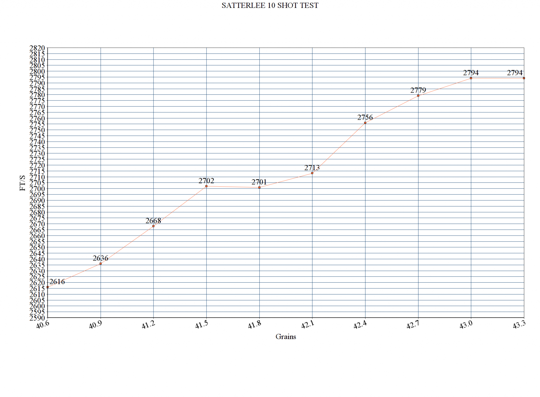

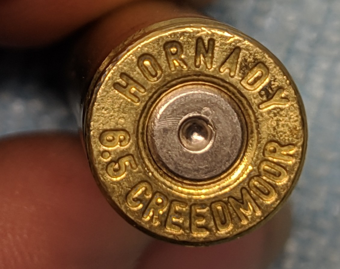

I just completed my first ever 10 shot Satterlee load development for my Ruger RPR. I am using once fired Hornady brass, Hornady match 140 bthp H4350, CCI BR-2 primers. All brass trimmed to 1.915 with a 2.240 CBTO. I have 2 nodes going on with no real signs of pressure the 43g load has a very faint primer crater. If anyone can give me some insight I'd appreciate it since I'm learning along the way. Thank you all.

I had a node at 41.8gn of H4350 @ 2650 fps out of a 22" barrel with 147 and 143gn ELD-M/X loads, but I destroyed my Hornady brass primer pockets doing it. It worked fine for 3-4 firings and then primers started falling out when chambering / ejecting brass. I switched to Lapua. Might want to try some small primer pocket brass (Lapua or Starline) before that happens to you.
I've shot out 2 factory rpr barrels, they were great factory barrels. My load was 41.5 to 41.7 h4350 with 140 eldm. That 43 grain load might get you into trouble when it warms up. Good luck.
Shoot them at 200 or better 300. If one or both shoot good load em and shoot em. I only use my magneto to check speed ES, SD after I find a load. Dont get caught up in numbers you'll just waste components. Ask me how I know.?
Reload to shoot, not shoot to Reload..... I found out the same way you did!
Reactions: Bender and abn31c
I’d shoot 3 rounds(maybe 5) of 41.5, 41.7, 41.9, and 42.1. Then pick the one with the best sd/es then adjust group size by fiddling with seating depth. Or just buy prime ammo.
Op is shooting 140 grain bullets. Sd/es can largely be controlled by one's reloading process and primer selection.
I would go shoot a real test, with more than 1 data point per charge and a target to tell me where the bullets hit. Especially if I was brand new to reloading. By happen stance, there is a "flat spot" right where there is a well known node though. Should be right around 41.6. Could use that and run an OAL test.
Reactions: Bender
I just completed my first ever 10 shot Satterlee load development for my Ruger RPR. I am using once fired Hornady brass, Hornady match 140 bthp H4350, CCI BR-2 primers. All brass trimmed to 1.915 with a 2.240 CBTO. I have 2 nodes going on with no real signs of pressure the 43g load has a very faint primer crater. If anyone can give me some insight I'd appreciate it since I'm learning along the way. Thank you all.View attachment 7040307
Repeat the test in 0.2 grain increments from 41 42 grains.
Do a .2 ladder at distance. Find your middle spot. Shoot 2 or 3 loads for 3 round groups at distance. Look for the smallest vertical spread. I don't think 100 yards tells the whole story.
I have an RPR too and it 'likes' MV of around 2700-ish and shoots nice groups ( 1" or under at 100) there, or an MV a tad under). I get that with 41.5 gn of H4350. 140 Hs and 142 Sierras. 2.80-2.81 COAL. It's not fussie. Made hits on steel at 300 and over. The charge is under book max, so no pressure problems and not burning up my barrel prematurely. Good enough for me. I don't need to reinvent the wheel. I'd stay with your node at 41.6. Good luck :)
