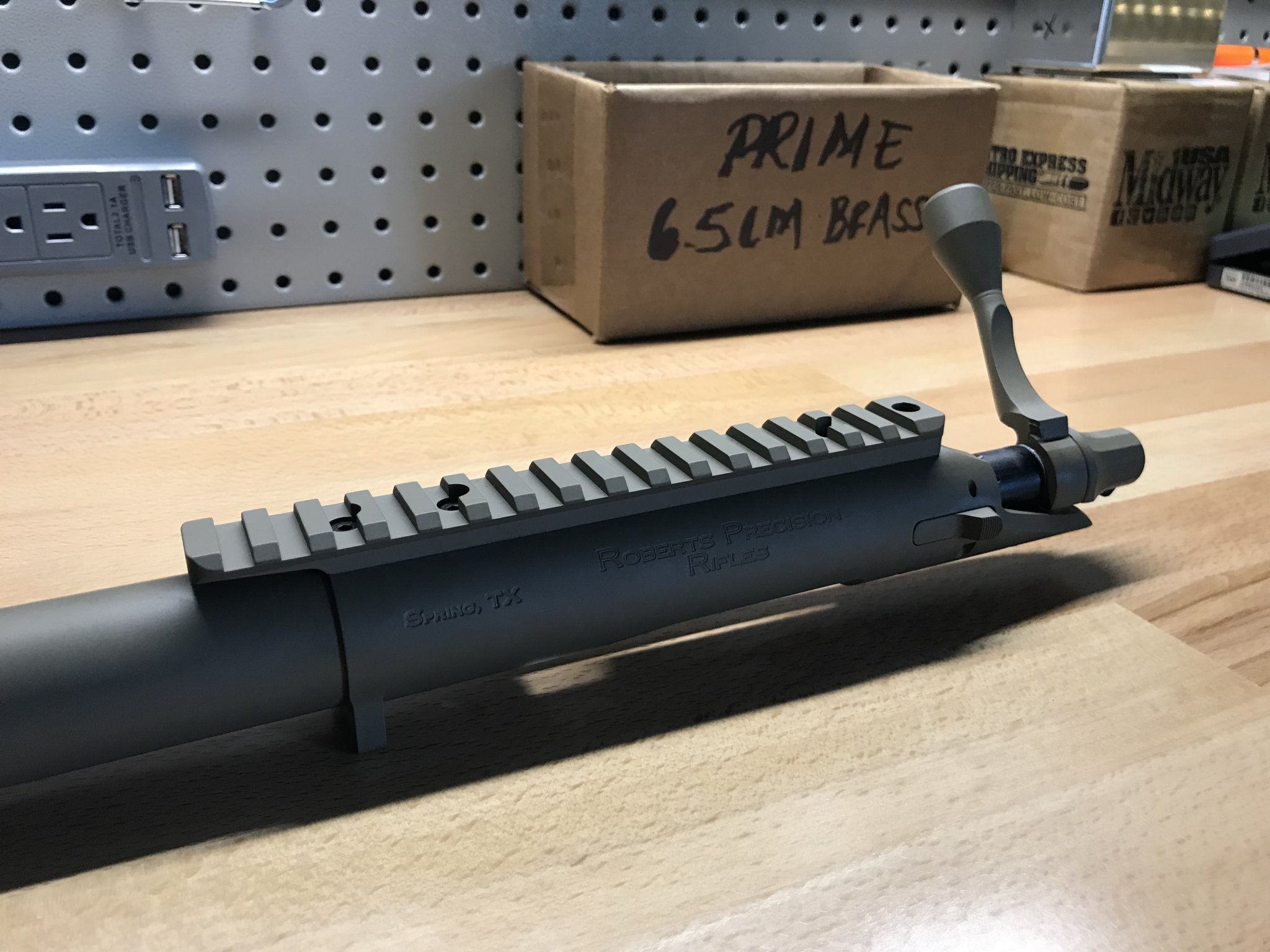

I actually just picked up my 1st ever custom action, short action Rebel. Had a talk with my smith about push feed vs CRF before the build and ended up going with PRF. Not only will it save you money, but the push style has proven itself out there to be a good reliable system. I'd say is very much a preference thing.
