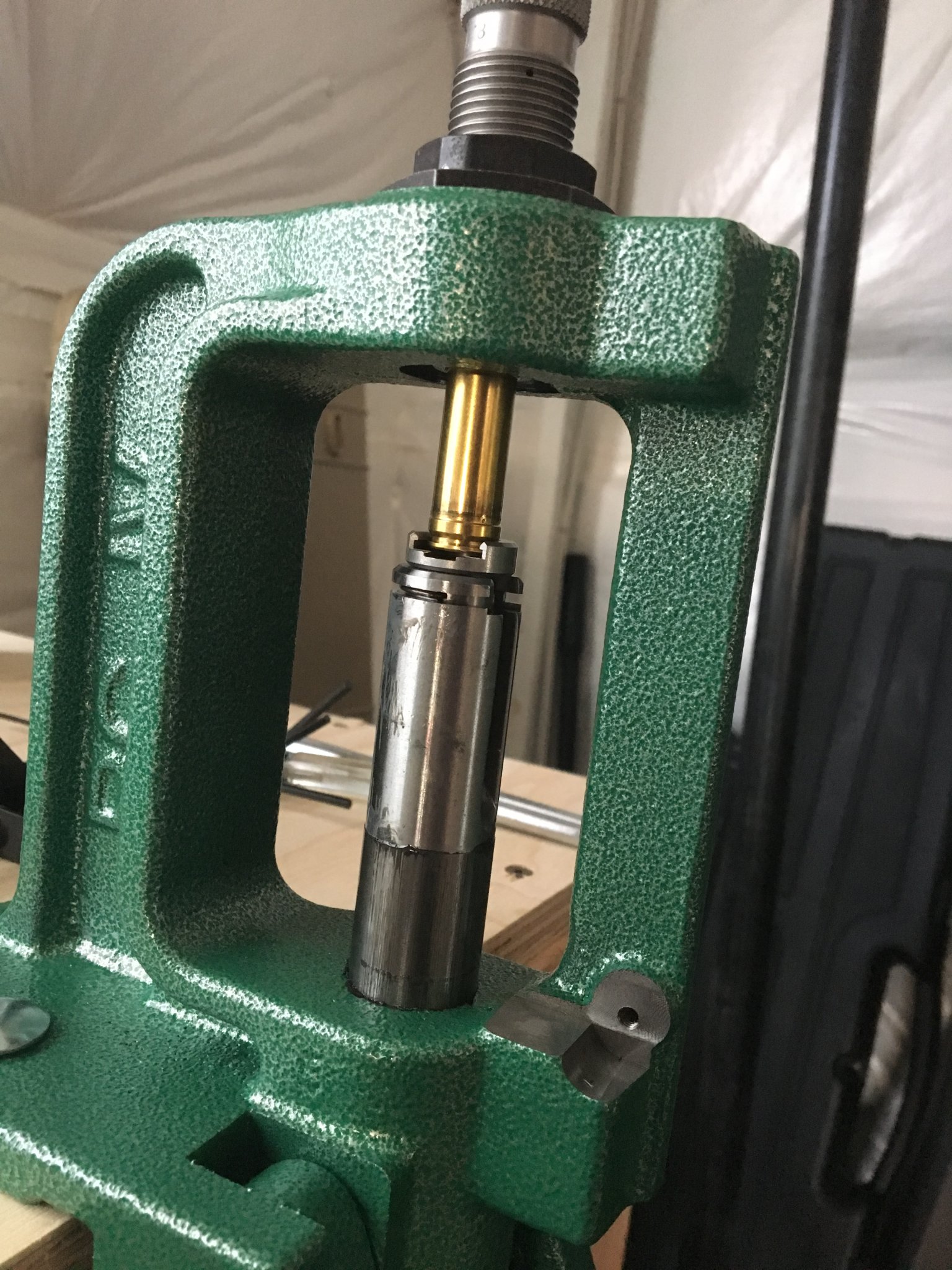

First time sizing brass- neck sticking ?

What caliber? What press? Brushing in a little case lube is fine. Then trim, clean pockets, and toss in the tumbler. It’s normal to have a decent amount of resistance . If you forget to lube, it can really feel stuck lol
I have been wet tumbling and cases are already deprimed. It sticks on the neck while I am I am removing (lowering case) out of the die
7mm Rem mag
RCBS die - 1/4 turn past seated on press stem
RCBS supreme press

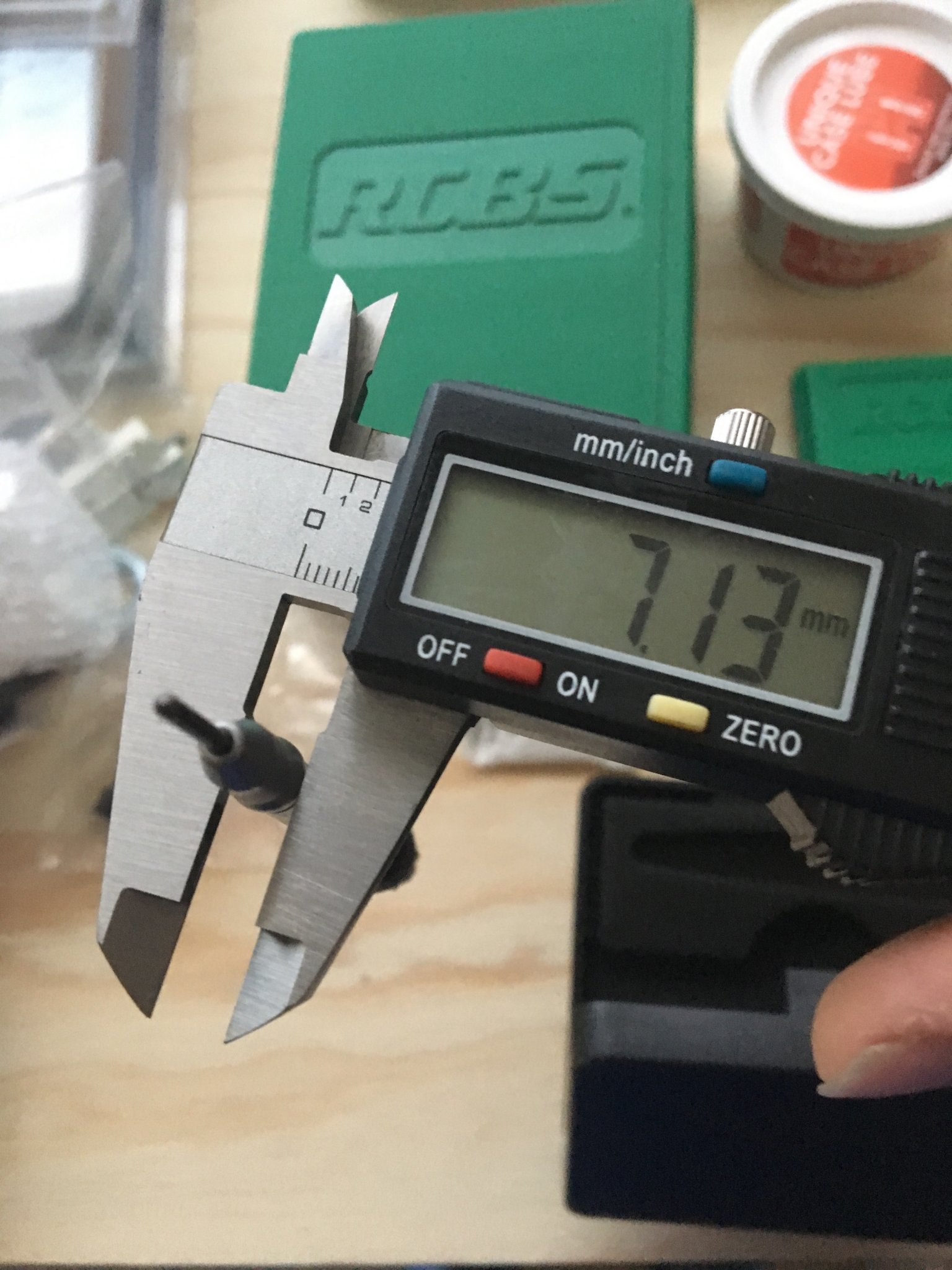

Neck expander ball is 7.13mm.... shouldn’t it be 6.98mm?
Sticking at this point on the way down. It’s not getting completely stuck. But just have to jerk in the press handle. I tried more lube and that didn’t help. Also tried backing the die out 1/8th a turn and that didn’t help.

Your measurement of 7.13 mm is about 0.2807".
A 7mm bullet is about 7.21 mm, 0.284"
That gives a little more than 0.003" net tension (considering spring back it might even be 0.004" neck tension).

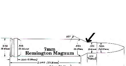

A corner inside the body die that is 'too sharp' at the arrow in the picture,
or brass that is a little thick at that point will make neck sizing difficult with your setup.
Measure a bullet, seat said bullet, measure loaded neck diameter.

I bet that once the flat, full size section of the mandrel passes the corner it pulls out easy.
