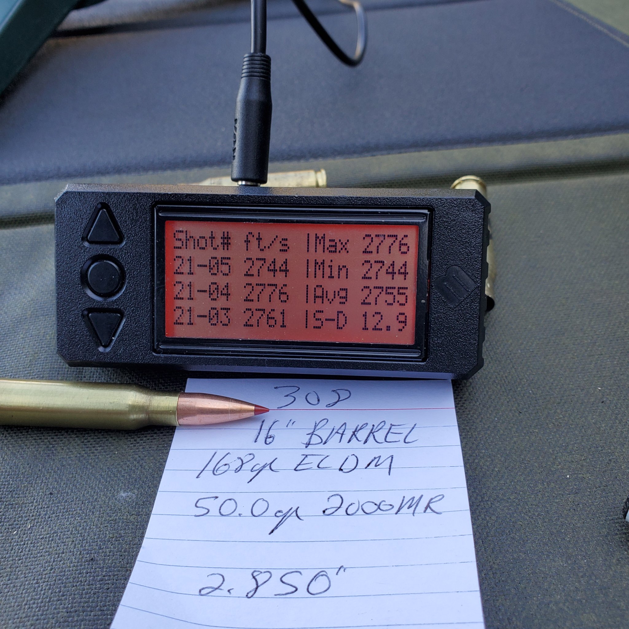

I built a 6 lb AR 10 16" light fluted barrel that does 2756 Average fps with 168 eldm and 1/2" 5 shot groups, easily makes over 1000 yds.

Here is the 6 lb AR 10, with 16" 308 168 eldm load. In pulled primed LC brass, no case prep, pull decapping pin, and resized neck.
Load with 2000MR weighed, and seat 168 eldm. 2756 fps 1/2" 5 shot group, your 20" bolt gun will be a bit faster and reach 1000yds. So here's your load, work up, my 16" AR 10 is dialed for 1200 yds at my location.
Here is a pic of the 6 lb AR 10, titanium bolt carrier, carbon fiber handguard, magnesium upper. Here the 155 gr were averaging 2815 fps ending up at around 2870 for a running load depending on 155 gr used, but 168 were more accurate.
