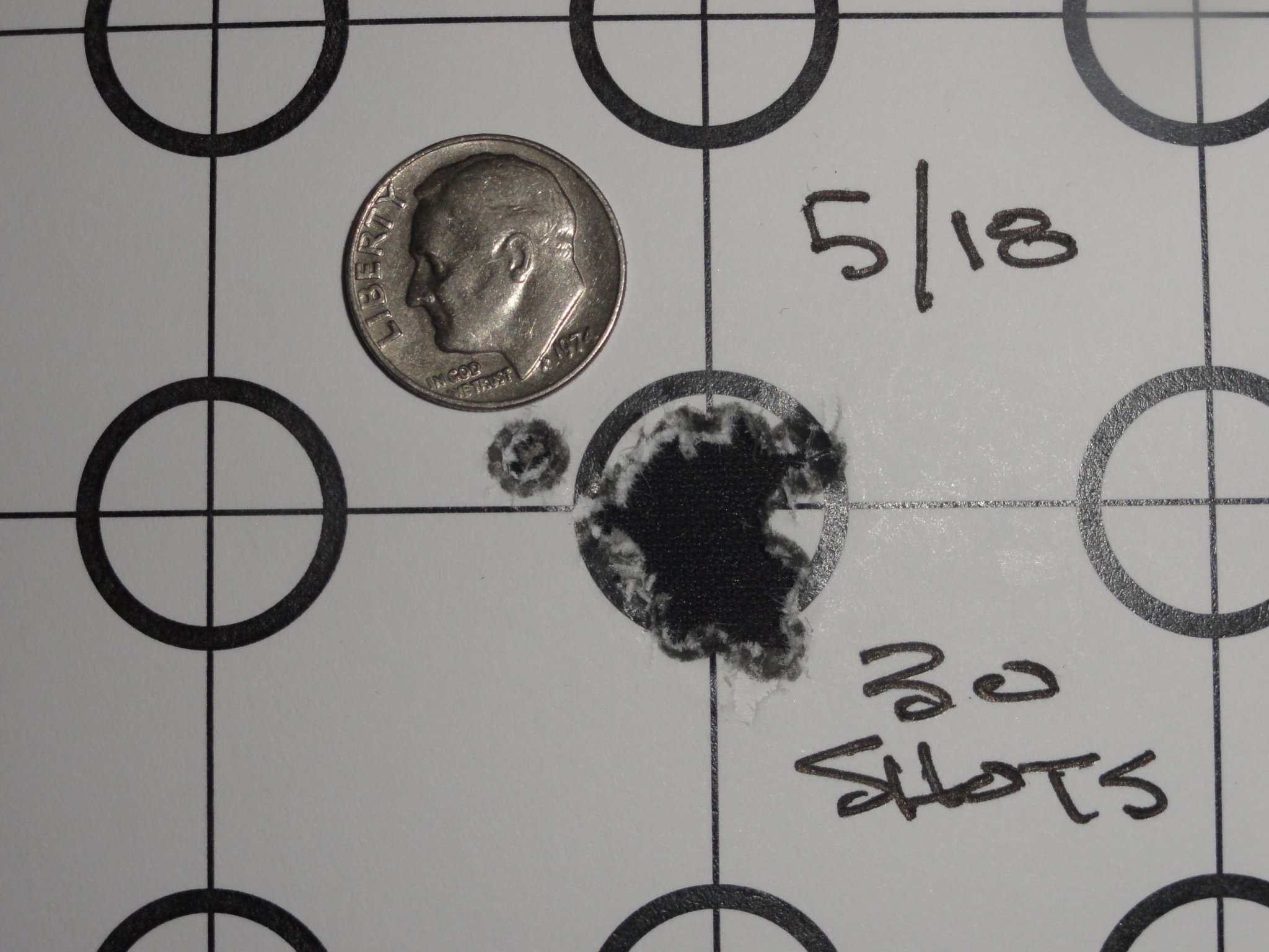

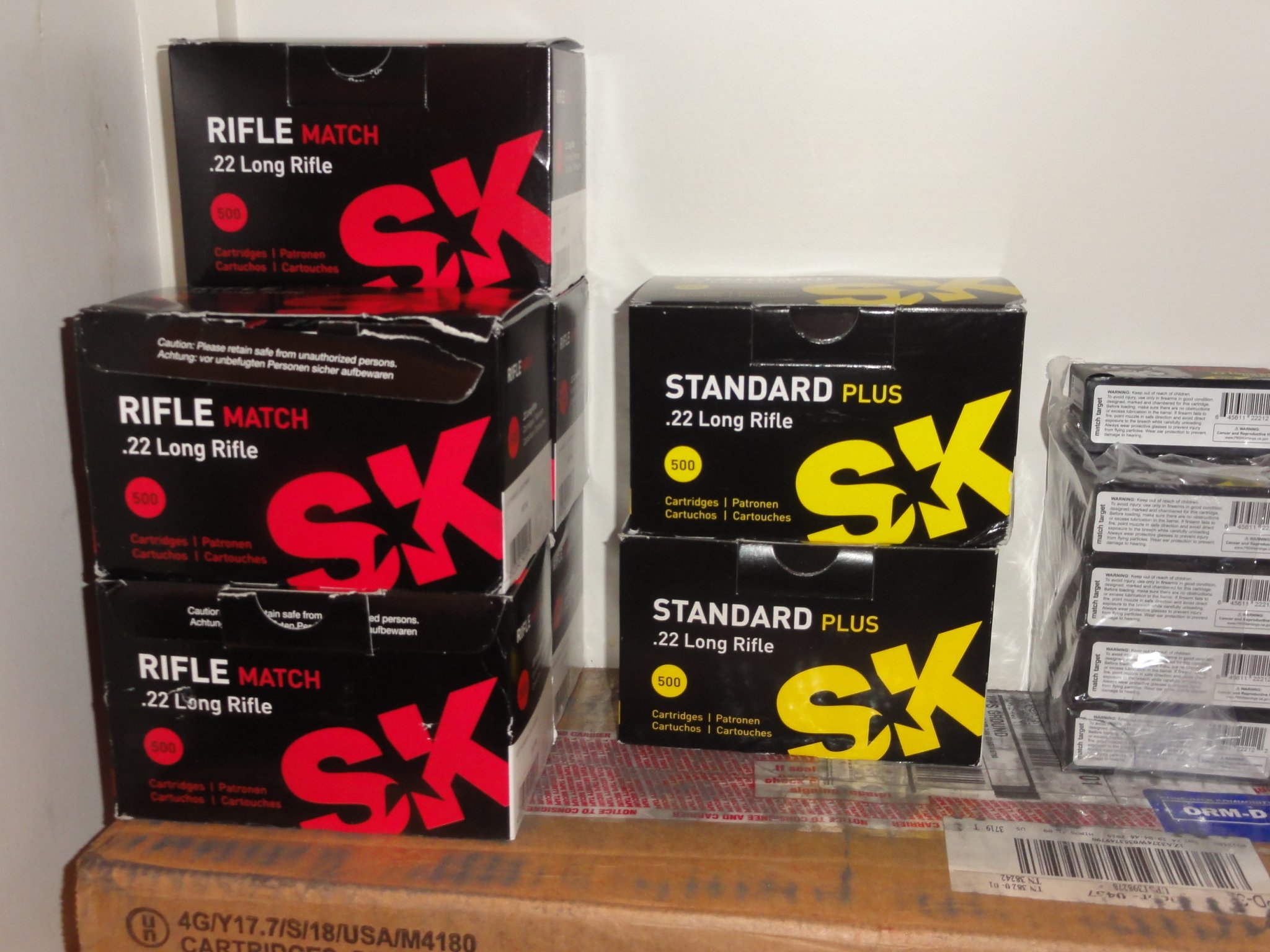

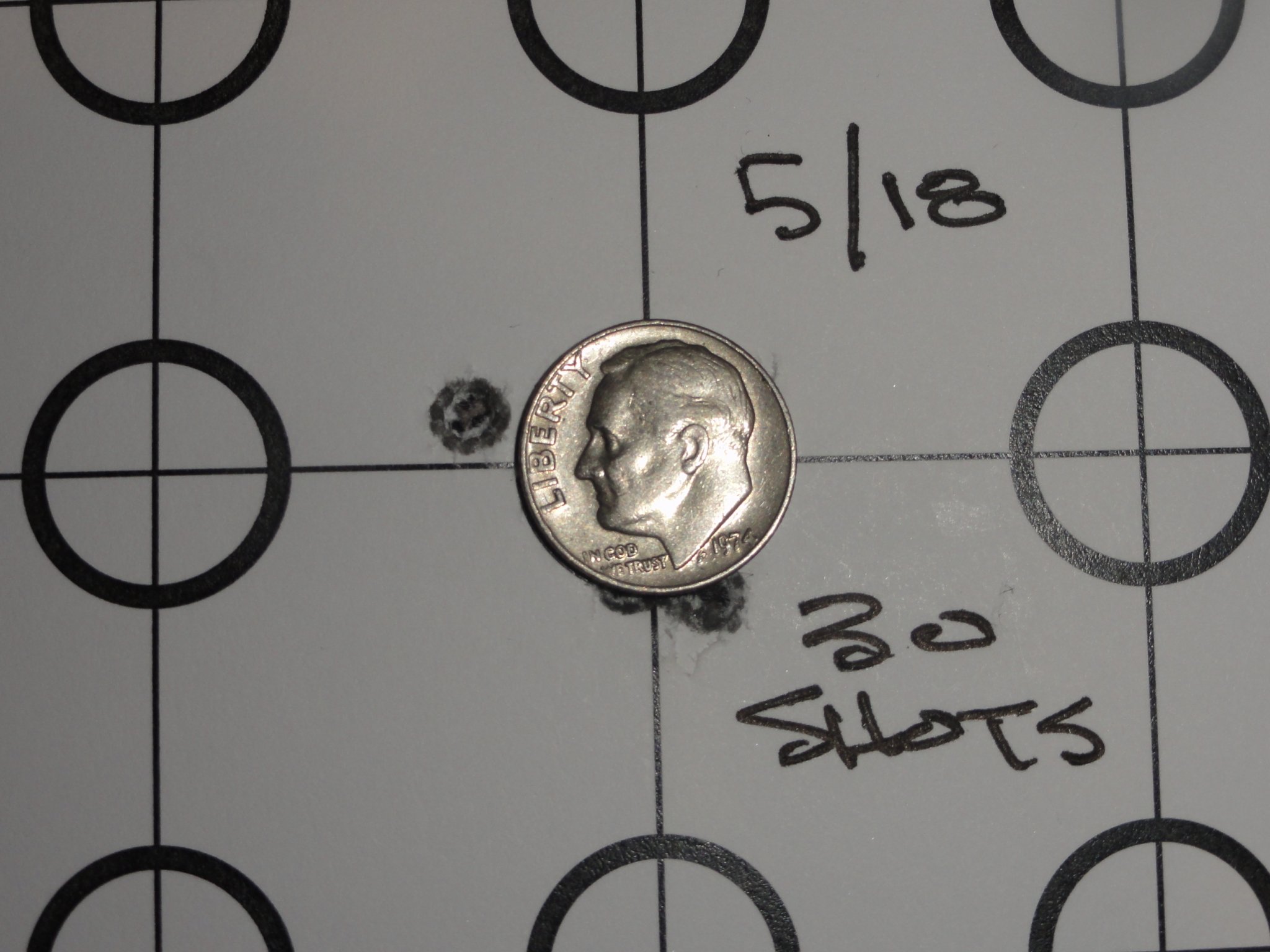

Dennis, This week I had time to shoot my CZ 457 MTR and this is what I got using SK yellow box. I did not have the tuner on her and she is basically a stock gun except the trigger. It has a YoDave spring kit that brings it down to 9oz. That is 30shots at 50yds. The missed ones where all me. btw.... that bolt knob makes the rifle a joy to shoot. It is an AREA 419 knob and rail.
