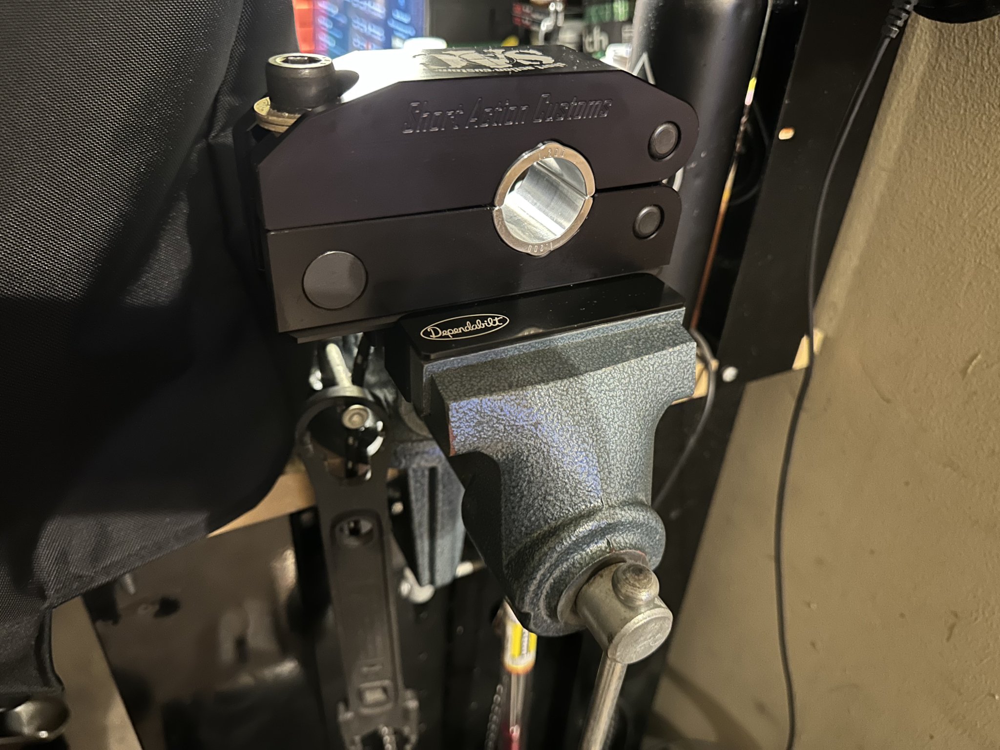

My reloading bench has a 1" thick hardwood top on it, so I just mounted a 4" Wilton bench vise on the very end of the right side, where barrels can stick over the length of the bench, instead of sticking out towards a wall, and I use a SAC Modular Barrel Vise with a Sawtooth Rifles ARCA jaw for the bench vise. So, my barrel vise, sits in an ARCA jaw, that is locked into my bench vise for removing bolt-action barrels. For AR's I just use a Reaction Rod in the bench vise that sticks straight back towards me. Built A LOT of rifles like that. Still do. You don't have to have a fancy rig to accomplish what you're trying to do. Might require some slightly more expensive specialty equipment, but you don't need more than 1 bench to do everything from reloading to gun building.

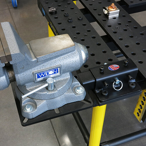

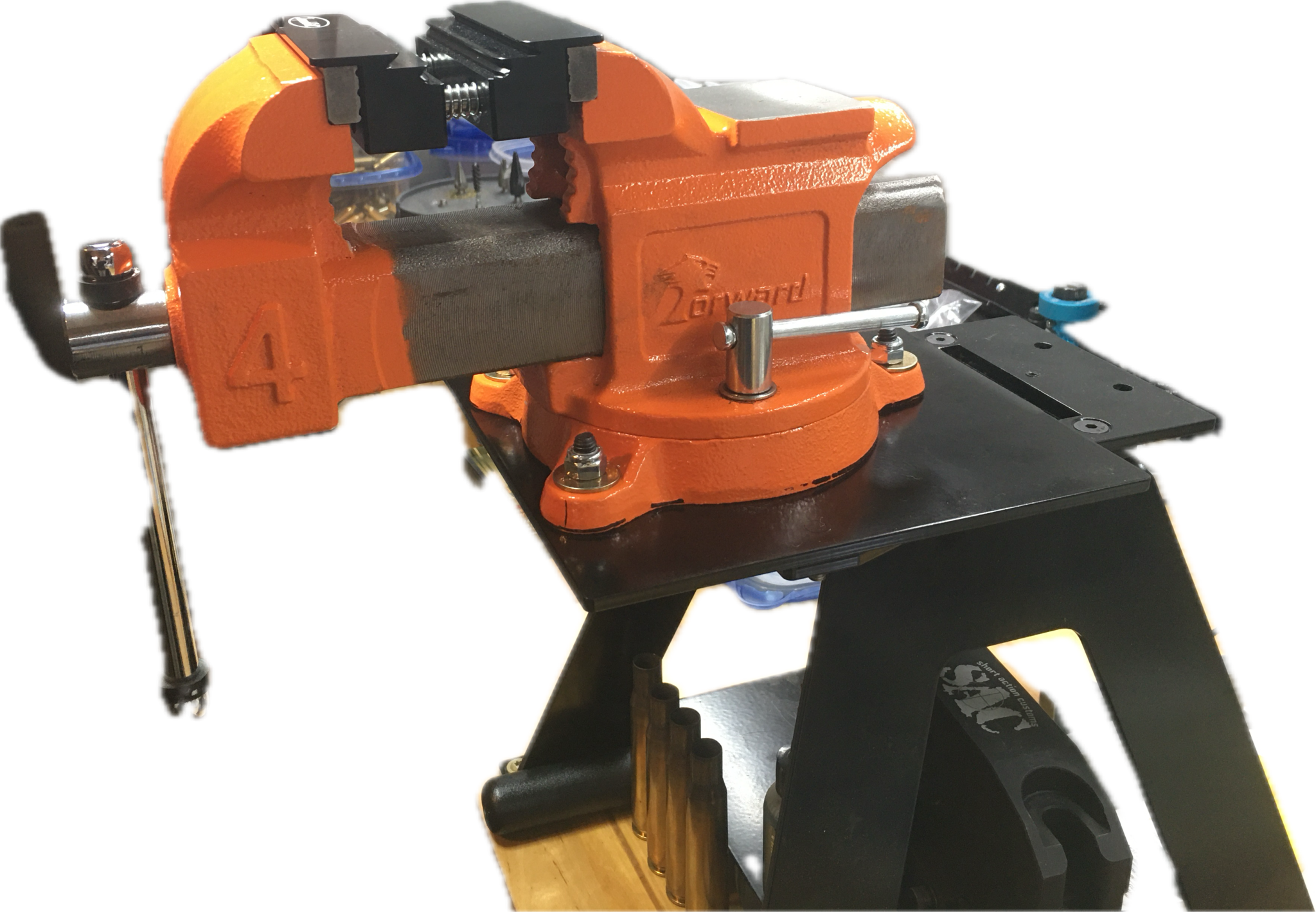

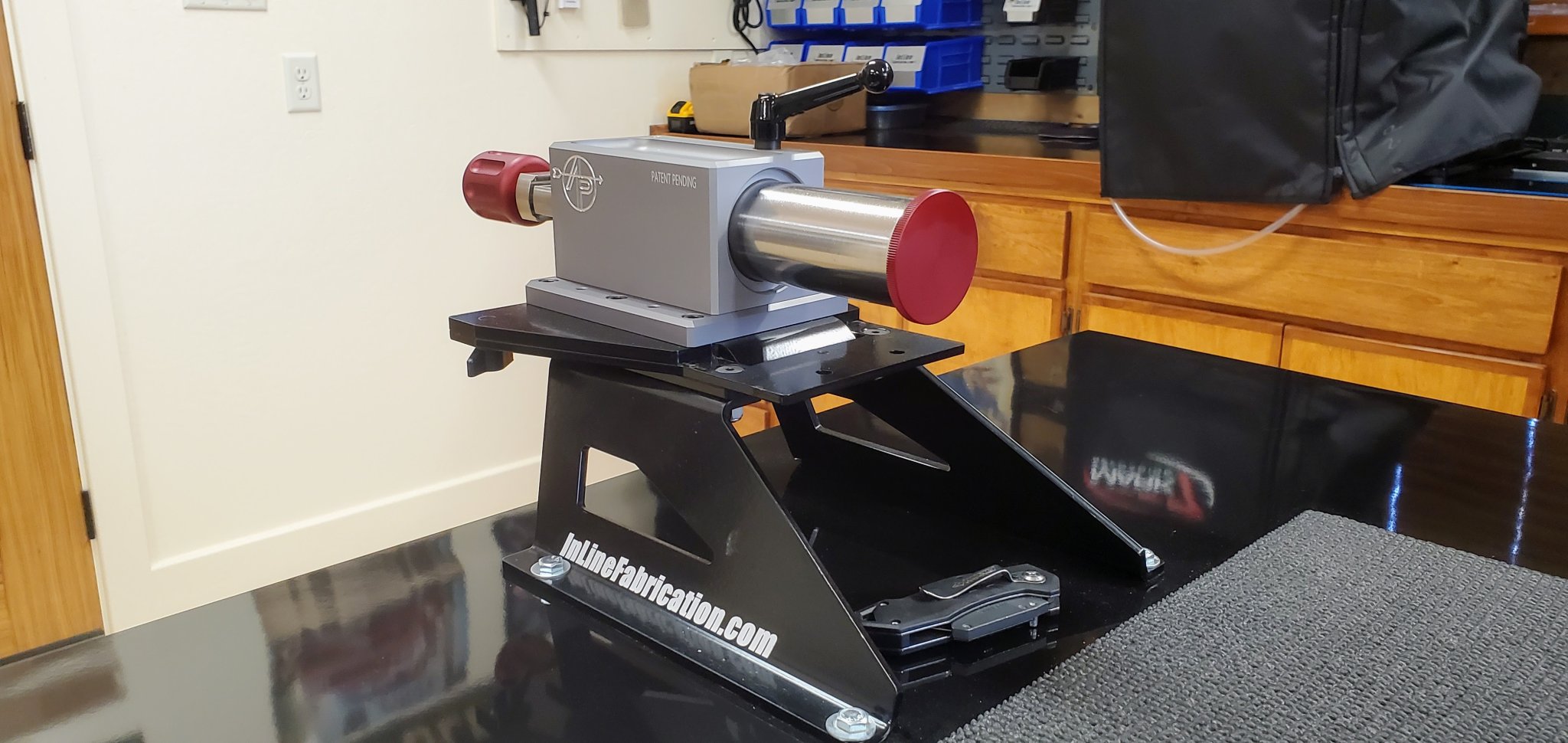

Highly suggest inline fabrications mounting system. Reloading gear, vises etc. If it bolts to a bench pretty good chance he has or can make a quick change plate for it. Makes it super easy to have one mounting point on your bench. I swap in presses, different types of bench vises, priming tools, SAC barrel vises etc.
I will definitely. I want a single mounting point so if not got crap all over the bench work space. Didn't know till today how to achieve this but I do now!!! Thanks Fellas!!

Best vise I've used for working on guns. Pic rail on one side, arca the other. I have a regular vise for mounting barreled actions.

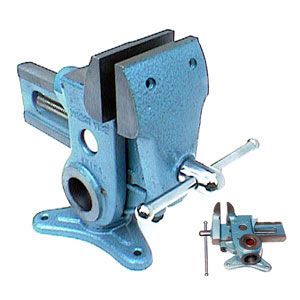

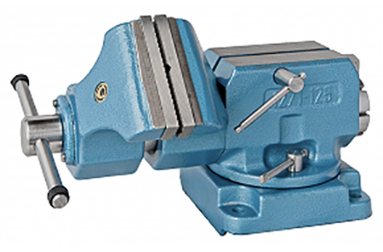

That Rock Vise, mentioned above, looks really sweet. Other vises that allow vertical workholding that may work: corner/in-line vises, rotating woodworker vises (vintage), or a pattern-maker vises (vintage and some modern).
A pattern-maker and carver’s vise can hold non-parallel items like some wood stocks (Grizzly T34003 Carving Vise). Of course, there’s little do-dads you could put in a regular vise to do a similar thing.
I believe old USA versions of this vise were used by gunsmiths. No idea how well this Asian version works. You disengage it from its base and flop it 90° to hold a gun vertically.

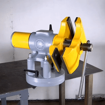

To get a regular bench vise to hold something like a rifle vertically, you can mount it to this Versa mount receiver hitch thing. Then you can change the orientation of the vise by 90° at will.
Or buy a rotating bench vise…no recommendation on all of the Asian ones on the market, other than to say that most have an irritating design. Say you have something clamped in the jaws, but then want to rotate it. You have to unclamp the object to allow the rotation bit to work. Dumb.
This Polish rotator is the only one that appears not to have that design flaw…although I’m not sure if older Asian rotators are different than their modern counterparts in rotation design.
I forgot, the above Bison the only one I’m aware of unless you go to a Swindon vise (UK made, installed on UK warships, $$$$ looks friggin’ awesome).

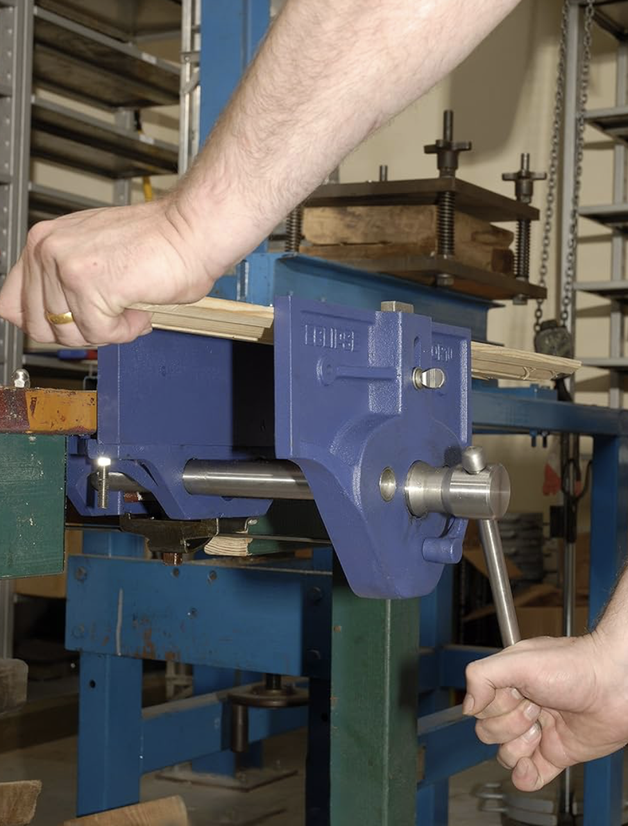

WOODWORKING VISE
Probably the best, for a general purpose vise, is a quick release woodworker vise like this:
It’s a reproduction of the old Record No. 52. The pic doesn’t have the usual wood jaw inserts that people install with their own wood. Here’s an Amazon link too (read the reviews for good info).
For me, because they are so fast to use and have wide (user-added wood) jaw faces, it’s the vise I tend to use most. I like the ones with the trigger to disengage (Eclipse/Record 52) vs the interrupted lead screw type like these:
Get the 10” one so you have maximal room at the vise faces to get a rifle (or stick) vertical. Or, I wonder if that sawtooth Arca/picatinny thing would just fit in vertically on the short side…I bet it would. Might have to place a bit of wood on the opposite side to prevent jaw racking.
