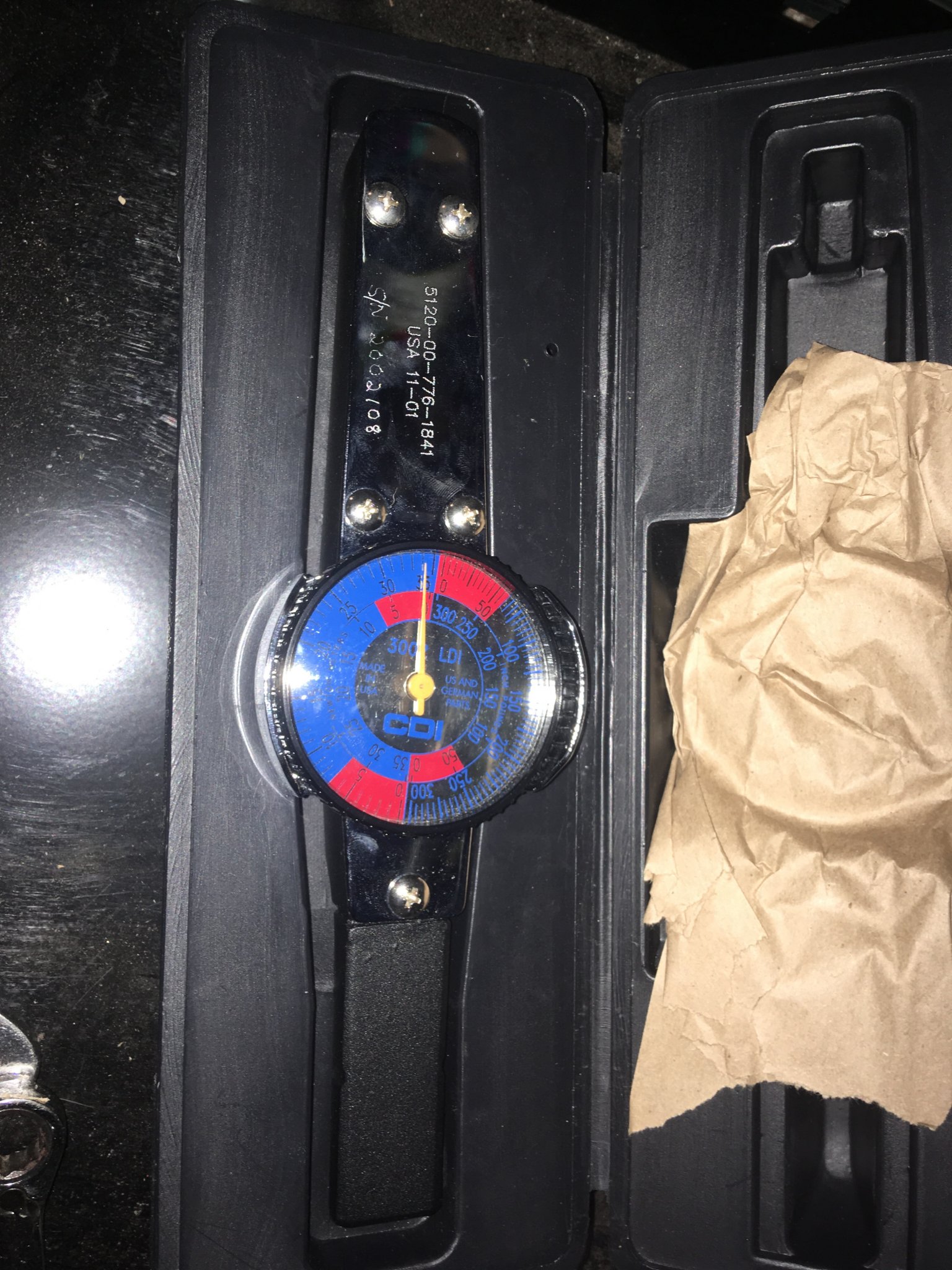

For what it’s worth. I break out this when it matters:
