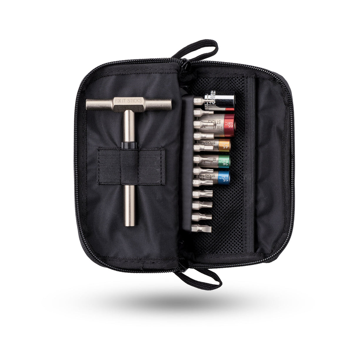

I’ve got $250 to spend on Fix It sticks. Looking for recommendations on what to get. I’m thinking the Rifle and Optics toolkit, with an extra extension and a magnetic parts pad. Do folks prefer the all in one or individual torque limiters? I shoot bolt guns in chassis for PRS and stocks for hunting if it matters.
I love spending other people's money, my list would probably look like this:
Rifle and Optics Tool Kit with AIO torque limiter - I don't have an experience with the individual torque limiters but I like my AIO and it's pretty easy to use covering a pretty wide torque band vs. four individual limiters.
I'd probably skip the extension and get the appropriate long bits for the action screws. I have the long 3/16" bits for my AX chassis and I love them.
I'd probably get the molded magnetic tray vs. the magnetic patch because the trays give that extra assurance nothing gets lost when working off an uneven surface.
Coin Slot Battery Tool - Who carries change anymore? This would be handy for taking off battery caps, making adjustments on hunting style capped turrets, etc...
Remington 700 Bolt Opener - This is handy if your rifles have R700 type bolts, I have this tool and it works very well to break down the bolt.
Beyond that, maybe the mini-AIO for lower torque values, and maybe the Medium Carrying Case to have room for expansion.
My cart comes to $253.50 before tax and shipping so pretty close.
I actually have gone both ways on the torque limiters. I currently prefer the individual limiters as I can feel the limit rather than count on my eye sight to check proper torque. The all in one has it’s place though, if I was putting together a small field use kit, where size matters, the all in one would be there. I have one in my range bag with a set of bits, a couple Allen wrench’s an extension and a ratchet.
I have multiple sets. I like the individual "click" limiters for my bench.
I have the rifle/optics with all in one limiter in my range bag.
I started with the All in One but moved to the individual limiters. I love them!
+1 on the individual limiters. However, I had to replace one. It seemed like the 65 in-lb wasn't "clicking" when it should. I happened to have an all-in-one torque driver and compared the torque.
Sure enough the individual limiter was bad. I contacted fix-it-sticks and they sent me another one free of charge!

That's a good kit to start with. I have both the AIO and individual torque limiters. I use the individual when I can and the AIO for the occasional oddball.

The inidvidual limters are brilliant for 20/25lbs on scope caps. I'm not a fan of the 65in/limiter myself, it's big and chonky and not as responsive when it hits the limit....But...maybe I should test it agains a proper torque wrench to see if theres an issue?
FWIW for newbies who haven't seen thses in person, the smaller limiters light/small and are very packable. The larger ones are a bit more like throwing lead fishing weights into your range bag...:ROFLMAO:
IMHO you need to be judicious with them for travel kits...
If you plan on using the TLs at home on the bench, I would go with the single units, cause they're brilliant. The AIO limiter, I'm not a huge fan of mainly due to stack-height, but it probably makes a better travel/range kit lots of larger ones.
I think that's why you see alot of guys keeping multiple types and having kits.

I too went for the Rifle and Optics Tool Kit with torque limiters which I far prefer to all-in-ones torque drivers.
I did buy an extension and find it helpful. I also have ordered some individual limiters to specs for scope turret caps (eh...4 in/lbs...like that).

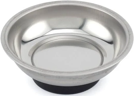

As for magnetic pad or tray....I use a small magnetic parts tray like this....very inexpensive.
I have some of the limiters and both AIO. The limiters are very nice and supposedly more accurate. The AIO though cover any torque setting. Look at what you want to torque if buying a set and make sure your getting the limiters you would use. I have added a few limiters and some other pieces. but the AIO work well too. They are a great product.
What do you find yourself using the extension for? I haven't really seen the need to go longer than what I can get with a bit and the t-handle for anything gun related.

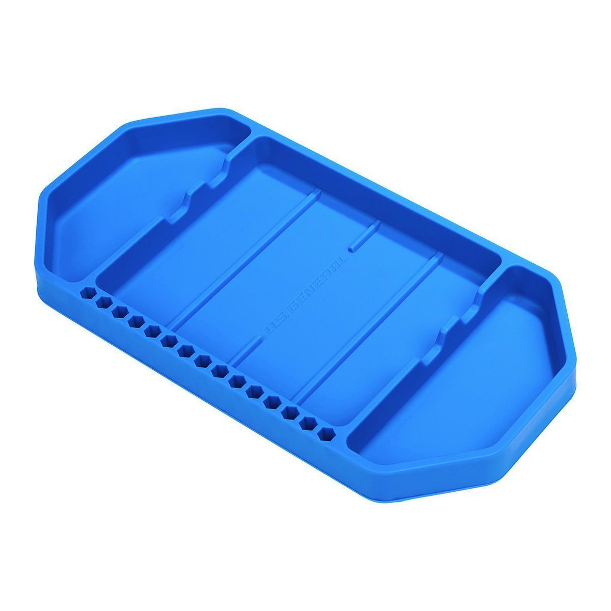

I have one of those trays that I keep forgetting I even own lol. Lately I've been using one of these US General silicone trays from Harbor Freight.

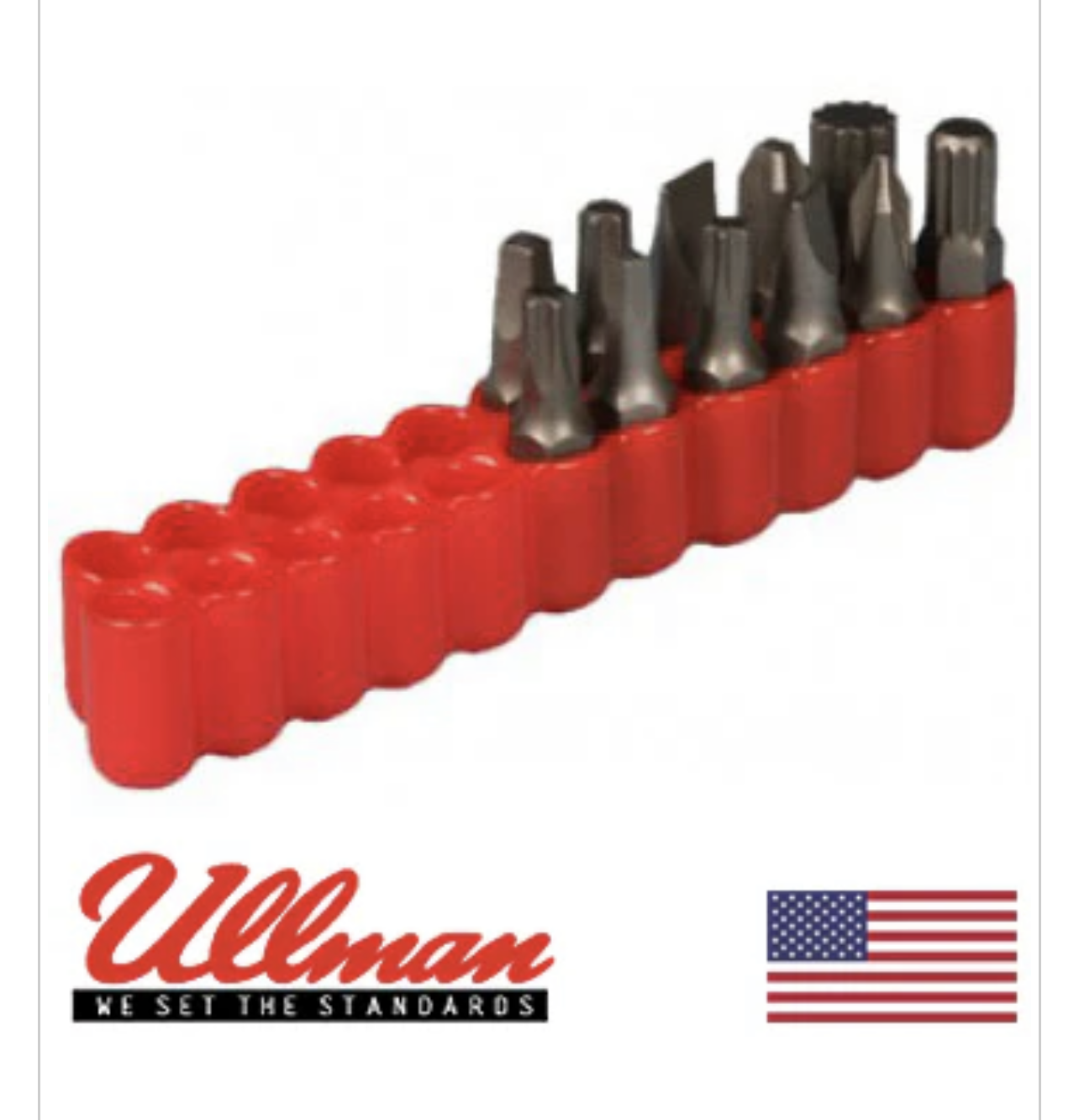

One of the torx bits broke in my set so I replaced all of them with bits made of better steel. I bought their magnetic tray and sewed some velcro to it and to the outside of the cover of the Rifle and Optics kit case. I have used the Fixit stuff at home but it's mainly for field repairs or tuning.

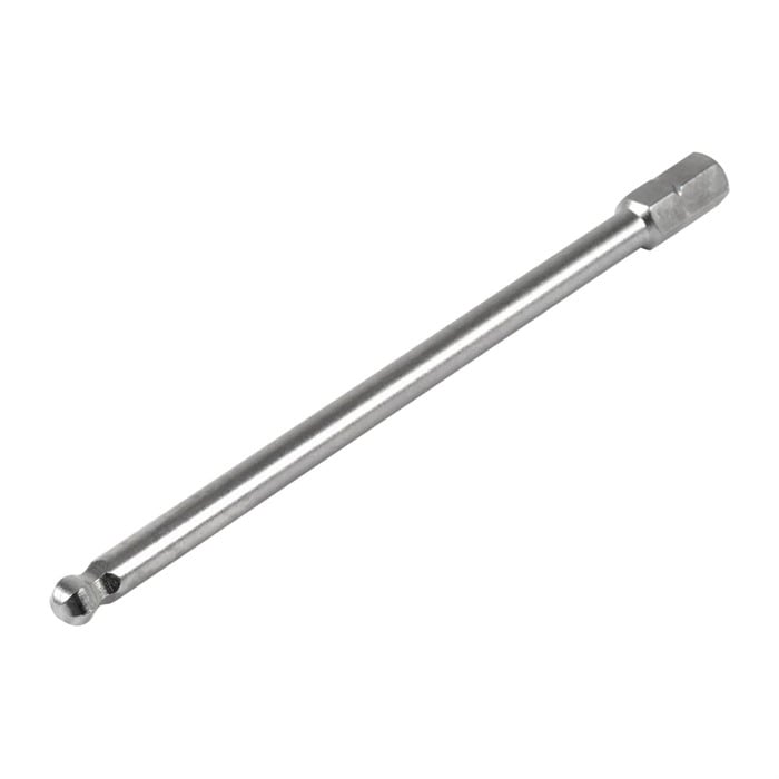

Sometimes windage turret screws as the scope or chassis get in the way otherwise. Not too often but very helpful when needed. I also bought their 3/16" action screw extended bit with the rounded head (not sure what you call that) which I’ve found to be absolutely needed by my chassis. I did buy a long 3/16" bit with squared off hex head but founded I needed to accommodate a bit off an off angle (particularly w my OG JAE).
Sometimes windage turret screws as the scope or chassis get in the way otherwise. Not too often but very helpful when needed. I also bought their 5/32 action screw extended bit with the rounded head (not sure what you call that) which I’ve found to be absolutely needed by my chassis. I did buy a long 5/32 bit with squared off hex head but founded I needed to accommodate a bit off an off angle (particularly w my OG JAE).
I've got the 3/16" long bits for my AI AX chassis, they work great, I have one in my field kit and one in my bench kit.

I have The Works kit with a couple extra bits added to it, an upgraded ratcheting T-handle, and an all-in-one limiter that is always with my shooting gear. Then I created a 2nd kit with a standard T handle, an all-in-one limiter, and only the bits I need to work on my main hunting rifle that stays with that rifle - either in the case or my hunting pack.
As others have said I like the individual limiters on the bench, but have the two AiO's in my range bag. The long arm bits are handy but I don't like the ball end versions like Fix it sells. Ball ends are more versatile but also much more likely to strip a tight bolt, especially since a lot of gun/chassis hex bolts have shallow heads as it is. Sooner or later you run into a chassis/stock you need them on. I've also had a couple individual limiters I felt were out of wack and were replaced, including in 18in/lbs that about 25in/lbs.
The battery cap tool is nice, a lot of their little tools are cute, and if you had to have a compact field kit are probably fine but I find them way too finicky/small for regular use, and for me if I have that big of an issue with a rifle at the range, I just pull out another one :) So I don't mess with things like the pin punches and all the speciality tools etc. Their bits are not horrible, but not great either.
IMO skip the ratcheting handle, thought it would be great, and it's just more hassle than it's worth. Didn't like the scope jack, several of my setups it would not work on.
Oh, I agree about ball ends but a 3/16" long straight bit was too big to turn in the hole in the trigger guard on my JAE. Can't remember if I had to use the ball end on the Vision also?? At least the ball head has a round and thin shank and I can get at the action screws.

Agreed, I've actually opened up more than one chassis/skin to allow better access to the action screws. Most recently an MDT Field stock that uses captured rear action screw. Which seems puzzling for multiple reasons. First that the front action screw isn't captured so if you wanted to keep people from losing screws you only did it with half of them, second if you want to bed the action in the chassis (and mine flexed enough tightening the action screws it definitely warrants it) they are a nightmare. Seems like a poor design when you make it that hard to get at a commonly used fastener, but I suppose at the $ we spend on rigs companies figure buying some special bits are not a big deal :)

I love captured action screws but there needs to be a way to un-capture them. If you damage or cross-thread one, how do you replace it?

The ratchet I think for me came down to two things. First it seemed like often I was inadvertently flipping the little ratchet lever. Second when I wanted to remove fasteners quickly that had almost no tension on them, as most smaller gun fasteners do it was faster to just use the spinner grip. I guess if I ran into more fasteners that needed more oomph like sticky/gummy loctite etc. screws the ratchet would probably work nicer. That said optics are the vast majority of my use case for these, so there's a lot of "spinning" of little fasteners. Not that I don't use them on actions screws etc. but it's much less often.
Now what I would like to see, is their ratcheting handle with the quick release extension, that had a middle "locked" position and the ability to lock on the spinner extension. Then you could have both worlds, lock it out with the spinner if you want, or use it with the ratchet for screws that don't just "spin" easy.
I would say the one downside to the AiO is they are larger in diameter than the individuals, so you may run into areas that are hard to get into esp. with the larger range one. I've had that issue with some scope ring setups but normally the smaller one fits most places. To combat that I'd suggest getting 2" bits, which I actually think is a good idea in any kit, they are just more versatile.

wrt to ratchet in my fix-it-sticks kit (which I do not have), if I find the need for greater force (like loosening the cross bolts on ARC rings that were set to 65 in/lbs) I just put the fix-it-sticks torque limiter (and of course bit) into a regular 1/4" ratchet drive (or even a 1/2" drive with a 1/2-1/4" adapter).
We are many and varied and favor different things...but for me, I didn't/don't see the need for a fix-it-stick ratcheting handle. But perhaps I'm missing out on something.

Well, that’s one of the beauties of the tee handle. Turn it sideways and you’ve got a tremendous amount of leverage.
