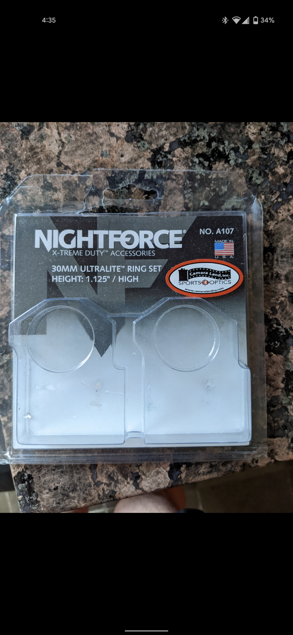

ok... Long time lurker. Became a paid member today and this is my first post.
I was an infantry officer for 9 years in the national guard. I only ever shot with iron sight and red dot and feel like preparing and competing in some PRS and 22 NRL would be a good way to add skills to my marksmanship.
I have just purchase in order to start my journey:
1) a Christian arms MPR in 300 win mag (this will be for hunting only)
2) a ruger precision rimfire
3) a cz457 in their precision chassis.
I plan to add a 6mm once I have a comfort with the skills required and can get some primers and hand loading equipment.
scopes: I have 2 nightforce nx8 4-32 with the tremor reticle and a vortex venom 5x25 with the ebr-7c mrad reticle.
my plan was to put the vortex on the Ruger, and the nightforce scopes on the other 2 rifles.
What rings should I get for the Ruger to mount the vortex to it?
the 30mm ultralight separate mounting rings (pictures are for the MPR (it's what nightforce told me I should get 🤷‍♂️) is this right?

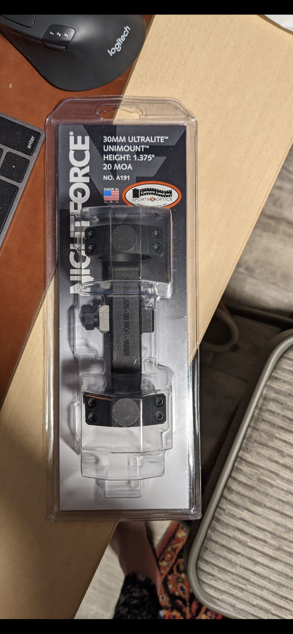

the unimount (pictured) was what nightforce told me to get for the ruger to mount the other NX8. but that puts me at 50 moa? and the nx8 only goes to 90 elevation adjustment??? so no clue there I though one should stay below 50% of your total elevation for the moa of your mounts???. and no worries because I want to put the vortex on there now and the nx8 on the cz457.
i purchased a 25 moa rail for the CZ from scar ( https://triggersbyscar.com/ols/products/25-moa-extended-picatinny-rail-for-cz-457 ) to add to the CZ to put the nightforce unimount that I have (20moa) for the nx8. that would put be at half of the elevation adjustment.
Is this good thinking for this stuff?

a bit confused on ur elevation question... but
on a rim lfire you'll want max inclination.
considering you have adjustable cheek piece i'd be running a DIP rail 40moa and burris xtr rings to get yourself to the bottom of the elevation.
most zero's will be the plus side of mid point.
25 moa base
plus 20 MOA mount inserts should get ya..
for a total of 45 moa of inclination
not sure a cantilever mount is what ya want.. and considering the price paid i'd go with a better setup. but kookyness aside it will work
Rings by themselves don't have cant. A one piece mount can have cant, not rings. Least none that I'm aware of.
If the ruger has 30 moa already that's probably all you'll need.
Oh, it's a 22... you could use a one piece mount with some inclination then. No more then 20 moa.
okay for my Ruger precision rifle the base that comes on it is 30 MOA? should I find rings with another 15 MOA to it?
Reactions: opherman47
@spife7980 exactly there is so much stuff out here, hard to know what to do... like I have seen videos by 419 saying go half of total elevation, but when I called nightforce they recommended a total of 50? so still hard to understand

Looks like you are right there and just need to buy some hardware and see how it works and figure out what you need depending on your skill level. Get some trigger time and learn how to shoot the wind, that is the only way to figure out what you need. If you are not accurate at 100 yds how do you expect to shoot 300 yds. Good top tier ammo is the name of the game and if you can find some it's not cheap.
Start with mid range hardware and use good ammo. A 25-30 MOA rail is all you need with a scope that is at least 3 time the cost of your rifle. Good Scopes move from gun to gun as you get better. You have to see where the thousands & thousands of dollars are going.
depends on how far out you're planning on shooting the rifle. Try it without the extra cant and see what you get.
I'm no expert, so take this as a n00b's 'lessons in rimfire PRS style matches' The farthest I've shot in a match was 325yds. (IIRC) and the scope adjustment and holdovers got me more or less on target. MOST of the targets are 70 to 200 yards at that range. The other range I've shot at, the targets are 50-ish to 195 yards. My BMR has a 30MOA rail on it from the factory. My CZ has a 25MOA rail on it now.
