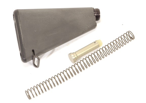

A short A2 is a A1 stock. They use the same buffer tube spring and buffer but the A2 has a spacer as well as a longer screw that takes up the extra length. I have had A1 length stocks made by Vltor, Cav Arms and Magupuls is also A1 length.

I think you were looking at a Guardian Shorty: Butt Stock Assembly Group, Guardian Shorty w/Solid Plastic Butt Plate, New, Black
Thanks...the shorty may be a little short at 10.5" LOP, checking into the EFX to see what they say on LOP.
