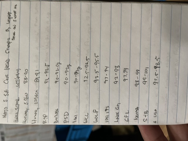

Ideally, you pick the head stamp in which you have the hightest number of servicable cases and work up a load for the rifle (as you mention), paying careful attention for overpressure signs.
Cases with low relative case capacity have you leaving performance on the table because you’re hitting pressure sooner and likely before you’re getting optimal velocity (ie velocity absent overpressure).
@Dot3 , here is a partial list of 5.56 case head stamps along with respective weight (in grains) so you have an idea as to which cases have what capacities (weight isnt a direct measure of case capacity but can be used to infer relative capacity if compared across multiple head stamps in context of different charge weights.
more weight = less capacity and less capcity = more pressure at a given charge weight relative to cases with more capacity. Focus on one headstamp at a time and work up carefully.
