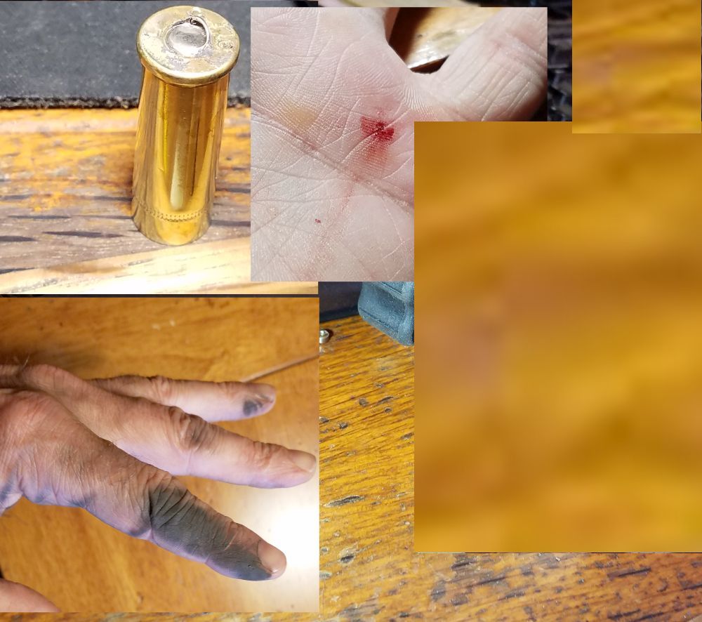

Hi folks,
Had a small scare the other day whilst reloading that might be a helpful reminder to people to keep safe and follow your procedures not being sloppy. Primer popped when being seated and flashed over into try causing other primers to detonate.
This happened using a Hornady Hand Primer
My set-up post incident
Close-up of hand primer – not sure where rest of pieces are.
Close-up of “flashed” primers (Note empty but dented cups)
And this is the resulting cuts to hand – fortunately they seem superficial. Blast also blew my glasses off my face and they landed ~6 feet away.
Fortunately I was wearing latex gloves so some protection.
Be careful folks and wear your eye protection.
(Just in case people are interested, didn’t notice anything different from usual. Cases were PPU factory on ~4th firing. Primers were Federal Large Pistol. Cases had been sonic cleaned and primer pockets checked prior to priming and I’d primed ~50 that session. This process has served me fine for ~3 years of loading)
Best wishes,
Scrummy

Hi folks,
Best wishes,
Scrummy

Hi folks,
Best wishes,
Scrummy
Glad it was minor. I'm about ten years into halfway serious reloading, and had always heard about being careful with primers. But being the pyromaniac I am, had tried popping them by using a slingshot to slam them into concrete, never a whimper, so disappointing. Then one day had a primer pop off while setting in 6.5 Creedmoors.......surprised the hell out of me, after doing thousands and thousands without mishap. Thank goodness I was wearing glasses, and had the case leaned away from me, nothing but the surprise getting me!
Its gotta be straight up and down to crush that anvil point through the foil and into the compound (or so Ive read). From my findings of smacking them on the ground with a hammer, they always go off. But they always end up round side down so no off cases.
Talked to a guy at the range one time who had a very full tray in his hand primer go off. He wasn't wearing safety glasses but miraculously got away without an injury to his eyes. His face and arms were covered with pot marks/ burns in the pictures he showed me.
Wear your glasses fellas, you've got one set of eye balls that science has not yet figured out how to replace.
