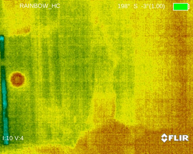

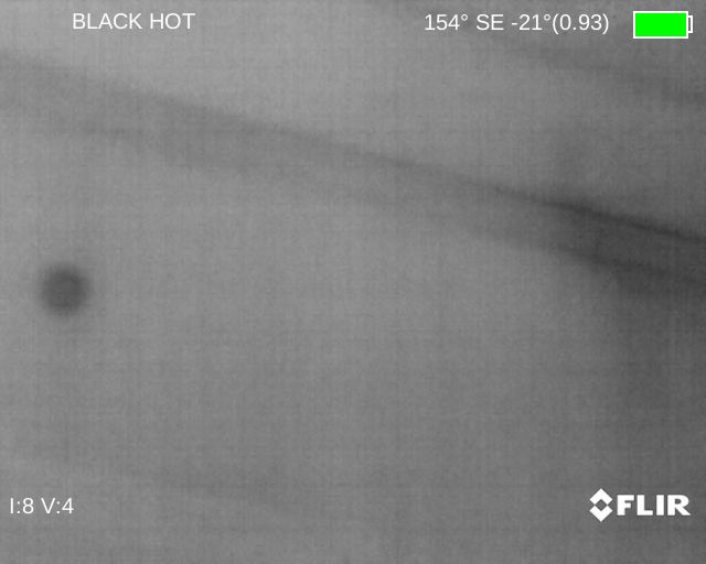

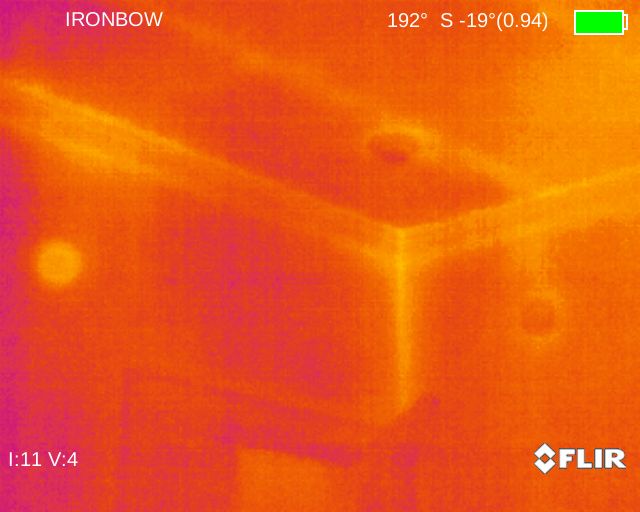

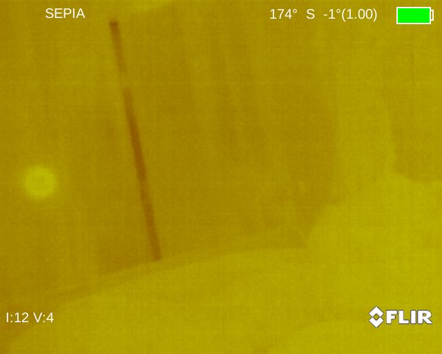

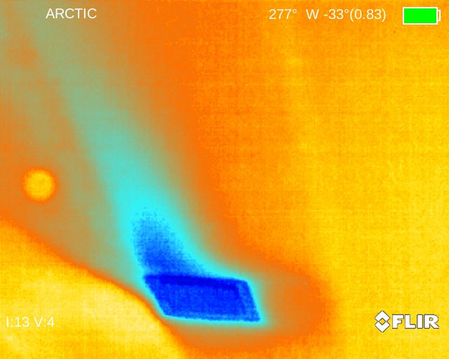

Anyone seen this issue in their Thermals before? When I first turn on the unit if it has been off for a while I don't see this spot. Then over a few minutes it starts to come back until it is pretty pronounced. You can still see through the spot, it shows as if that spot is hotter based on the color change depending on palette.
Sent an e-mail to FLIR CS but have not heard back yet.
