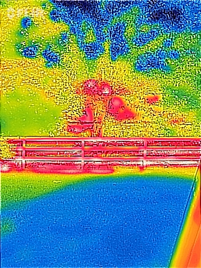

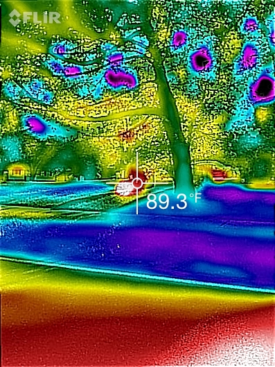

Mine arrived yesterday. Resolution is rough, but its fun to play with if you don't own anything better. I'm posting some examples:
1) Here's 2 guys at (at about 10 and 15 yards) entering the backyard between two garages, near total darkness. The resolution stinks.. it is very difficult to identify people, what they are wearing or carrying... on the other hand the contrast is much more intense than NV optics so I guess it's a good device for spotting any sort of warm blooded living thing in the dark.
2) Closeup of a bucket with temp at an ALS "Ice Bucket Challenge" (this is a screen cap from a video shot on the FLIR One):
3) Another screen capture from the Ice Bucket Challenge Video:

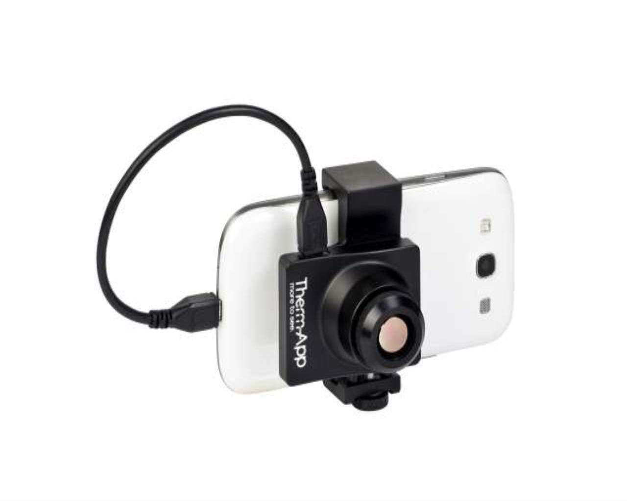

Ordered one of these, Therm App $1059 shipped to your door from Israel via Fed ex

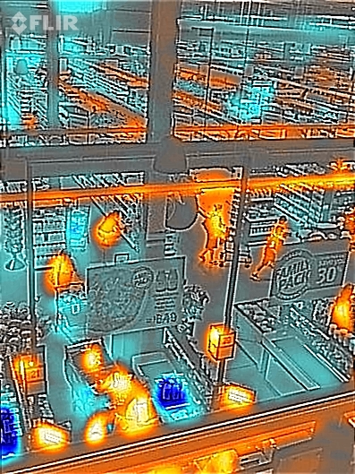

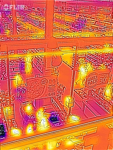

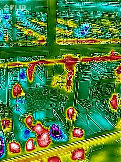

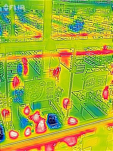

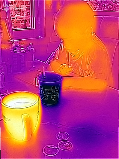

1) Cup of coffee, ice cold water, child... this is your basic FLIR AD photo...
2-5) These are pictures from 8 meters above the floor of a large supermarket. Note how that in this case people are the primary hot spots.
Interesting.

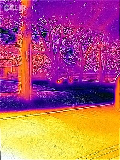

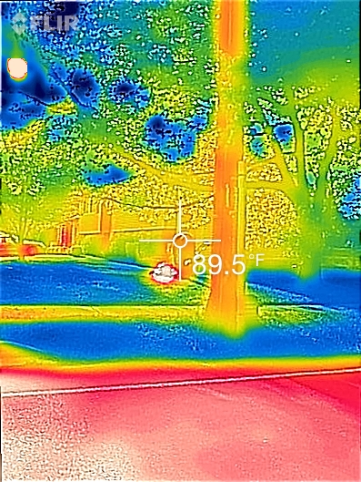

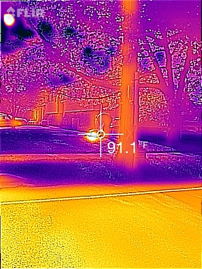

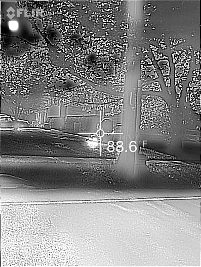

So, for next set of pictures, we have a person with his lawn mower. The first picture is him coming toward the front, and the rest of the series is the man and the lawn mower stationary.
It's not always easy to see the man, who is 15 yards of the point the picture was taken. 75F outside.

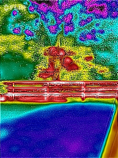

Now we are going to look at a house. The house is behind a wooded fence, and some trees. It's got windows, you can certainly see it very clearly under daylight conditions. (I should have gotten normal pictures with these... but,ahhh, I'm a profession driver that was on a closed track, and the car WAS actually driving itself because it ACTUALLY does drive itself; do not attempt this at home.)

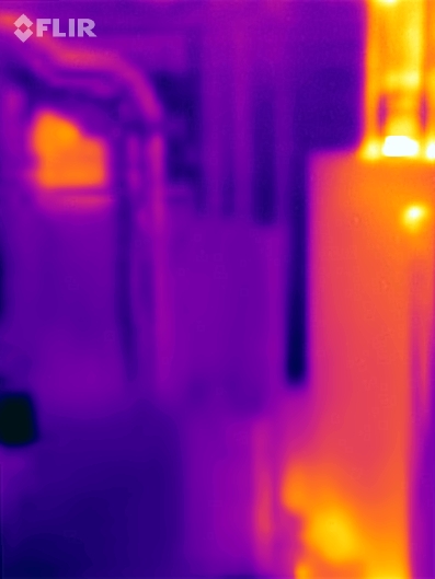

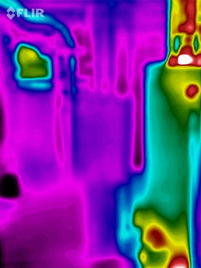

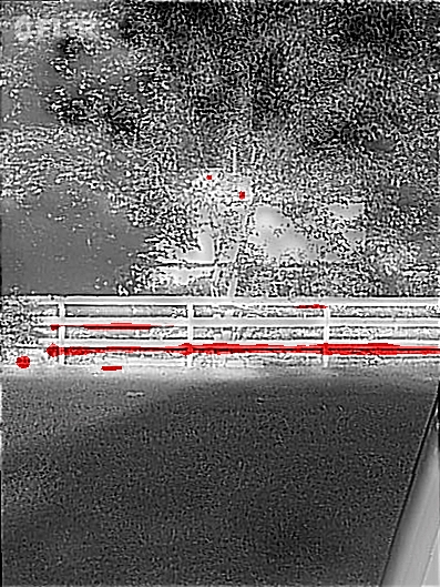

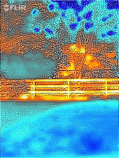

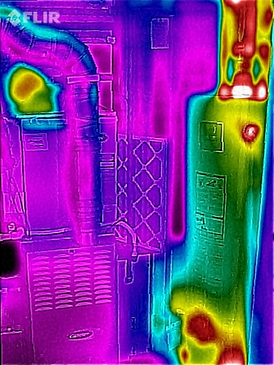

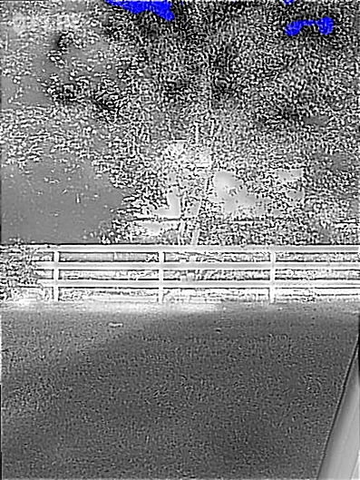

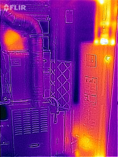

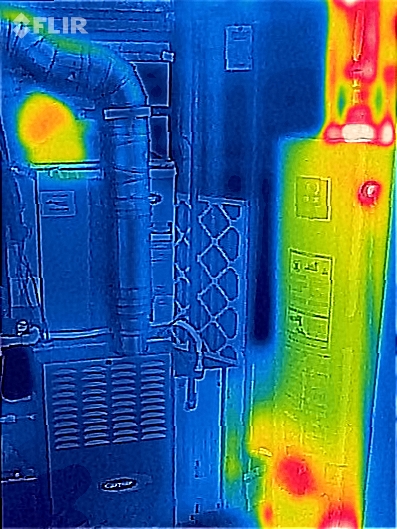

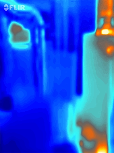

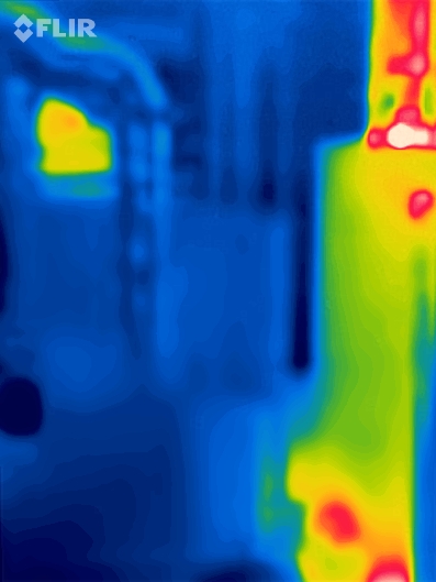

Next set... mechanical room with good hot / cold differentiation...
These are in the total darkness, at 4 meters.

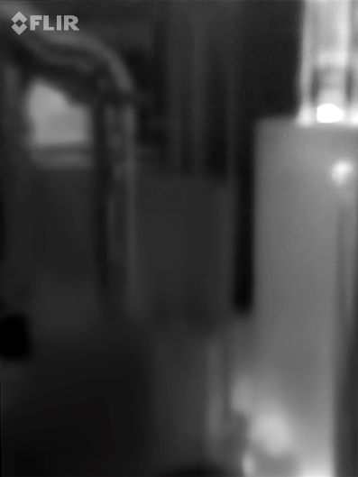

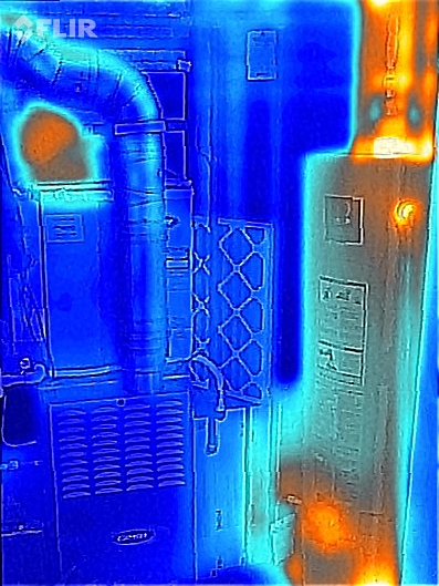

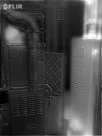

Set two... same as prior message, but with SIGNIFICANT light:
