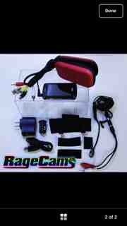

Hello folks! KTMrider here, this is my first post. I just scored this off of eBay for a crazy cheap price. MS 32 in new condition, date of manufacture, July 5, 2011. It works great, I'm having a blast with it. I live in woods and we have tons of critters running around. So thermal is great for seeing those things that go bump in the night here. We regularly have bear visits, they come right up on our second story deck and poke around.
I also plan on using this for scoping and deer tracking while hunting this fall.
I see there is a firmware posted, do you think this will work with my model/year? Do I have to do anything special to update this MS32? I plan on using my Windows 7 PC. I'd like to change the MS 32 red viewing option to the PS 32 type instant alert.
Thanks in advance for any help you FLIR users can suggest.
My unit:

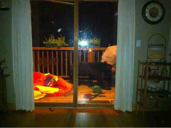

Bear on our deck, notice the nose prints on the left window?

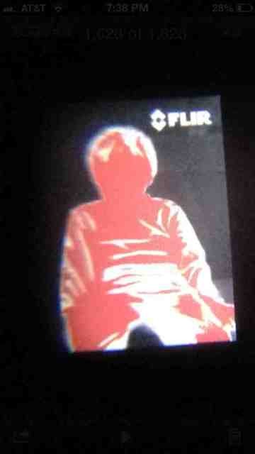

Hey folks! First post, just scored an MS32 NIB for $1526 off of eBay. How hard is it to do the firmware update? I'd like to get rid of the red image mode and update to instant alert. This thing is incredibly cool! I plan on using it for scoping/tracking during deer season and critter watching at night.
Thanks much!
KTMrider
Just downloaded program and changed my all red mode to instant alert, much better! Thank you SkyPup! I still need to update my firmware, I'll search for a new version tonight!
Part of the reason I wanted this unit, we have a lot of Black bears here. They come right up on our second story deck and peer in the windows... I might be making bear rugs this fall!
My sister in law had a hummingbird feeder on the second floor bedroom deck and went out shopping and came back and was unloading groceries when she heard some major sounds upstairs in the bedroom, she opened the door and a bear had climbed up onto the deck to drink the hummers food and trashed her bedroom!
