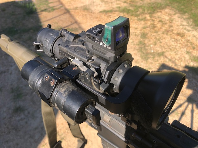

Well here is you some ideas. That is a pimped out PTS 233. I turned that pic rail into a ho. :LOL:
She will run 11.5 hours wide ass open. There is zero wiggle or way the USB C plug can even come out of the 233. The Anchor battery press up beside it firmly to hold it in place and also to protect the USB C port. This is a snag proof setup. Everything else I have seen out there by others will snag the cable. Here is real Redneck Engineering at its finest. :)

Damn! What battery pack and holder is that?
That be a WN&H special battery pack.
Instructions: 10 inch cable is better than the 12 inch (regardless of what the women say :LOL: ) if you can source it. Less cable to wrap so it does not snag. Take some bicycle inner tube and wrap around the part of the Anker battery by the C Port until when mounted it provides good snug pressure up against the C port that goes into the PTS Thermosight. Then wrap whatever portions your want with good electrical tape to lock down any cable to battery. Total cost $35ish. FYI you have to go with that 34/35 mm rings to fit around the Anker Battery.
