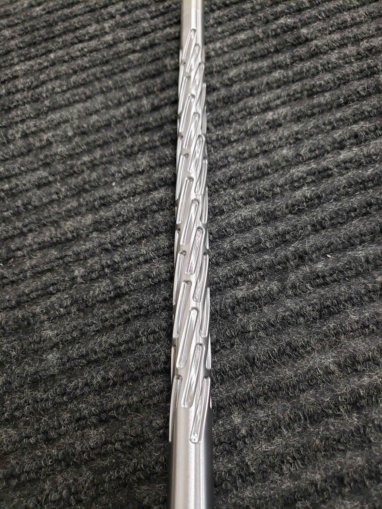

Is there any significant advantage in weight or accuracy with regards to fluting vs. dimpling a rifle barrel? I'm particularly interested in aspects of flex and rigidity as it pertains to these two methods. Any input would be appreciated.

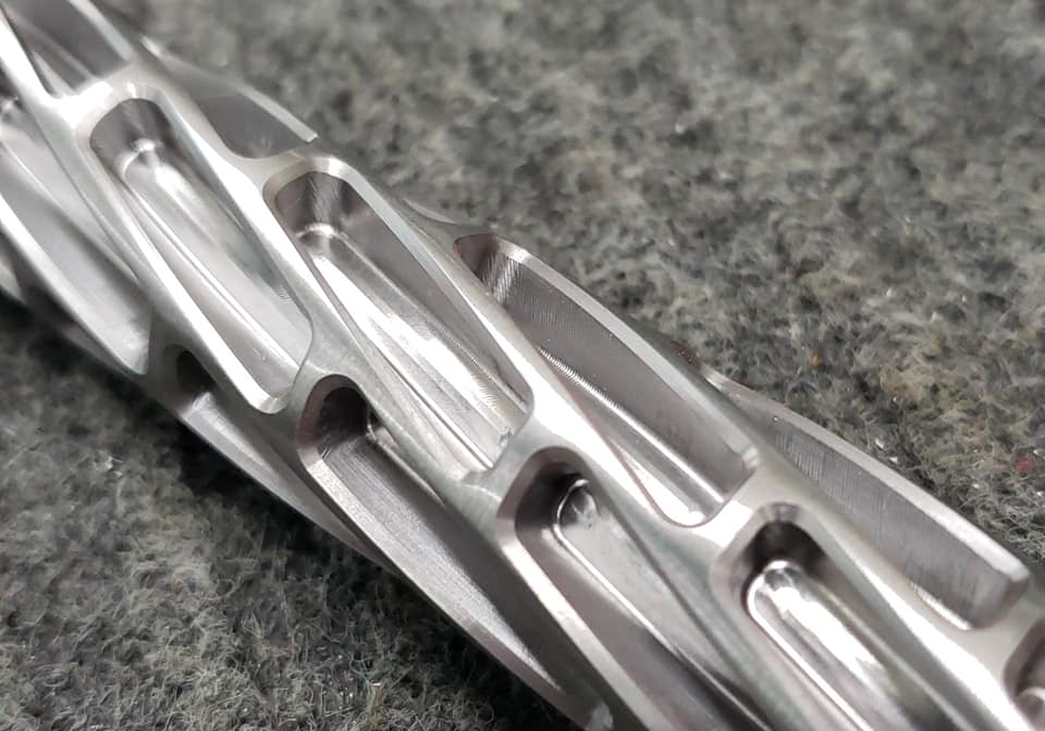

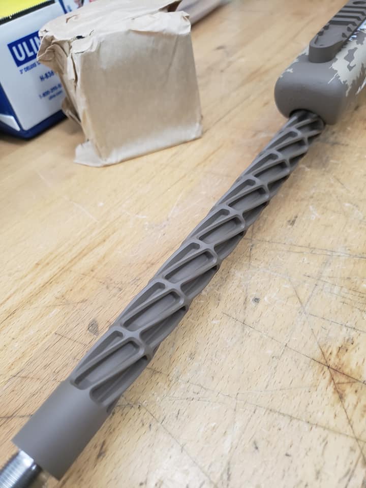

If you want some weight out of a barrel, this works. On a Sendero contour barrel, it beats the weight of a Proof Research in 6.5 caliber. I say 6.5 specifically because it is the only caliber I made any effort to compare to.
As for the big buzzwords that get tossed around topics like this, I cannot offer any conclusive arguments either way. We started this pattern two or so years ago and the response borders on the absurd. I never imagined it would take off like it has.
Thus far, the feedback has been great. No complaints.
The subtle difference in this pattern is that the root of the pocket is truly contoured just as the OD of the barrel. The idea was to make the barrel appear to "grow" something that emulates a chain-link stocking on a really "kinky chick", lol.

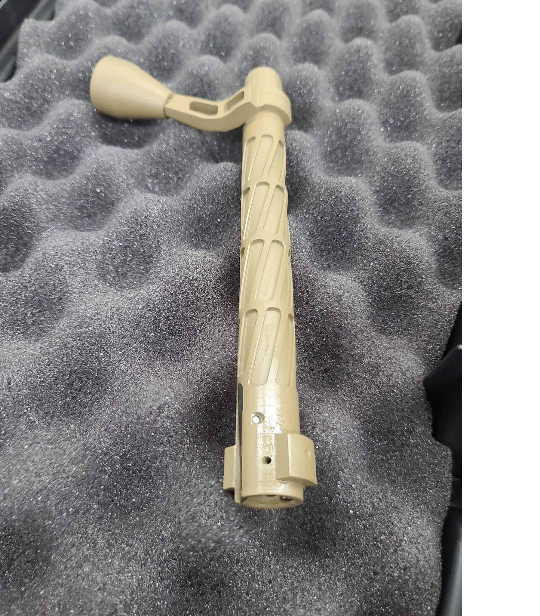

LRI "Pattern X":
Works on bolts too.
LRI "Pattern X":
Works on bolts too.
View attachment 7835779View attachment 7835778
How much for s that treatment on a barrel?
See this link: Pricing is variable as it is relevant to the length of the barrel. So, play around with the drop-down menus.
