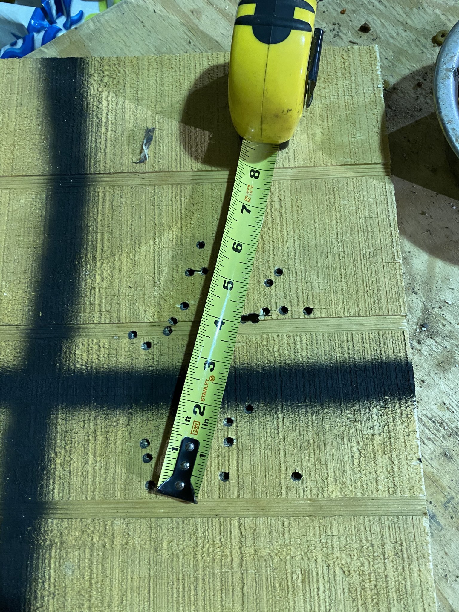

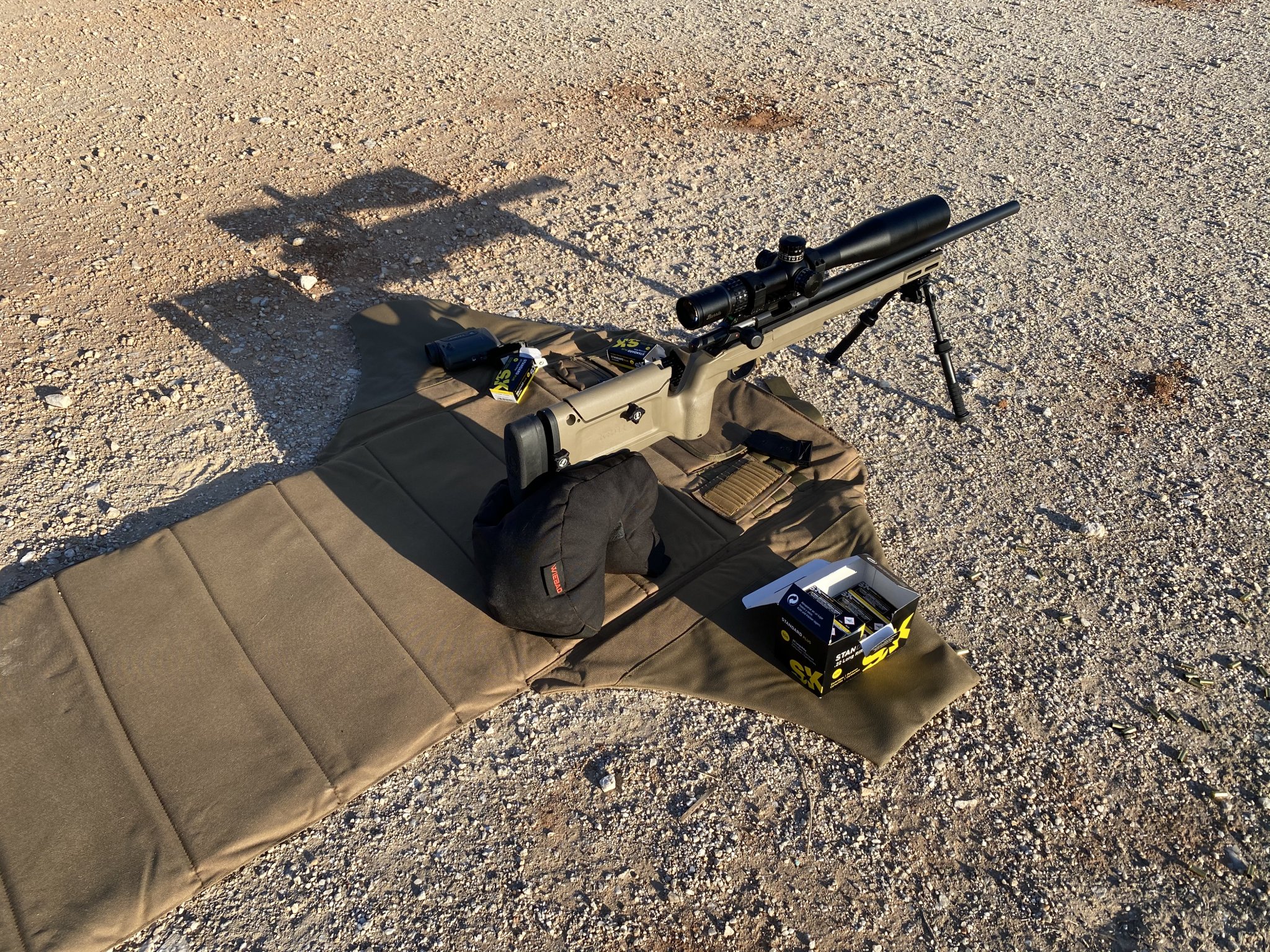

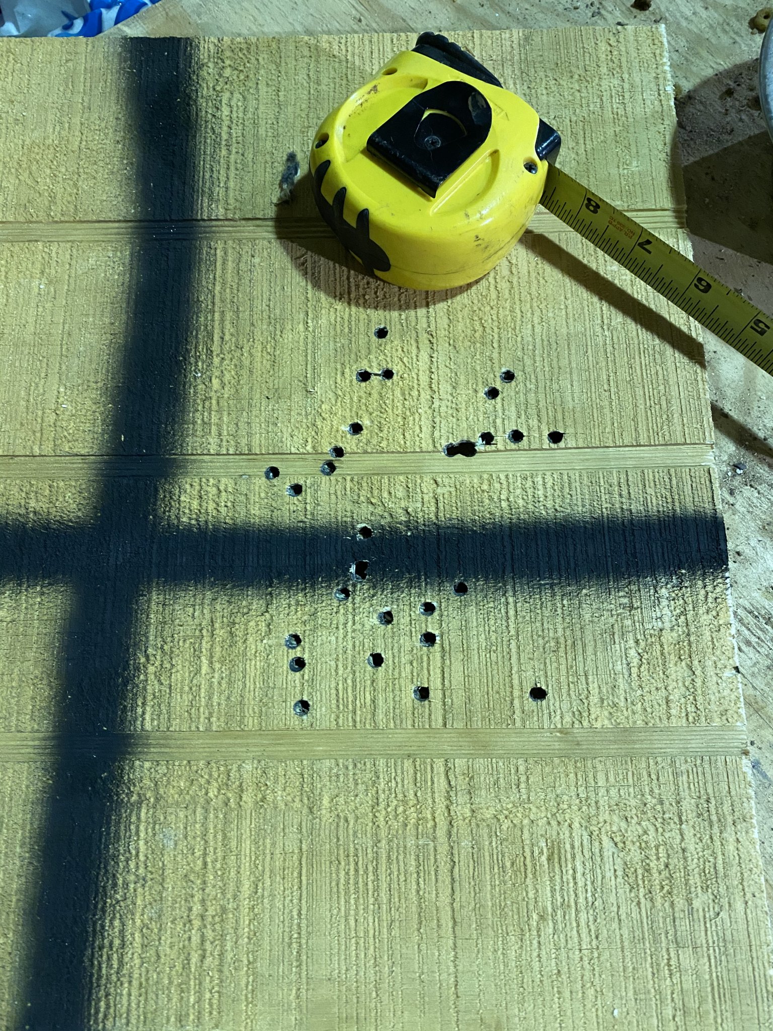

I’ve been playing around with torque settings on my action screws. I shot close to 30 ten shot groups, and all I did was try different action screw torque settings. It was incredible how much just a few inch pounds would make to a group!!! All of my groups were shot prone, and at 80 yards. I wanted to do 100, but the wind was not cooperating. So I shot 80, because I could use a metal building and hay bails as a wind break. I found that 18-20 inch pounds pretty much got rid of all my flyers!! So I put a tiny bit of blue loctite on my action screws, set them to 20 inch pounds, and let it cure over night. This morning I shot it again, and walla, no flyers! Here’s my 5 groups this morning. I shot the top left first. Although the wind was blocked, still needed a little bit of right adjustment. My first group (top left) shows that. I shot the second group (top right) with .1 added for the wind. I shot the 3rd group (bottom left), and added .1 more for wind. Then I shot the bottom right target 4th. The 5th group was my best. I placed a small stick in the target and aimed for it. I shot it out! Just as I was about to call it quits, a big horse fly landed on the box. I smoked him! 😂
The instructions for the bravo say 45 in/lbs. it’s weird that you’re getting the best results at 1/3 of the spec.
what did you start at?
I started at 45 like the instructions say. It shot well honestly. But again, out of 10 shots there just seemed to be one flyer. So went up to 55, and worked my way back down. Here’s a group at 100 yards with the action screws at 45. I was surprised honestly that it liked them so low. I was worried that set that low they’d come loose. That’s the only reason I added loctite. Usually I wouldn’t add loctite to the action screws.

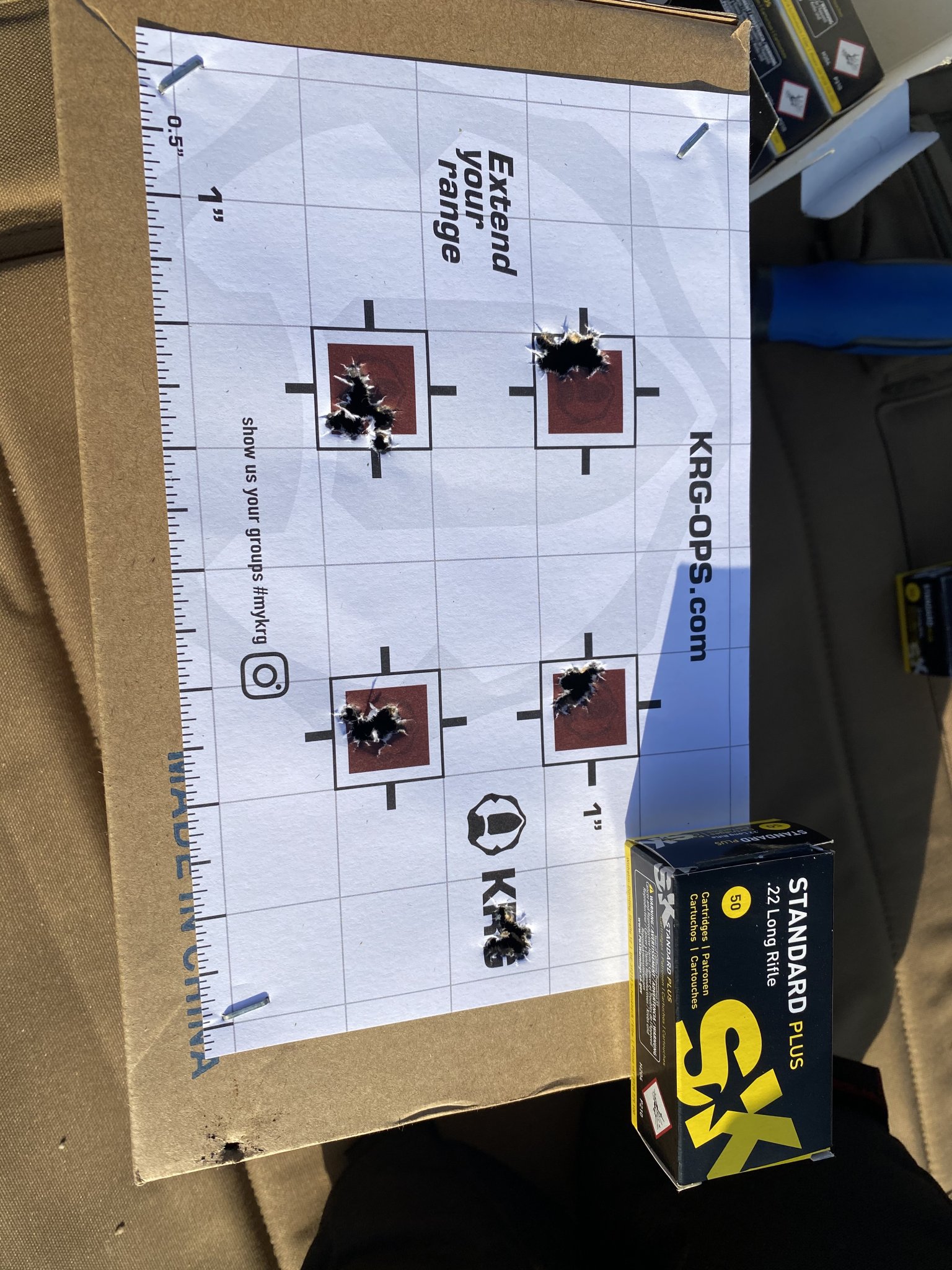

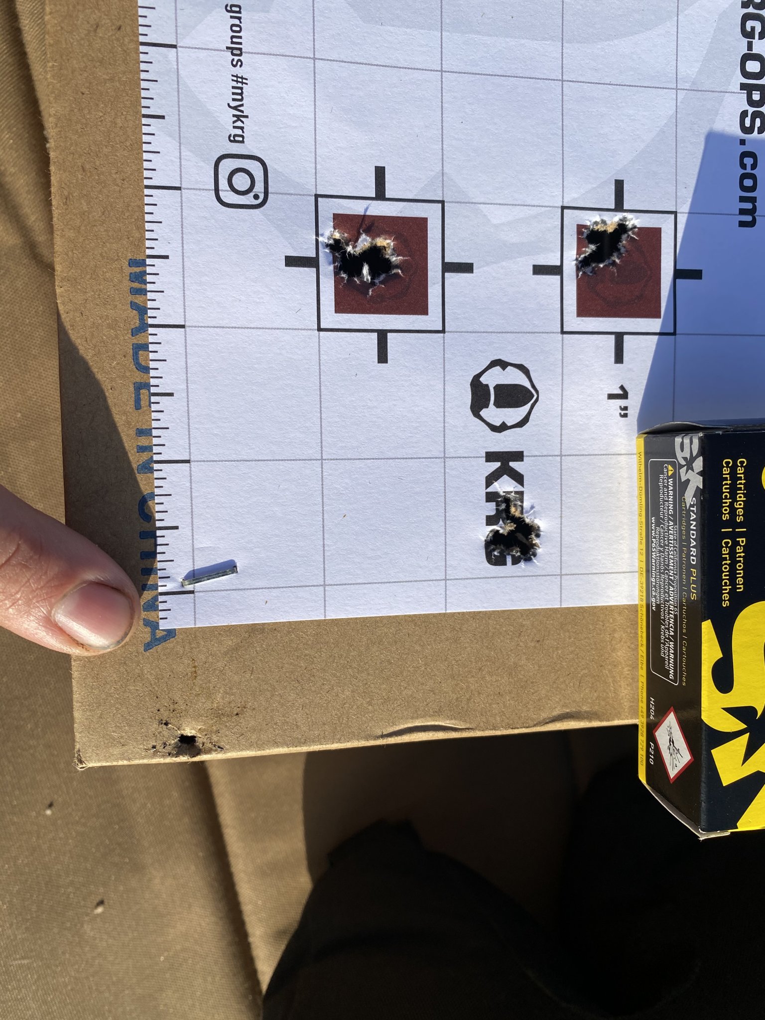

The ammo shown in the pictures, SK Standard Plus, will often produce groups in a variety of sizes. That can make it challenging to accurately assess the impact of action screw torque on results.
Reactions: PowellSixO
Of the ammo I’ve tested it’s one of the more consistent. But I haven’t tried every ammo out there. Right now I’ve got over 10k rounds of it, so I’ll be shooting it for at least several months. I’ve been surprisingly accurate out to 400 yards with it. I can’t dial past 400 at this time, because I run out of adjustment.

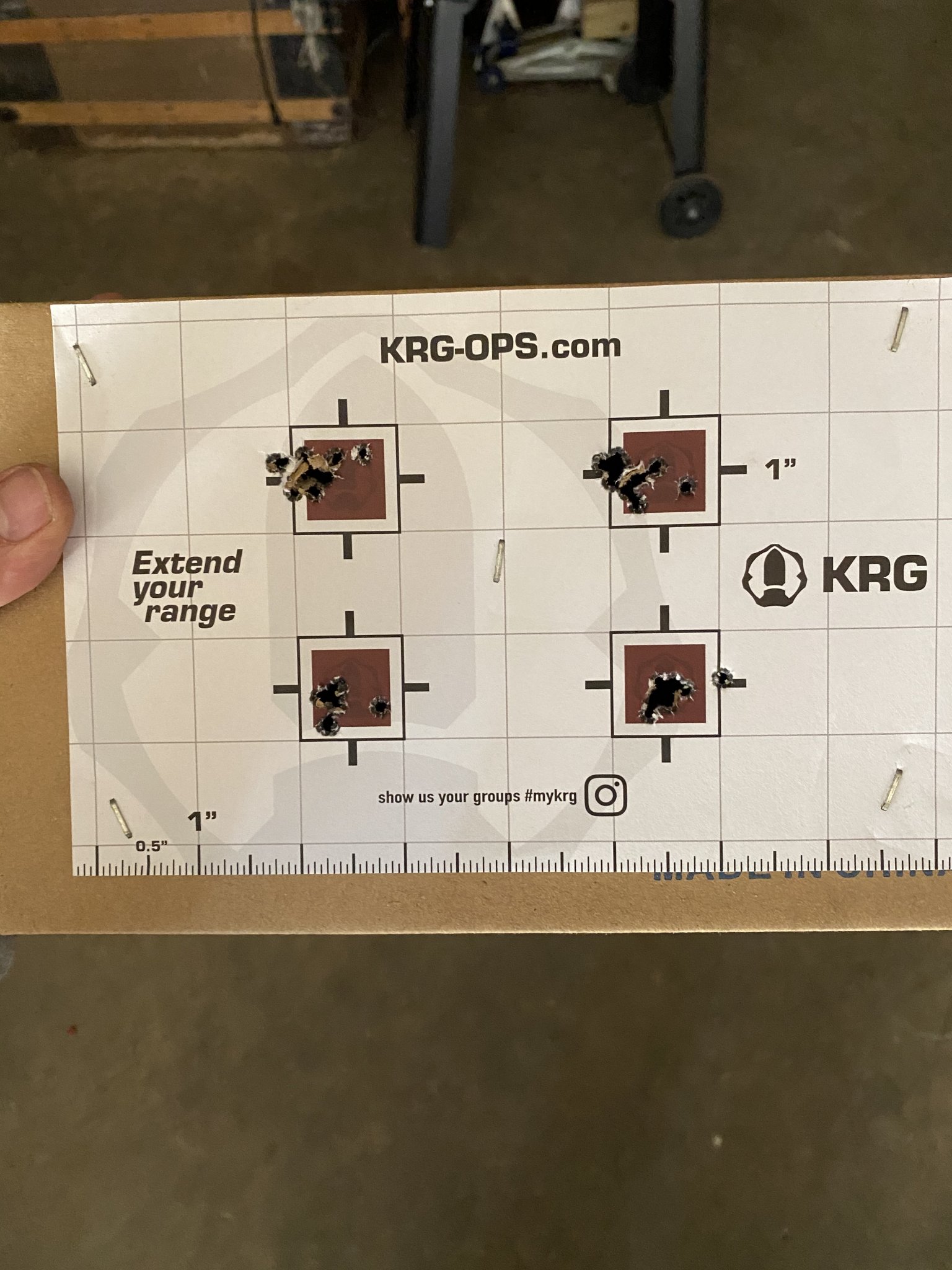

I shot a 30 round group at 305 yards last night. Flyers remain under control. I had a 15 mph right to left cross wind. I put about .5 mil too much in for wind. But a decent little group. A little under 6”. I was rushed, and really just trying to prove my 300 yard dope for a match this weekend.
The ammo gods are smiling on you! I would kill for a group like that.
Conversely, a good lot may be “lights out”
Unfortunately, being what any SK variety of ammo is, which is at best an entry level ammo, those "lights out" lots of SK ammo are very few and far between. For serious shooters, it's good for practice, but I expect it's not often used in top level competition. It can be tough enough to find "lights out" CX or M+. Of course, depending on where the bar is set, it can be plentiful.
