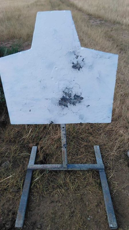

Here is 10 shots at 1K, top splash was first hit, dialed away from it, 8 shots in the cluster, one lower left barely on target, no clue what happened. Target size 24"x24", with 8" being the head. No wind.

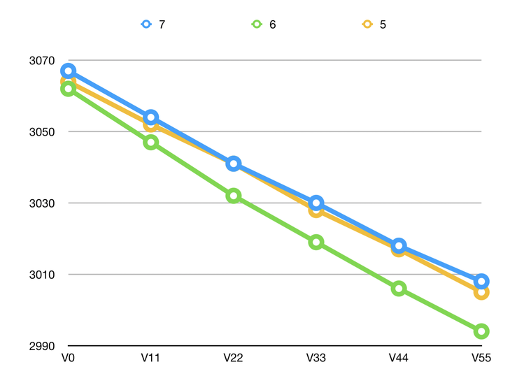

A different bullet might eliminate flyers. I found one bullet that I believe was sensitive to axial error. The plot below show three shots out of a 10 round string. The Es was 10 and SD was 4.2. But shot 6 was a no see at 2200y. After plotting the down range trajectory from the LabRadar it seems shot 6 was a duck. I went out the next week with three different bullets and repeated the exercise. Again the same bullet had 1 out of 10 disappear when it's down range velocity degraded faster than the others. I shot the suspect bullet in the first and fourth strings and both times one out of ten took a dump.
Cheers,
