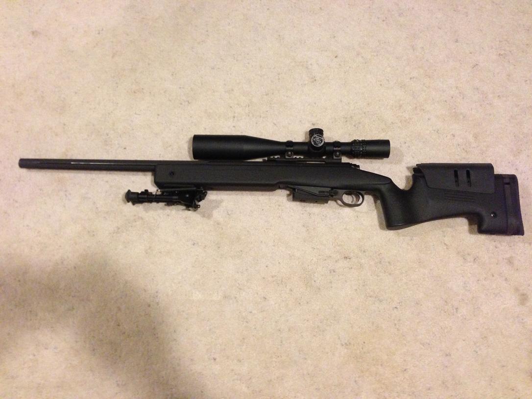

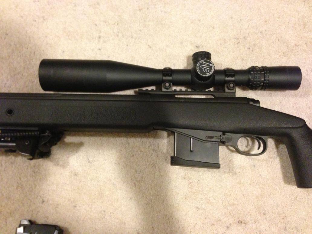

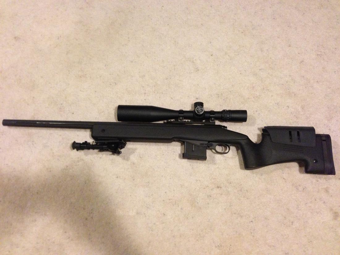

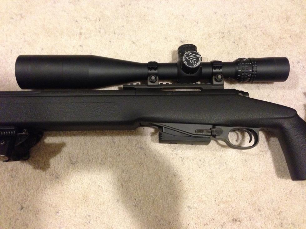

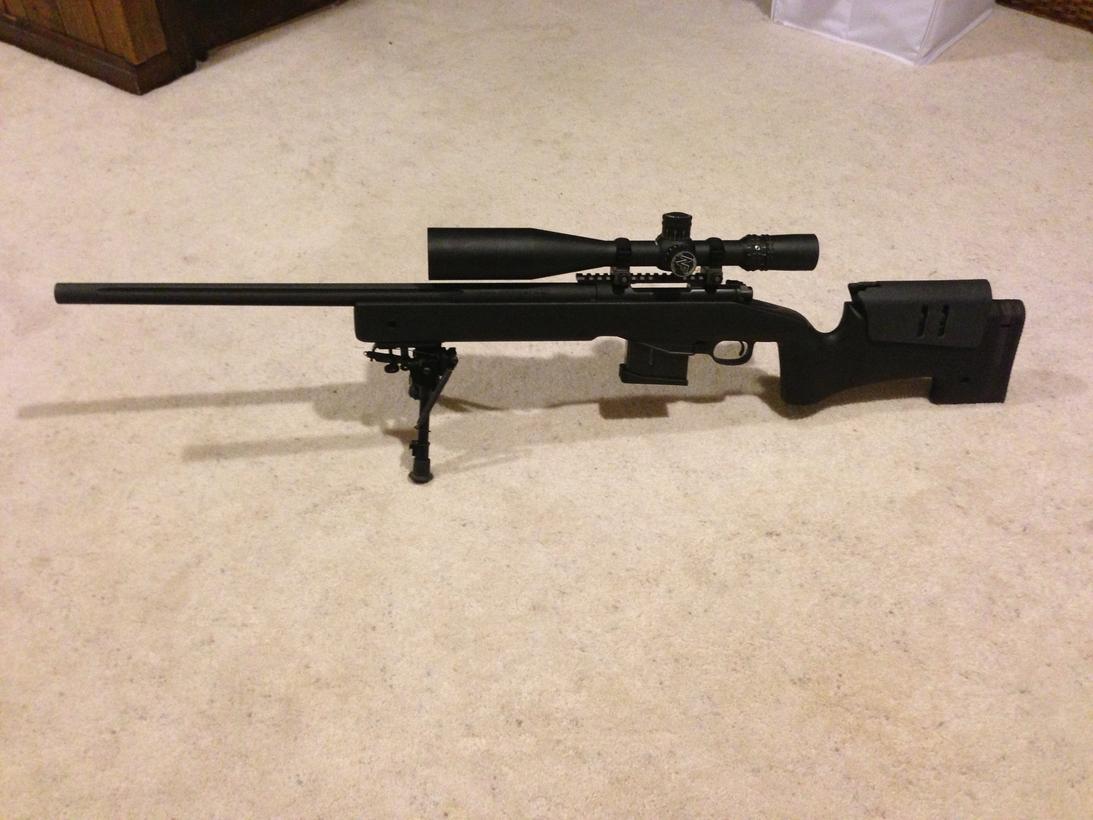

WOW! Took longer to take it out of the packaging then it did to install the TBM! Magazines drop freely and the rounds feed smoothly. Really solid kit and I'm glad I went with the TBM. I'm sure the CDI kit is great as well but not having to worry about cutting on the stock or modifying the action made the TBM an easy choice. It looks better than what I saw in pictures.
Next step is a bolt knob conversion. Any recommendations? I've been searching the forums and it sounds like SAC is the way to go for FN bolt knobs. Thoughts?

Dude do you have pictures of this setup? I just read the thread and it sounds like an awesome setup!

Thanks. That is nice. I'm talking the entire package not just the bottom metal. I really like the magazine release. I think you made a great decision on everything! Rifle, scope, stock all of it.
Thanks! I owe a ton to this site and all the help from you all.
