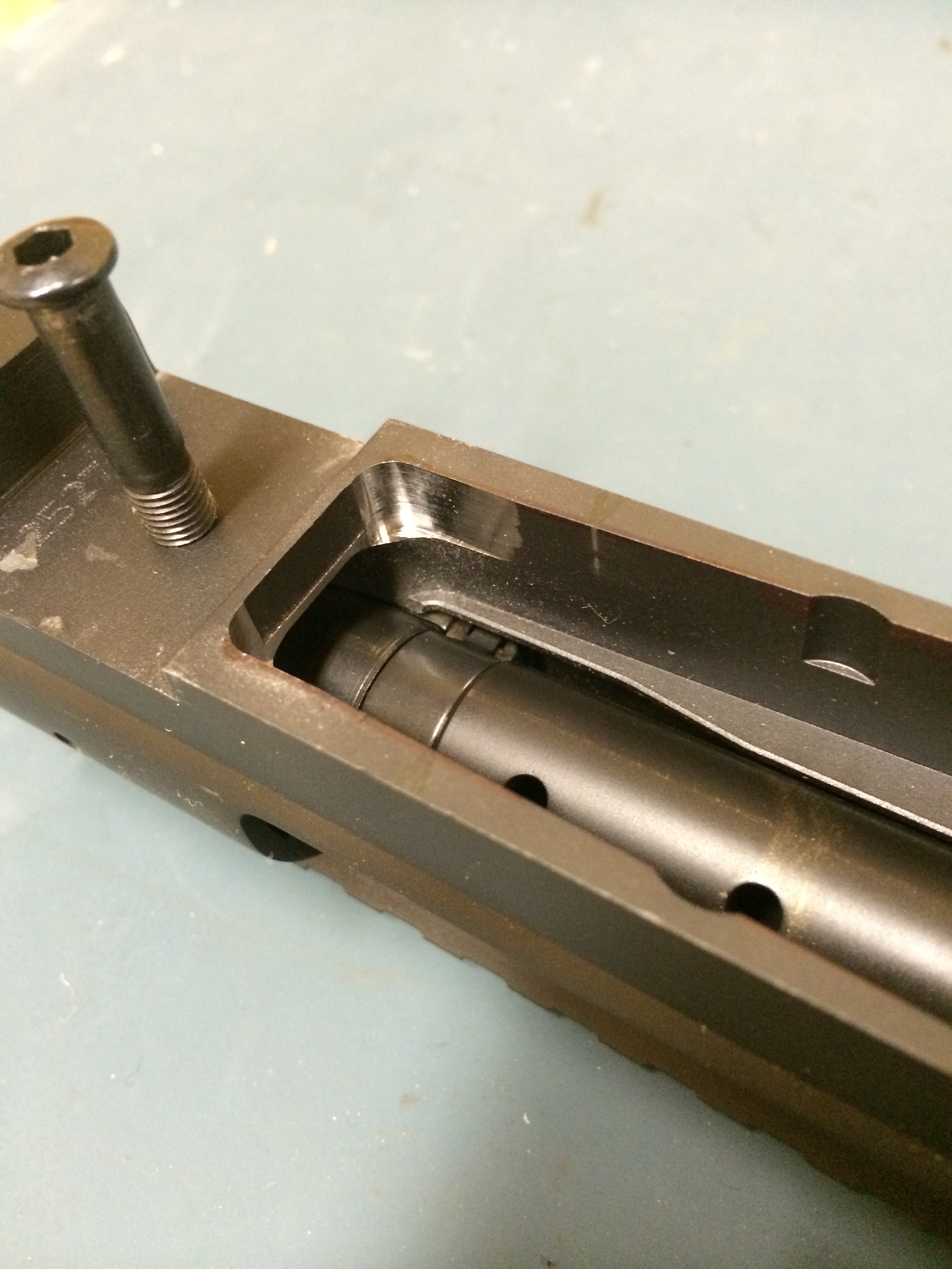

PTG makes two bottom metal for the FN SPR. One takes AE mags and the other takes AICS mags. All dbm for the fn spr that accept AICS mags will require a slight modification to the receiver. I have the AICS pattern dbm on my FN and it works well. Just a heads up though, you may have to replace or modify your ejector. After installing the dbm, when running the bolt forward it would make contact with the ejector and push down on the magazine, tilting it and causing feeding issues. The fix is to either install a magnum ejector or just take a few thousandths of the bottom side.
Here's a couple of images I saved from CDI site when I was looking at having this done. Ended up staying with TBM but from everything I read, the CDI works fine if receiver correctly milled. Don't see why having the stock milled out for TBM wouldn't work either but I'll try to compare w/ standard floor plate tonight.
Can't find the standard hinged floor plate I thought I had but looking at a stock cut for floor plate - inletting for TBM will leave a pretty good gap in the area at rear of floor plate/front of the trigger that would have to be filled. No biggie but means you're not simply going to be able to just remove material and drop the TBM in. MGW still has some good deals on McMillan stocks inlet for floor plate though!
