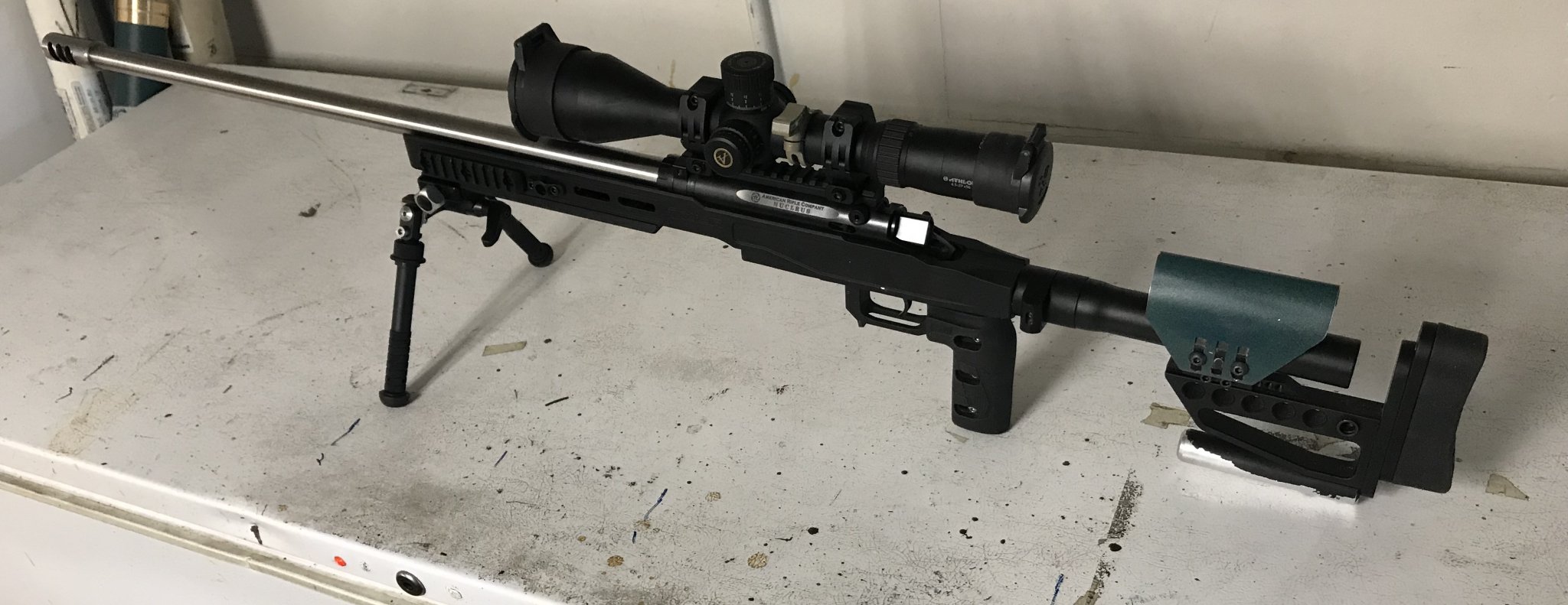

MDT is doing great things at the moment. I really like their vertical grip.
You mean this one?
7108377
It would, just at the current moment the colours would not match and we don't sell the ACC chassis by itself (without buttstock) but all of that is about to change! As well as more colour options.
Awesome!!!! I love the feel of the ACC and the balancing options...
