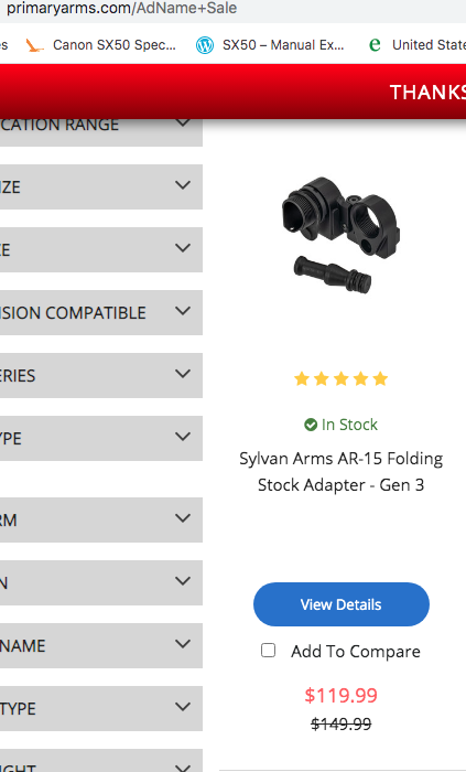

Sylvan Arms unit arrives Monday. Here's the results of the DoubleStar ACE review.

Sylvan Arms unit review is done. Cliff's Notes: Don't use gas-gun FSA's on bolt guns. It sucks.
