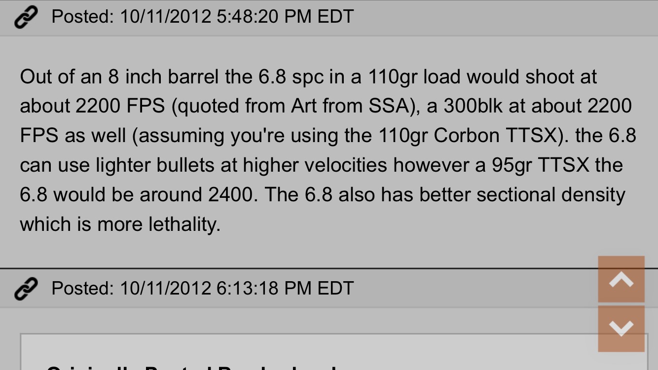

I'm not sure about the Grendle but the 6.8 SPC seems perfect for the Barnes TTSX which is a damn good killer and as said, it will have more velocity unless you're trying to stretch it really far.

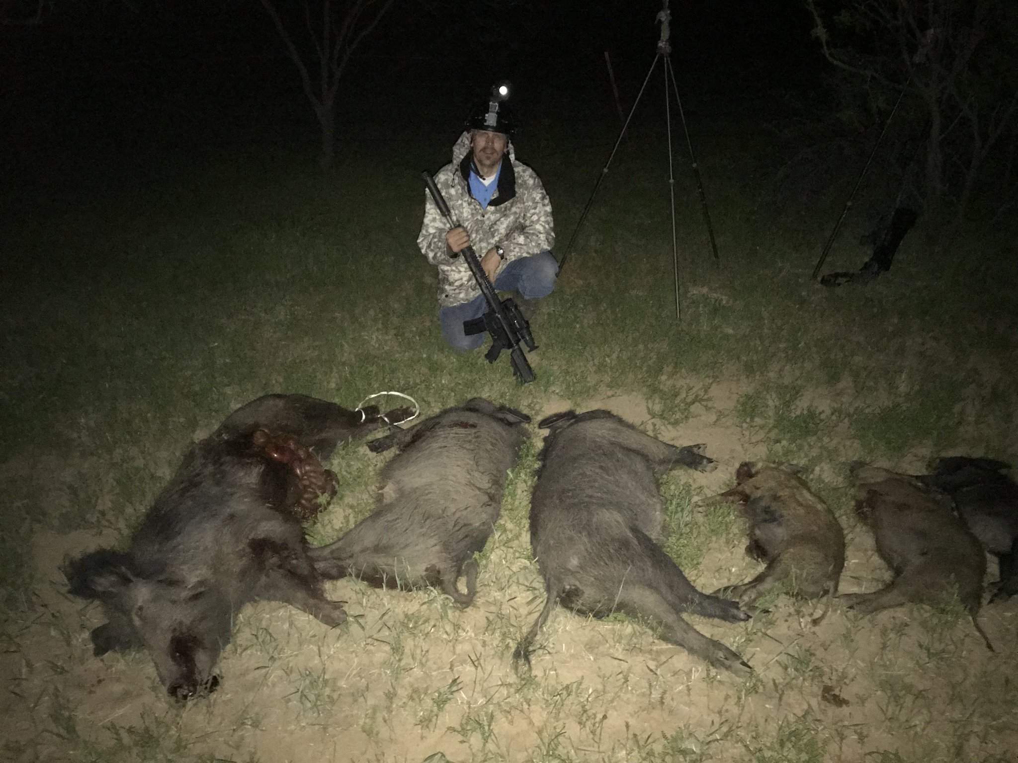

You can’t really go wrong either way. For under 150yd a suppressed SBR setup is ideal. 11” Alexander Arms 6.5G Upper with SiCo Omega is pleasant to shoot and tough on hogs. There is a tangible increase in recoil vs 5.56 which decreases my accurate rate of fire in exchange for more oomph. I like it though.

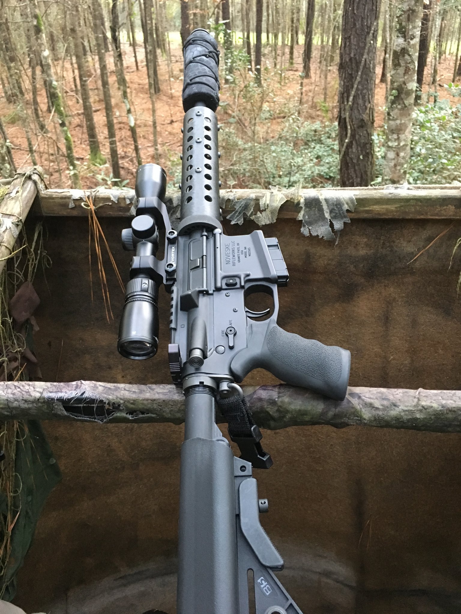

I built a 12" 6.5g and it's working well. Doesn't give up much to a 6.8 up close but gaps it on longer shots.
95% of my hunting is with NV, ir lasers, suppressors and >150yds.
