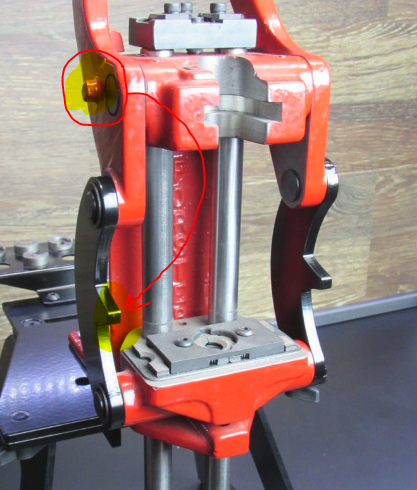

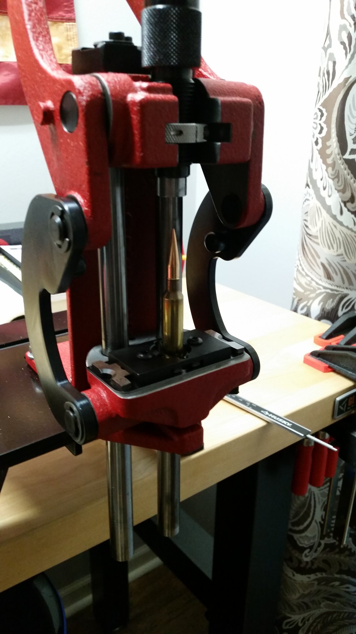

    I have had a CO-AX for around 3 years now and am looking to purchase some upgrades for it.
    Mainly looking at the access side linkages from Inline Fabrication.
    Some of the older photos show that they were like half moon shaped. The new ones show they have a point in the middle of them for some reason. Kinda defeats the purpose of having them imo.
    Anyone know why they put them that way?
    I also looking for a short handle. The stock one is too long and having to move side to side is getting old.
    Right in the description on Inline's website. ?
    Note: Improved design retains use of the factory stops.
    Short handle was a HUGE improvement for me and makes me wonder why it doesn't come with it. I know why it doesn't and it is worth the $25.95 + shipping. ?
    I'd ASSume there's some other options available? A quick Google shows one guy made his own. They were square and the increase in room was quite a bit. I'd be worried about flex though.
    7051272
    7051273
    I still don’t understand the “new” design. The old design used the same side pins.
    Guess it’s beyond my understanding.
    The stops (peg) on the sides of the ram bottom out on the triangular projections on the new links, stopping the press before it might potentially damage the shell holder plate. On the original straight links, that's where the pegs would bottom out. With the half moon links you had to add a stop (allen screw) to keep the press from over-caming as the ram could travel beyond the design limit.
