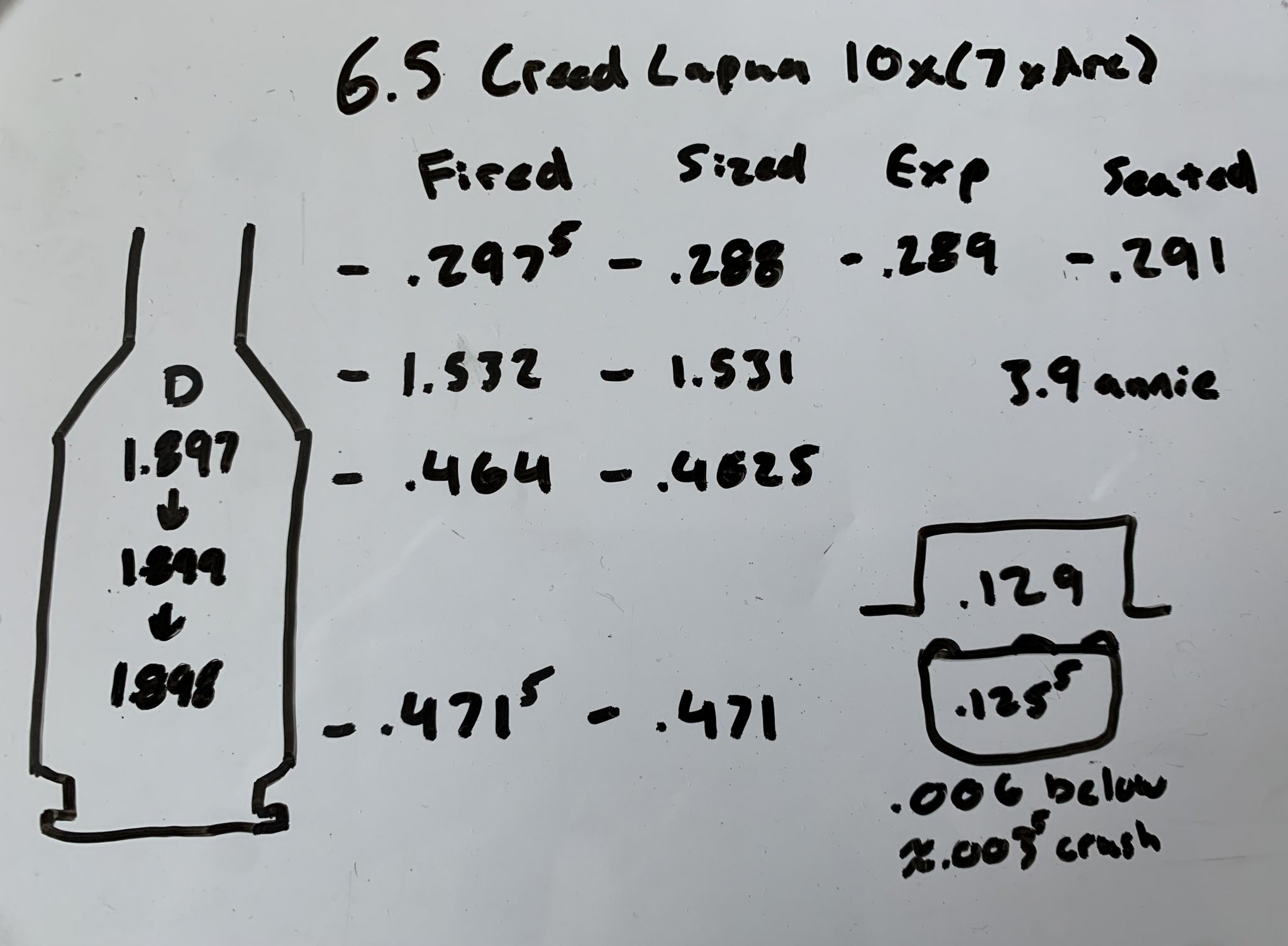

If the bullet = .264, the brass is .012 thick (x2 to account for both sides of the cartridge) = .264+.012+.012=.288" loaded round neck diameter
If the bullet = .264, the brass is .013 thick (x2 to account for both sides of the cartridge) = .264+.013+.013=.290"
You can see that the brass thickness will dictate the diameter of the finished loaded round. In this situation I think that a .286 would be a safe choice for accommodating both neck thicknesses. It would be .002 smaller than your thinnest brass and .004 smaller than the thicker brass, meaning it would provide interference fit in both examples. The .012 thick brass would have the expander ball barely touch and really only work the thicker outliers more, the .013 thick brass would get a healthy .002 of expansion when the expander ball passes back through the mouth opening up its inside diameter to .002 below the bullet diameter.
I dont have a PRC so my case neck thicknesses were examples. measure your components and adjust accordingly. I suspect your magnum brass may be a smidge thicker.
In my creed you can see that if I went .004 smaller than the .297 I would size the neck down to .293. Thats .002 larger than a loaded round, it would never work.
The honed die sizes it down to .288, .011 of case work sizing it down from fired, but that resulting .288 is only .003 smaller than the loaded round diameter. When the expander is run though it gets larger by .001 to a .289 dimension. When I stick a bullet in the mouth it expands to .291 for a loaded round diameter. .
